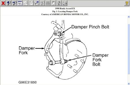

Hi pecrow
FWD AXLE SHAFT
Removal
1. Raise and support vehicle. Remove front wheels. Drain transaxle if removing right or both axle shafts. Draining transaxle is unnecessary if removing left axle shaft only. Spread locking tab on spindle nut and remove nut. Remove damper fork bolt and damper pinch bolt. Remove damper fork.
https://www.2carpros.com/forum/automotive_pictures/192750_DamperFork97Accord_1.jpg
2. Remove lower ball joint cotter pin, and loosen castle nut half length of ball joint threads. Using a ball joint puller, separate ball joint from front hub. Remove ball joint castle nut. Lower control arm and steering knuckle. Pull steering knuckle outward and remove axle shaft from hub assembly. If necessary, use a plastic hammer to drive axle shaft out of hub.
NOTE: DO NOT pull on inner CV joint or disassembly may occur. DO NOT damage seals.
3. Using a large screwdriver, carefully pry inner CV joint and shaft assembly about .5" (12.7 mm) out of transaxle, dislodging retaining ring from its groove at end of drive axle. Grip both sides of inner CV joint and remove axle shaft and CV joint from vehicle.
NOTE: DO NOT attempt to disassemble outer CV joint; it must be replaced as an assembly. On inner CV joint, mark rollers and roller grooves for reassembly reference.
