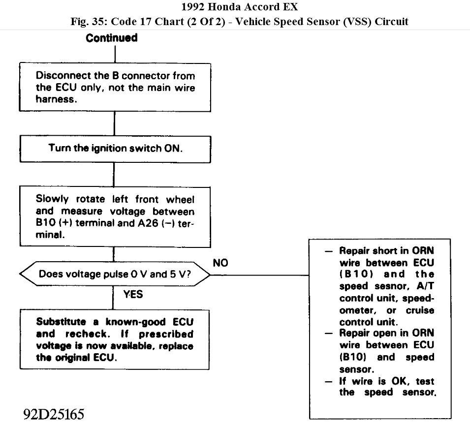

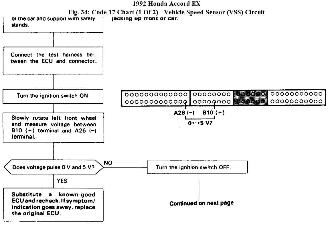

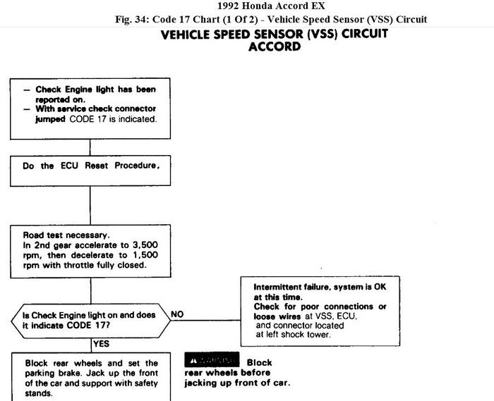

BLUELIGHTNIN6
  • 16,542 POSTS
You will need to use these steps to diagnose the faulty speedometer.
https://www.2carpros.com/forum/automotive_pictures/261618_Noname_648.jpg
