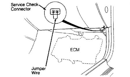

Hi PANTERANEGRA, The VSS wire connector could have been loose and when disconnecting and reconnecting has now been seated properly. You should check the socket for signs of contamination or oxidation. As to the 'S' mode light blinking and trans not shifting correctly, you need to retrieve the Diagnostic Troube Code to enable rectification.
https://images.2carpros.com/forum/automotive_pictures/192750_SCS91Accord_2.jpg
Bridge the connector as shown by the jumper wire and turn ignition switch ON. Cout the number of flashes and come back with the result. Prolonged flashes = 10 Short flashes = 1 Prolonged Pause = DTC separator Shhort

Did you bridge the wire connectors as advised? You need to do it to get the Diagnostic Trouble Code to find out what is causing the problem.

KHLow2008 I did bridge the connector on Sunday but there were no codes????...the S light came on yesterday and of course the transmission got "stuck" on second gear then I stop to pick up something to eat turn off the car and when I got back to drive it the light was off and the transmission worked fine... when I got home tried to get the codes but there is no codes not sure what is happening.

If no codes are stored, then I would suggest bridging the terminals and test driving untill you see the S light flashing and at that time you can start counting the flashes of the S light.
The TCM is located next to the ECM as shown in the previous post and rmoval is not that difficult. I believe you can get it quite cheaply at any of the scrap yards. Of course a new unit would be quite costly.
