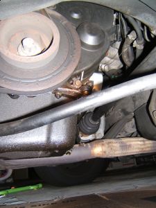

I have a 93 accord wagon, and recently the engine developed a sudden leak out of the driver side of the engine, spurting out at least a quart of oil after I strated it up. This follows some problems with the radiator leaking. Can you give me estimates for probable repairs for this problem?

Hi there,
with out knowing what the oil leak is, I can't give you a rough idea, can you be more specific about this leak?

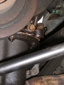

The leak seemed to be somewhere around the seal of the pan or the bolts above it (center of the pictures below).

Hi there,
Wash it down and tighten the sump bolts and see if that stems the leak, let me know how that goes.

I tried to tighten up the bolts on the sump and pan, but the oil was spurting out somewhere higher than I could see, so I had the car towed in to a local mechanic. He gave me some estimates for problems he saw - hopefully you can tell me if these are reasonable.
He said the leak was from under the cover over the timing "auxiliary belt and auxilliary shaft." He said the timing belt was soaked, and it was unclear to me exactly what he said had to be fixed/replaced there, but he may have suggested the timing belt be replaced too.
He also said that the water pump was completely disconnected (this explains the leak in my coolant system) and since they were all in the same place, he could replace the water pump and fix the leak and the timing problems, the whole repair there costing $875 parts and labor.
