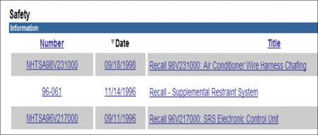

Hey, don’t forget to check the dealer on those recalls…

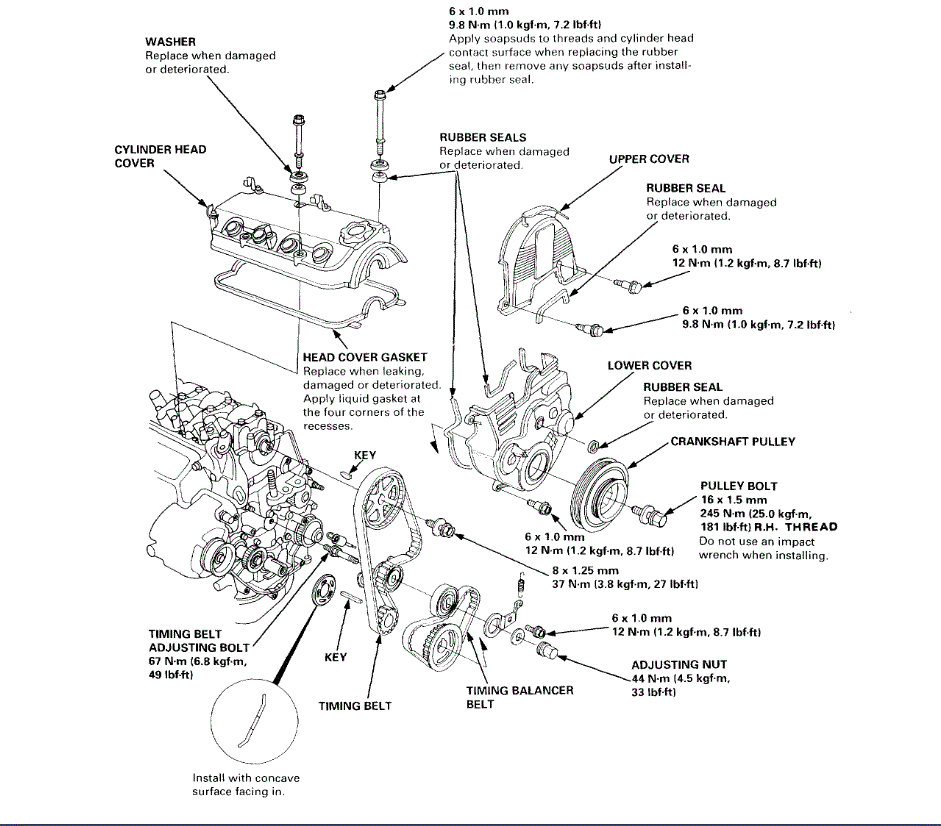

I have replaced the distributor o-ring , both of the vtec solenoid gaskets.
Aug 25, 2020 at 11:48 AM (Merged)
  • CAR REPAIR CONTRIBUTOR
  • 110,193 POSTS
I attached an exploded view of the top end of the engine. See if there is anything you may have missed. I have to ask. Has the valve cover gasket been replaced? Is the leak coming from the top of the engine and running down on the transmission?
