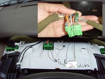

Hi, I tryed to change a bulb on the dash board and I made a short circuit applying voltage to the black wire on the dash board and blew the fuel pump fuse and after that I replace the fuse but now the car doesn't want to start. I checked to see if there was electricity in the fuel pump, fuel injector and spark plugs and there is electricity but the fuel pump does not work. What do you think is the problem?
Do you think it has anything to do with that trigering the alarm or did I damage the fuel pump?

NANDO39
  • 13 POSTS
Hi thanks for the reply. I applied direct voltage from the batt to the fuel pump and it worked, all the fuses are good, and all the ignition ligths comes up when I put the key, and what is the cel?

NANDO39
  • 13 POSTS
HI, yes there is sparks at the plugs and voltage on the fuel pump plug, but fuel pump not work. Fuel pump only work only went I appied direct voltage.
P.S. SORRY, the wire that I aplied direct voltage was not the black wire on the dash boar was a white wire beside the black one behind the dash boar. That make the short circuit. Can I aplied direct + OR - vlotage to the ECU to see if the fuel pump work? Thanks

Here is a pic of the 2 wire that I applied + voltage and I blow the fuel but I replace the fuse but no want to run. white/silver dot and a black/white line. is there a in line fuse that Im missing? I check under the hook driver and pasenger side for fuses,all Ok .
https://www.2carpros.com/forum/automotive_pictures/282543_car_2.jpg
hope you can help me
Friday, November 23rd, 2018 AT 6:52 PM (Merged)

KHLOW2008
  • 41,814 POSTS
Hi nando39,
No, the 50 A fuse is under hood Fuse # 42. Guess that is not the cause as it is the main power supply to the ignition switch.
https://www.2carpros.com/forum/automotive_pictures/192750_FuseBox98Accord4cylHood_1.jpg
From the connector can you please tell me the pin # location. I seem to have different wire colors for my diagrams.
https://www.2carpros.com/forum/automotive_pictures/192750_MeterConnector98Accord_1.jpg
I will do some research and see if I can pinpoint the cause.
Ok, I now understand which 2 wires you are refering to.
1. A10 = interior light circuit
2. C4 = Reverse light going to the gear shift.
From the circuit, there should be no connection to the fuse. From where did you tap the battery voltage to initially blow the fuse? What is the fuse location that blows initially?
