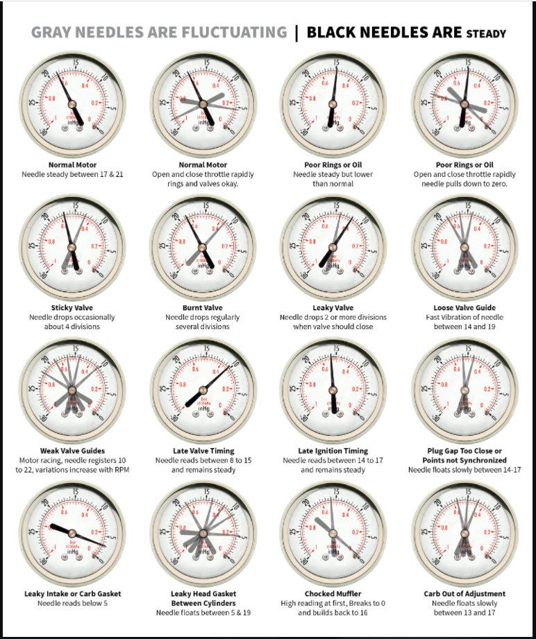

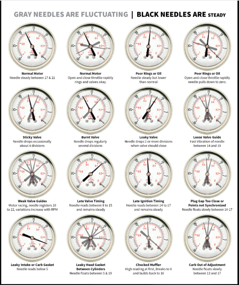

If it does then we need to move onto putting a vacuum gauge on the engine to make sure there is not an intake valve hanging open.
Please see the chart below for this info on possible gauge reading issues.
Please run through this info and let us know what you find with this.
