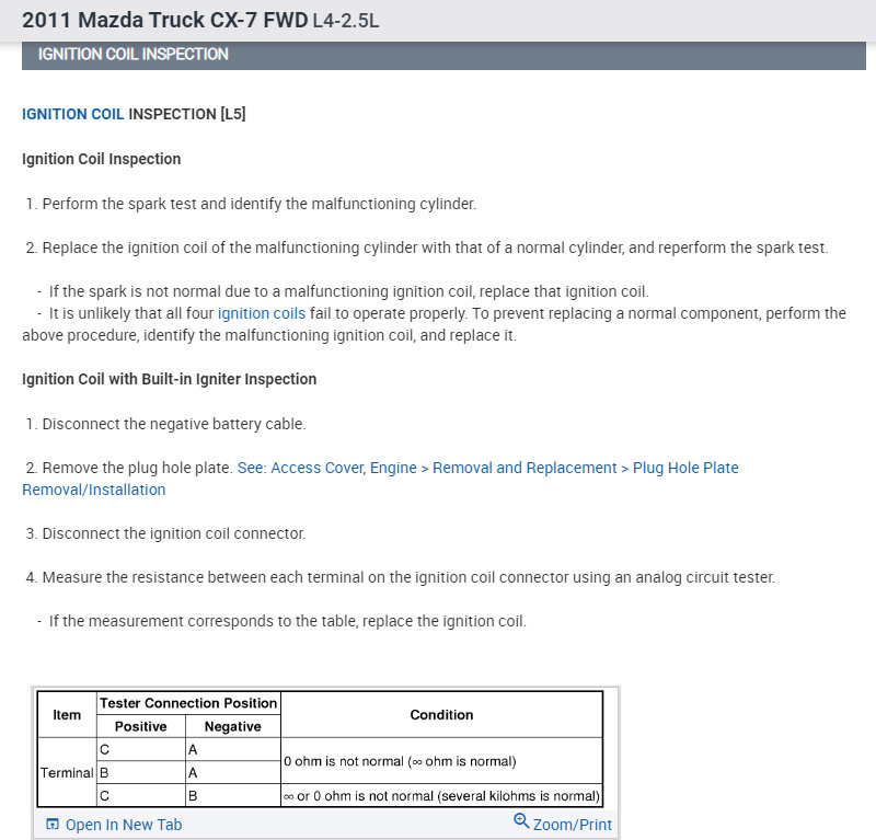

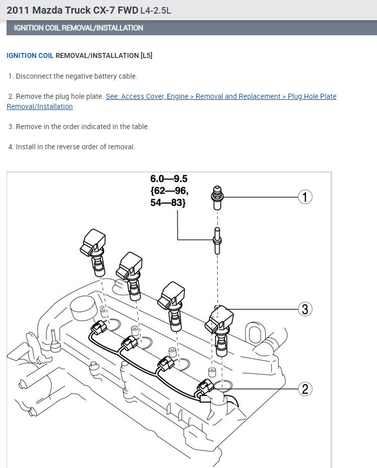

So when turning car on to try and start. The check engine light comes on solid then blinks 6-7 times. Looked up cause online. Days cylinder misfire. Think I need to change coil packs? Two of them were soaked in oil.
Saturday, January 15th, 2022 AT 8:03 AM
SQM
  • 6,383 POSTS
Did you retrieve the actual code? Like which code number?

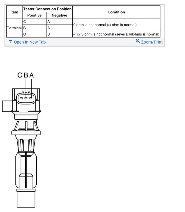

Oil-soaked coil pack typically does not function properly. However, if the oil is only on the outside, it might just need to be cleaned and dried out.
I have attached the ignition coil test procedure below for your reference.
Saturday, January 15th, 2022 AT 10:18 AM
STEVEN1984
  • 29 POSTS
P061B, p0113, p0102, and the po117. Are the codes it tells me? Even after changing part!
Well, they were soaked in oil (two of them) took apart and cleaned let dry.
Saturday, January 15th, 2022 AT 10:21 AM
SQM
  • 6,383 POSTS
I wonder if there is a wiring issue with this vehicle. As these codes can also indicate faulty PCM.
If you are able to test the coils after they dry with a multimeter. That way you will know that the coils are/are not the problem.
Have you got a chance to check those trouble shooting steps?
Let me know the outcome after the coil gets installed.
