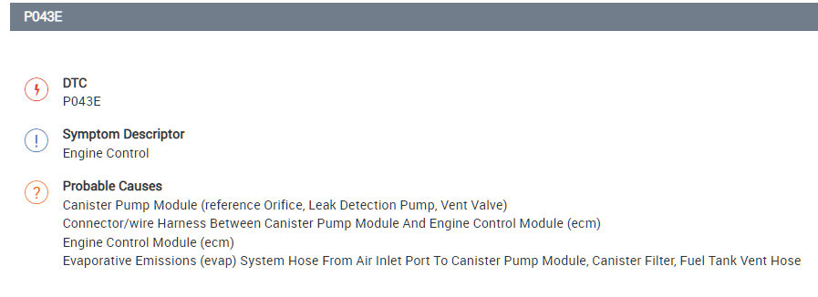

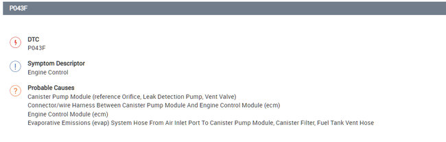

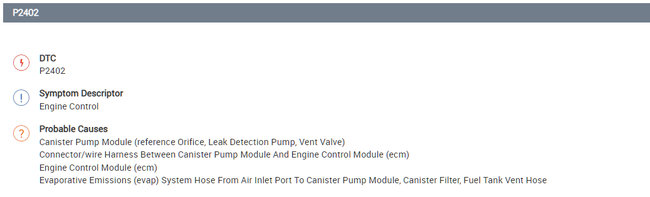

Codes P043E, P043F, P2401, P2402 and P2419

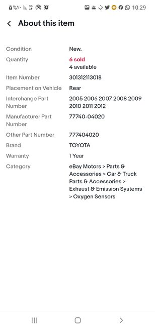

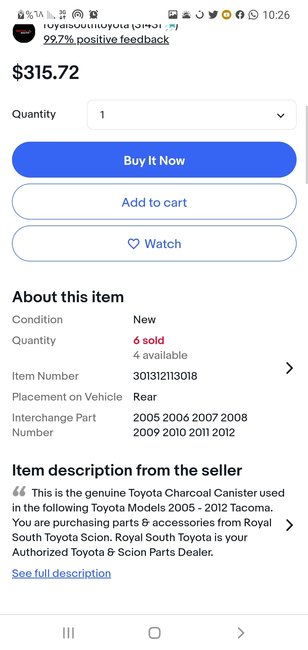

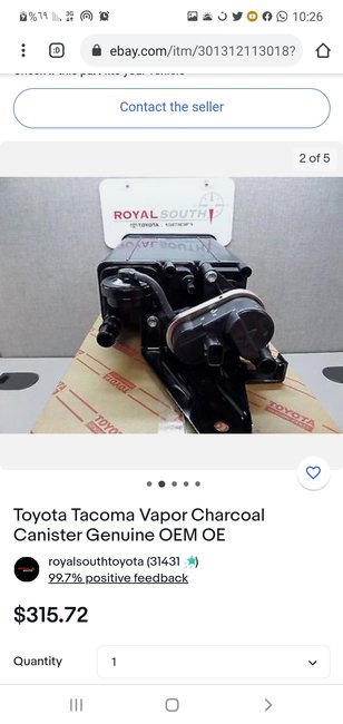

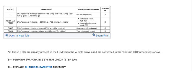

If I had thought about buying a special evaporative system for a 2012 Tacoma, it is exactly the same as the one in the Rav4. What's your opinion?
The Evap system for the Rav4 vehicle costs $ 700.00.
A Tacoma costs $300.00.
https://www.ebay.com/itm/301312113018?_ul=YE
Sunday, June 26th, 2022 AT 12:40 PM
AL514
  • 5,590 POSTS

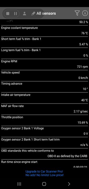

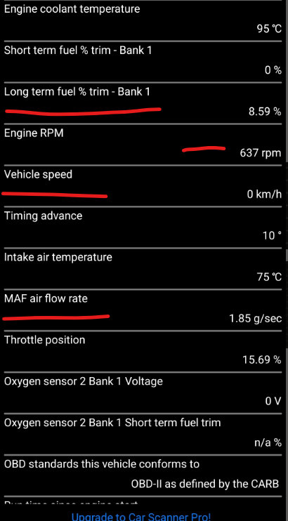

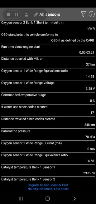

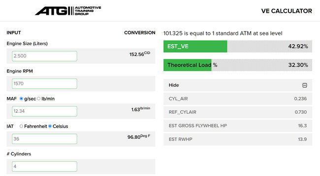

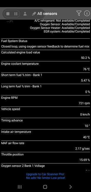

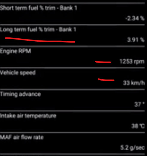

No, that won't work, they are different part numbers. There may be differences in fuel tank size and canister size. The two vehicles have different size engines. But are you sure you don't want to have a shop take a look at the system, you had a vent valve you said was stuck closed and you got it freed up, but the computer is still setting codes for it? Plus, the live data while at Idle and driving indicates other problems with engine. The almost %10 positive Fuel Trim at idle points to a vacuum air leak because the Fuel Trim starts getting better with throttle open (driving). Plus, the Mass Air Flow sensor is not reading correctly, 1.8 grams per second at idle is too low. Thats a sensor under reporting air flow.
I think you're going to replace this really expensive evap assembly just to find there are other problems. Below is from your last live data post and points possible vacuum leaks, or sensors giving incorrect readings, The VE test shows definite issues.
I really think its in your best interest to have a shop take a look at the vehicle and go through and check everything. The live data is getting worse every time you post new scan data. It's better to get it all fixed at once, so other components don't fail prematurely.

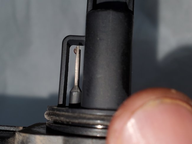

I couldn't find the cleaner for the mass air sensor. Is it possible to use a substitute for it like the one in the pictures?
Saturday, July 2nd, 2022 AT 12:20 PM
AL514
  • 5,590 POSTS
No, absolutely not. It has to be Mass Air Flow cleaner, The sensor has very sensitive small resistors that have a layer of clear coat on them to protect the resistors. You'll damage the coating on the resistors. You may have damaged the Vent valve with the carpet cleaner you sprayed into that as well. those valves aren't supposed to have anything spray into them, take the Air Filter box top off and look at the Mass Air Flow sensor, you'll see its a very small hot wire sensor. Also take off the Air Intake Boot that goes to the throttle body and see if the throttle plates have carbon build up on them. I think this vehicle has multiple problems, and Im assuming you live in an area where there may not be many automotive shops. Its difficult to give advice when you dont have access to the proper cleaning material and tools. If you noticed on your scan tool live data, there was a data PID listed Long Term Fuel Trim and it was about %10 positive. and sometimes it was even higher. Thats the number we need to get lowered. That number is what the engine computer is doing with fuel management. 10% is the absolute max I would allow, even then personally I think its too much. An engine that is running good would have Fuel Trim numbers around 2 to 3%.. At 10% the engine computer is adding alot of fuel to the air fuel mixture to compensate for extra air its monitoring entering the engine. I noticed it seemed to be higher at Idle when the vehicle wasnt moving. Since your vehicle has a mass air flow sensor, that means that the air entering the engine is not being read by that sensor. If it was the Fuel Trim numbers wouldnt be so high. So there is air getting in from some other place. Possibly threw the Evap system since you have 4 or 5 codes for that particular system. To get your fuel mileage up, that Fuel trim number needs to come down,
You can try blocking off the Purge valve line very temporarily and watch to see if those Fuel Trim numbers come down. Then you will know if thats where the additional unmetered air is coming from.
But as for cleaning the mass air flow sensor, Im adding below a couple of videos from our Youtube site for 2CarPros, it will give you a better idea of how to clean the mass air flow sensor and the throttle body. So start there and see if it helps, just remember the Long Term Fuel Trim is the number to watch. You want it as close to zero as you can get it,..

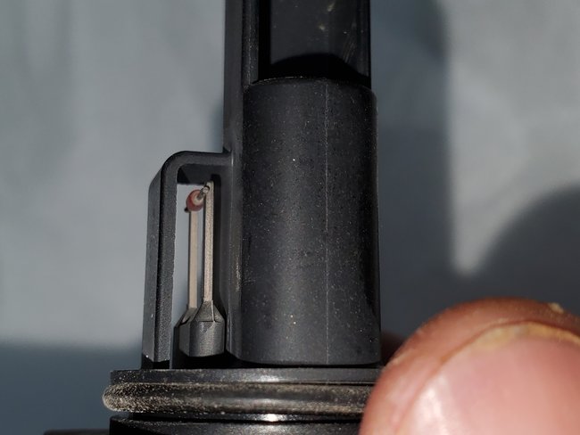

Is it possible to use this cleaner.
Wednesday, July 6th, 2022 AT 6:56 AM
AL514
  • 5,590 POSTS
Yes, that's Mass Air Flow sensor cleaner, see if it's possible to look into the sensor and see the resistors on the wire. Some sensors you can and some you can't. They are small so you might need magnifying glass to see how dirty they are, but by the look of the Evap canister it looks like you live in a dusty area. Since you have a scanner that can read live data, take a look at the Mass Air Flow g/s (grams per second) before and after the cleaning, to see if it made a difference. But it was reading 1.8 g/s at idle in one of your posts, it should have been above 2 g/s at least at idle.

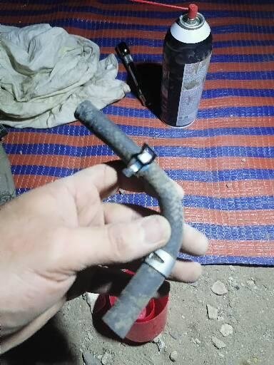

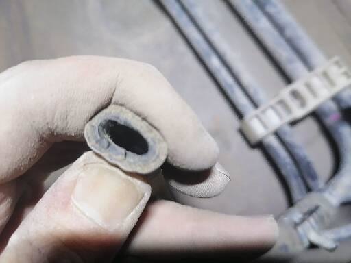

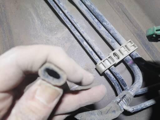

What about this canister pipe? May it cause the evap fault?
Wednesday, July 6th, 2022 AT 12:23 PM
AL514
  • 5,590 POSTS

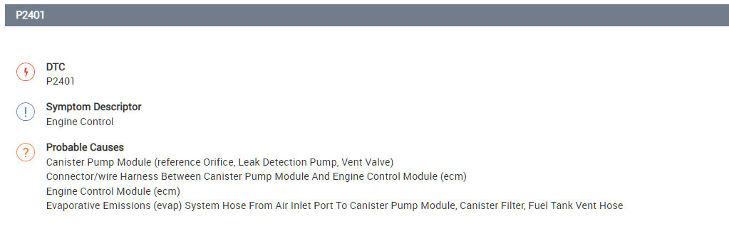

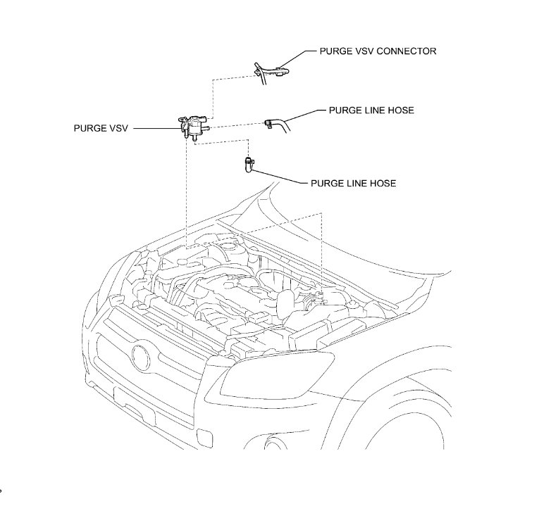

You're still getting all of these, P043F, P043E, P2401, P2419? I doubt it's one hose causing all these codes.
Check the Purge Valve, see if there's any signs of liquid gasoline in it (pic 2). It's in the engine compartment.
Wednesday, July 6th, 2022 AT 12:34 PM

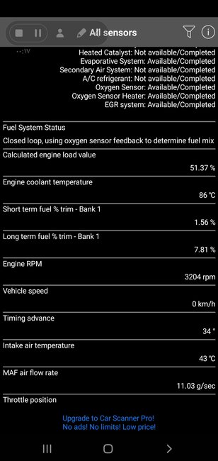

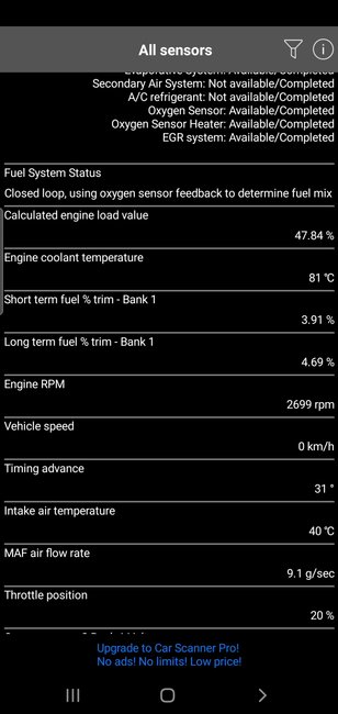

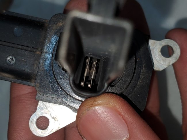

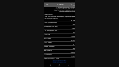

Today before cleaning.
Thursday, July 7th, 2022 AT 12:18 PM

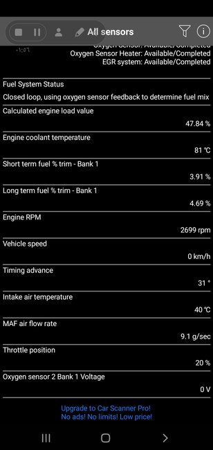

NADHEER
  • 132 POSTS

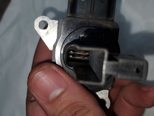

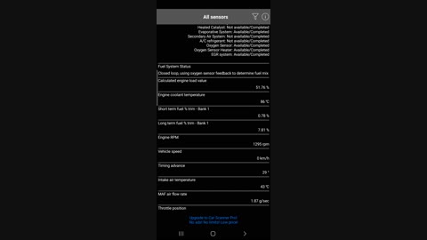

After I have cleaned the mass air sensor.
Thursday, July 7th, 2022 AT 12:24 PM
NADHEER
  • 132 POSTS

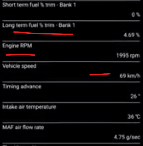

I forgot to scan the live data as you said before cleaning the sensor.
Thursday, July 7th, 2022 AT 12:25 PM
NADHEER
  • 132 POSTS
Thursday, July 7th, 2022 AT 12:36 PM
AL514
  • 5,590 POSTS
Okay, the Mass Air Flow pictures show that the sensor looked very dirty and the Long-Term Fuel Trim Numbers improved a little bit, did you inspect the Purge valve under the hood, it should normally be closed if the engine is off. And you unplug its electrical connector. I still think you have an air leak somewhere; the Fuel Trim went from 10% to around 7% which is an improvement but could still be better. Also are the Evap codes still Active?

The Purge valve is normally closed.

Yes, but were there any signs of liquid gasoline in the valve or in the lines coming to the valve? Also, if you block off the Purge valve hose that goes to the Intake manifold, does the Fuel Trim Number come down when the vehicle is idling in Park?

2,000 RPMs - 4,000 RPMs.
Sunday, July 31st, 2022 AT 10:17 AM
