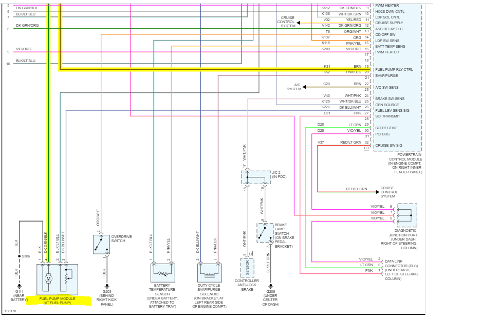

Truck stalled out and would start multiple times pulled and replaced fuel relay and checked all others still intermittent start no start. So, I was thinking sending the unit in fuel pump, replaced it and the harness because someone broke the clip that plugs into the pump. No power to pump fuel relay, never clicks and is new. Checked all fuses and relays, no issues. Checked fuel relay pins, have power on 3 pins but not on pin 85. Jumped relay to check pump still no power at pump. Getting frustrated with it thinking the TIPM or computer bad. Need help and also wondering if the CarQuest fuel pump could be wired differently than original pump.

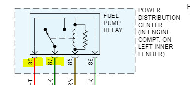

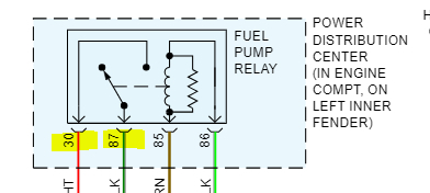

Did you jump pins 30 and 87 at the fuel pump relay? Those are the ones to power the pump. Also, pin 85 is a ground part via the PCM. So, it shouldn't have power. However, it should provide a ground when the key is turned and in the run position. Have you checked for that?
Next, if you checked for power with the relay removed, you should only have power to pins 30 and 86. Is that the case? Note: Pin 30 should have battery voltage at all times. Pin 86 only has power when the key is in the run or start position.
Take a look at this link, you may find it helpful:
See pic below.

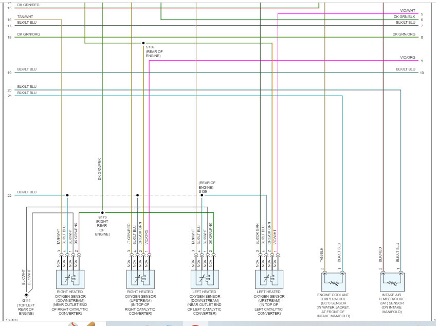

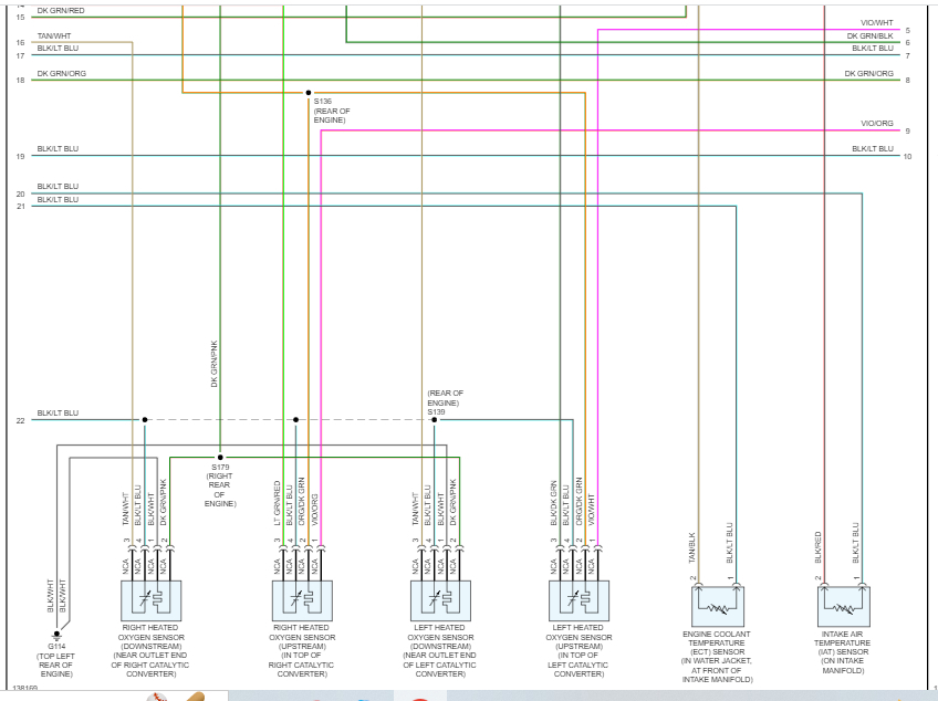

  • 110,194 POSTS

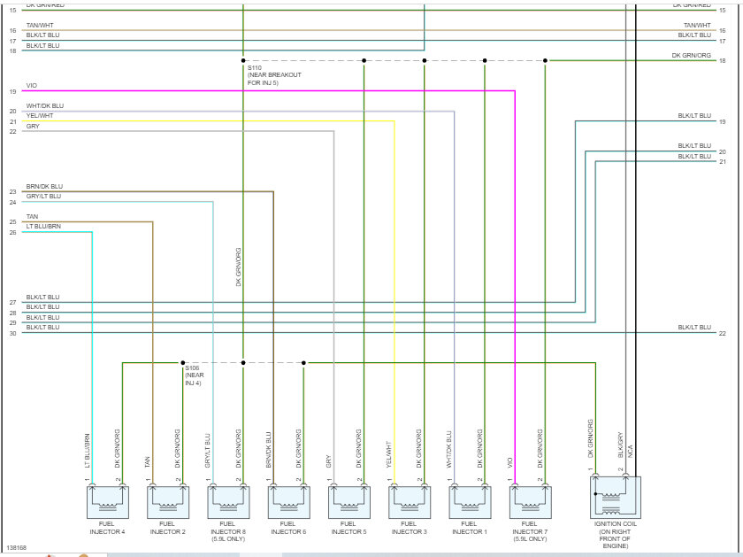

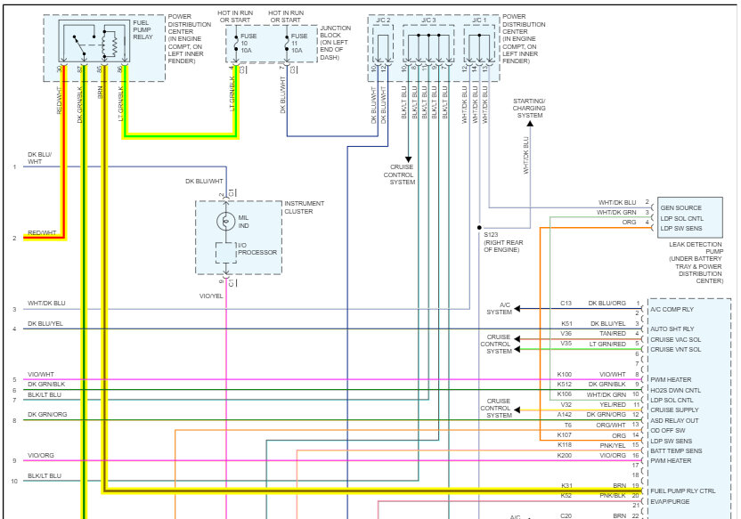

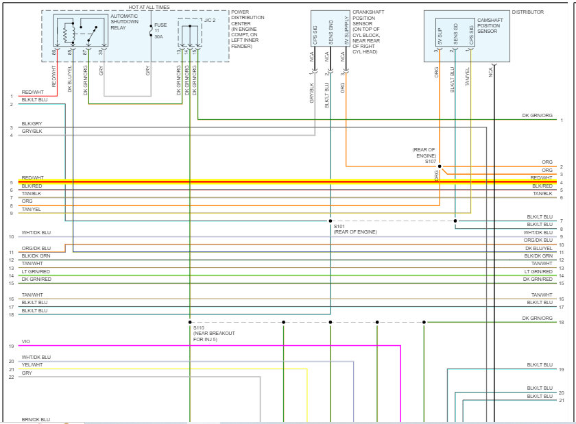

I doubt the PCM or Crankshaft position sensor is faulty. Also, I didn't realize there was a no-bus signal on the dash.

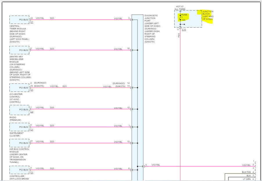

The PCI Bus failure modes are broken down into two categories, complete PCI Bus Communication Failure and individual module no response. Have you tried scanning the CAN to determine if there are specific codes that are stored for a specific module?

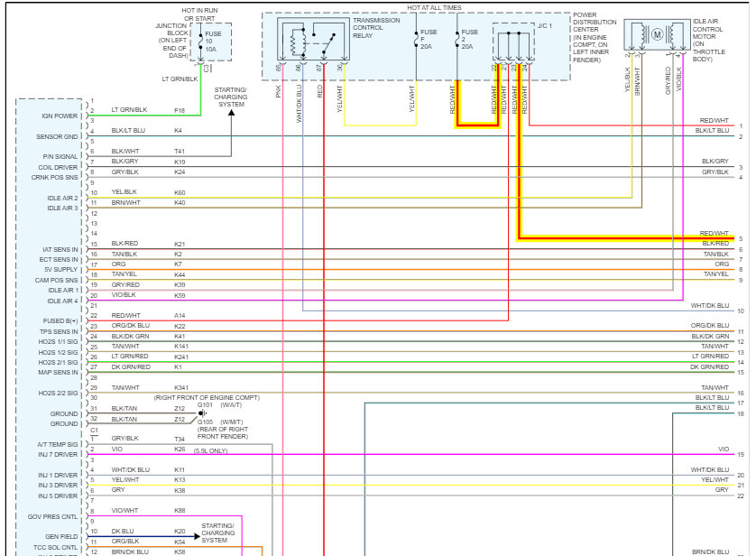

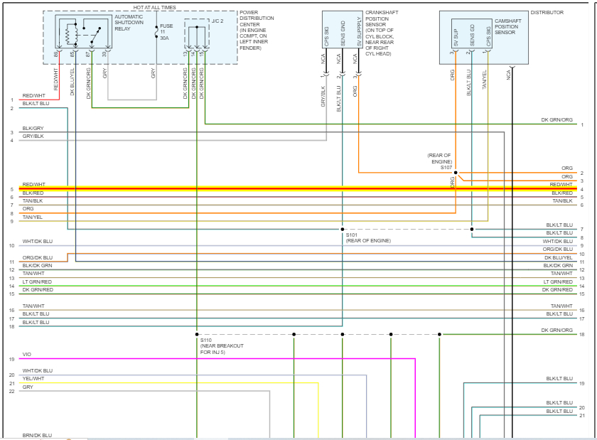

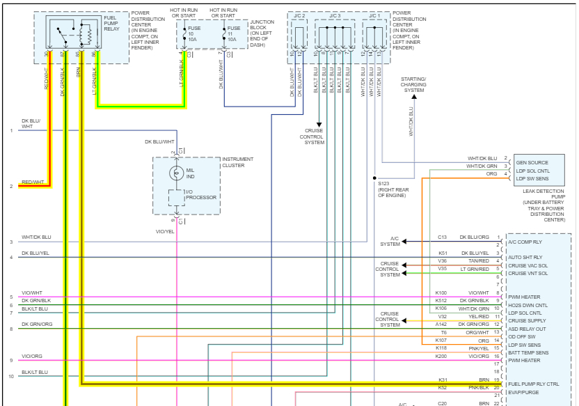

Also, I attached the wiring schematics for the entire powertrain management circuits. I highlighted all wires related to the fuel pump.
Confirm power is present to the two pins (30 and 86). Pin 30 should have constant power and 86 should have power with the key in the run position.
If that is present, check connector pin 85 for a ground signal when the key is in the start position. To do this, attach the alligator clip end of a test lamp to the battery positive. Probe the opposite end in pin 85. Have a helper turn the key to the on position. The test lamp will turn on if there is a ground path.
See pics below. Note: The schematic was four pages long. I had to cut each in half to make them readable.

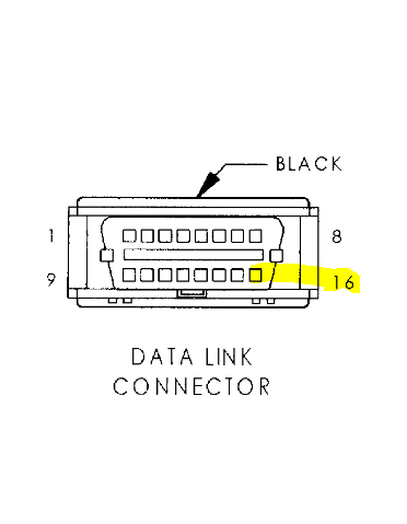

  • 110,194 POSTS

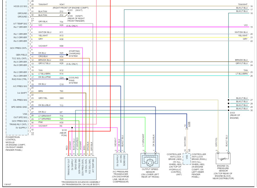

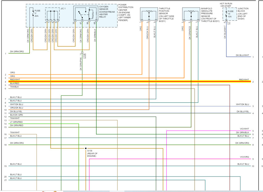

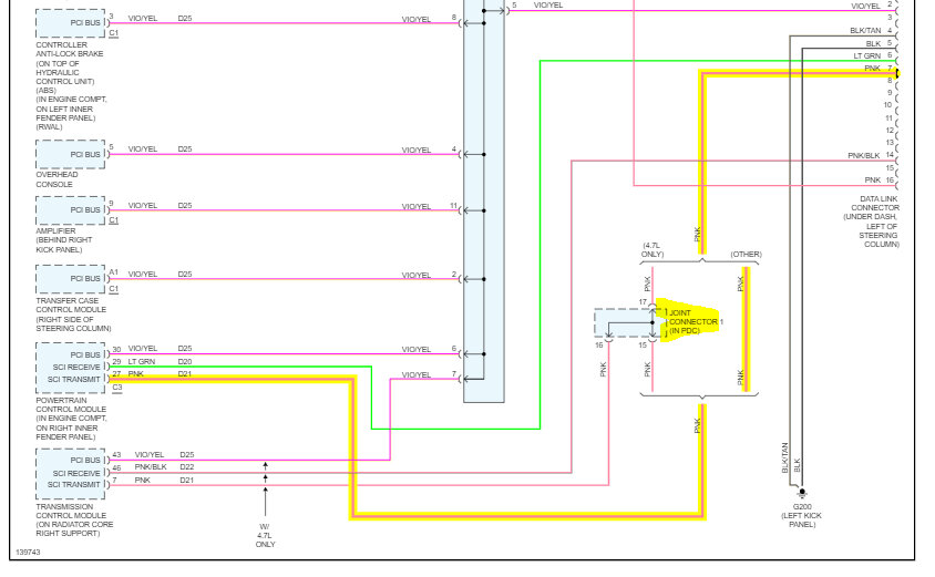

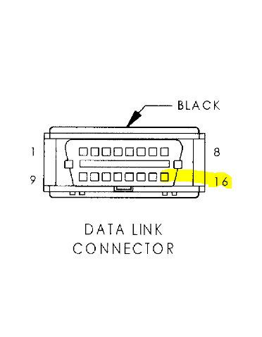

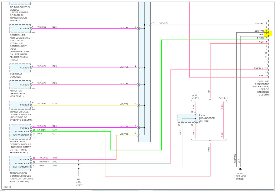

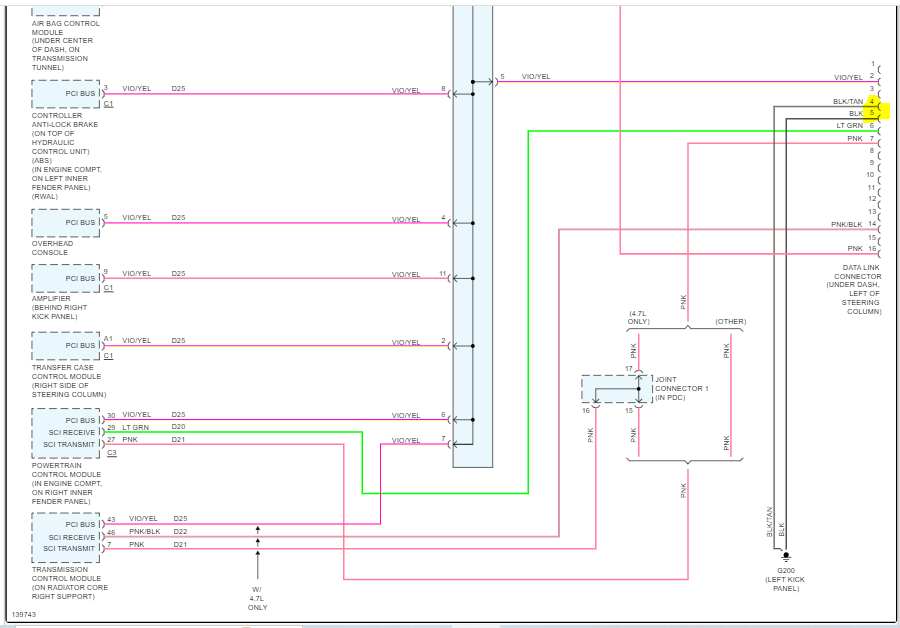

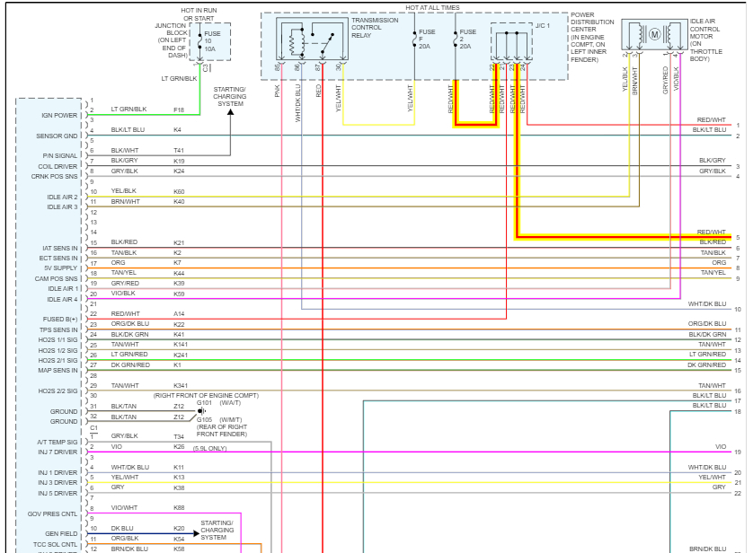

If you are unable to connect with a scanner, have you checked if pin 16 gets power at the DLC? It should have a constant B+ voltage and be powered by fuse 1 in the under-dash junction box. Also, pins 4 and 5 should be a ground on the DLC.
I attached the wiring schematic below for the can circuit. The next to the last circuit on the left is the PCM signal. If there is a communication error (bus) that is the area I would start checking. I highlighted in the last pic below a joint connection between the DLC and the PCM. If you disconnect the PCM, check to see if there is continuity in the pink wire between the two.

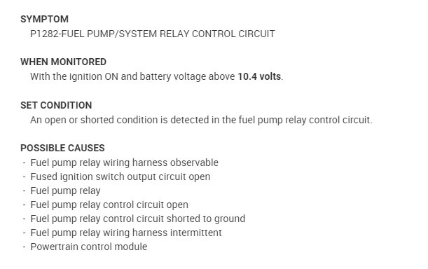

Replaced PCM with used one no bus is gone turned off and ran for a few rough had a guy tried to program it with VIN wouldn't allow him to reprogram had one code flash the dash p1282 with the new user PCM.

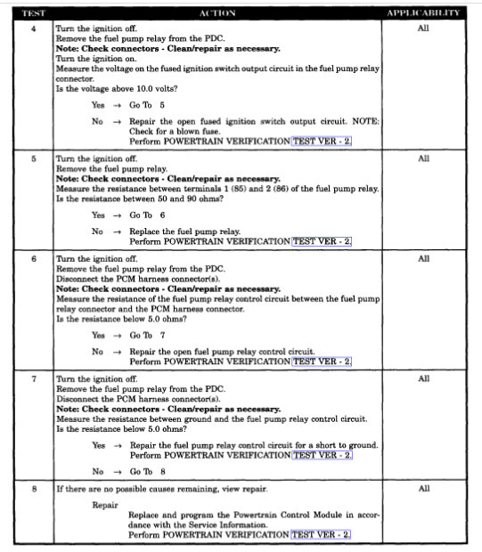

  • 110,194 POSTS

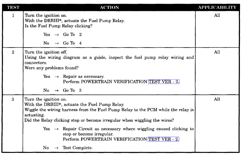

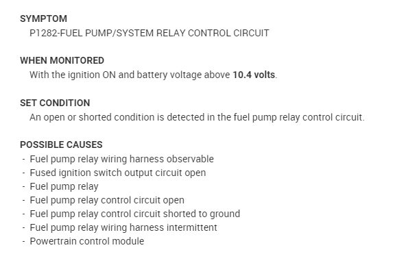

The code is related to the fuel pump relay circuit. I attached the diagnostics below specific to your vehicle and the code.
I have a question. If you feel the relay click, that tells me the primary side is working. If you are not getting power to the pump, there is likely an open between the two. If there is power, the pump may be faulty. However, the pump shouldn't cause this code.
