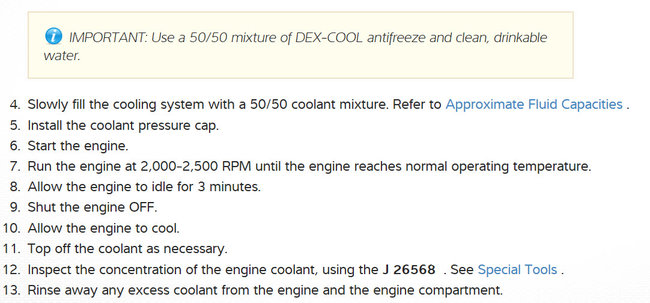

My heater works okay when car is moving. But even at stop lights the temperature turns cool.

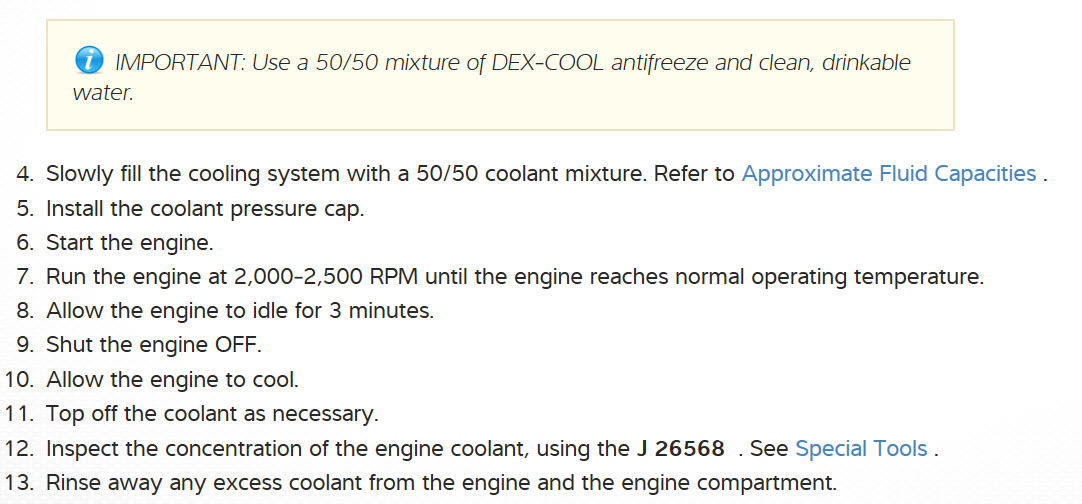

Make sure system is full if low have pressure checked for a leak, then follow procedure in picture it may have air in system or a bad radiator cap.
Image (Click to make bigger)

Worked perfect. Thank you!
