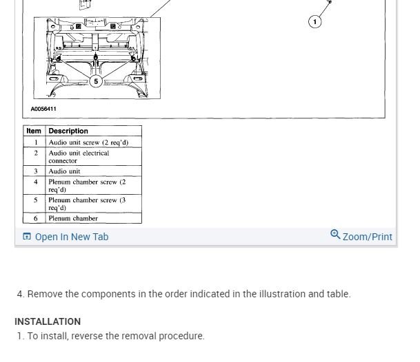

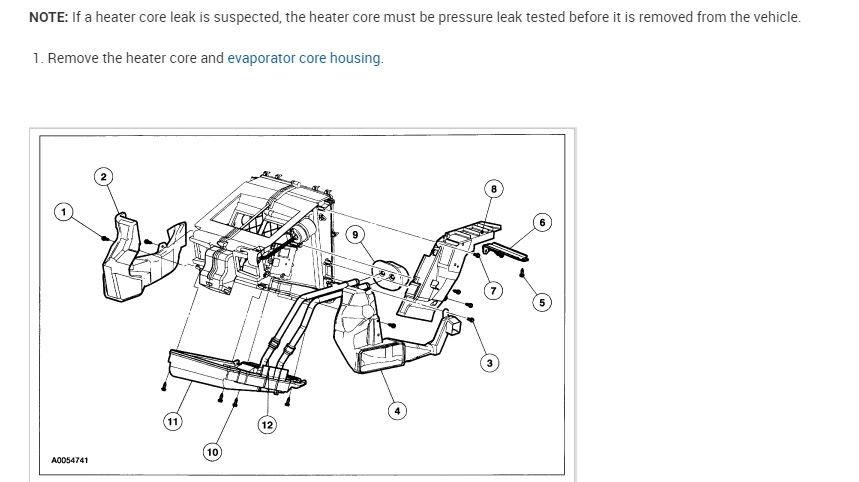

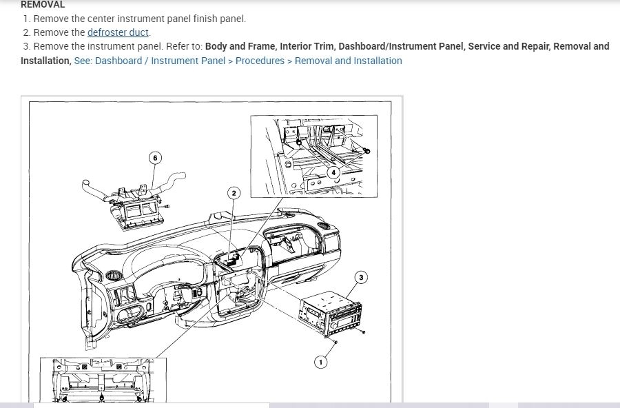

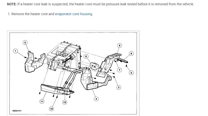

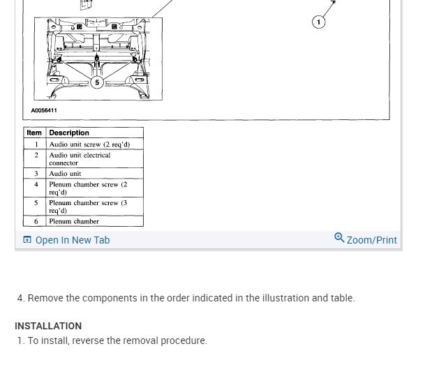

It is coming down to the heater core itself.
https://www.2carpros.com/articles/replace-heater-core
I attached a YouTube video below for you to view. This is how I do the repair to save a bundle of time.
https://www.youtube.com/watch?v=Y4G6ljTEL9k
