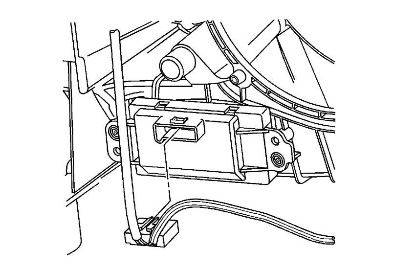

I have changed the blower motor and resistor he would not work. Next day it start blowing and working. Two weeks later again it stop blowing. Won’t work on any settings but when you cut it on you can hear it turn over but won’t blow.
Wednesday, January 15th, 2020 AT 11:17 AM
18 Replies
  • 52,797 POSTS

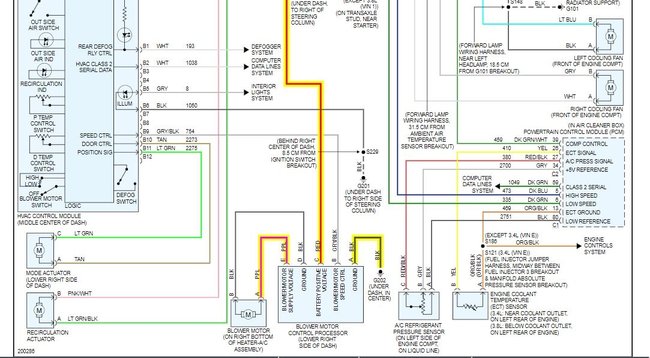

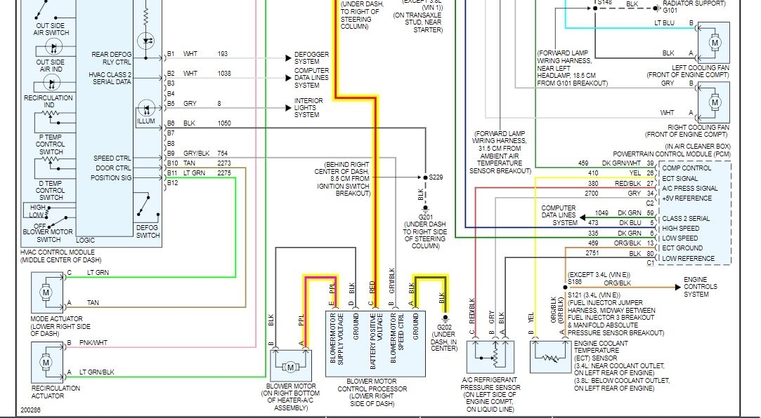

Good afternoon,
I attached a diagram for you to view.
Check the red wire to the resistor for power with the key on when the system does not work.
Trying to narrow the area of failure for it not working.

Okay, you need to check the voltage like I explained to see if power is available for the system to work.

Tested the wires to the blower motor and resistor and no power is going to either.

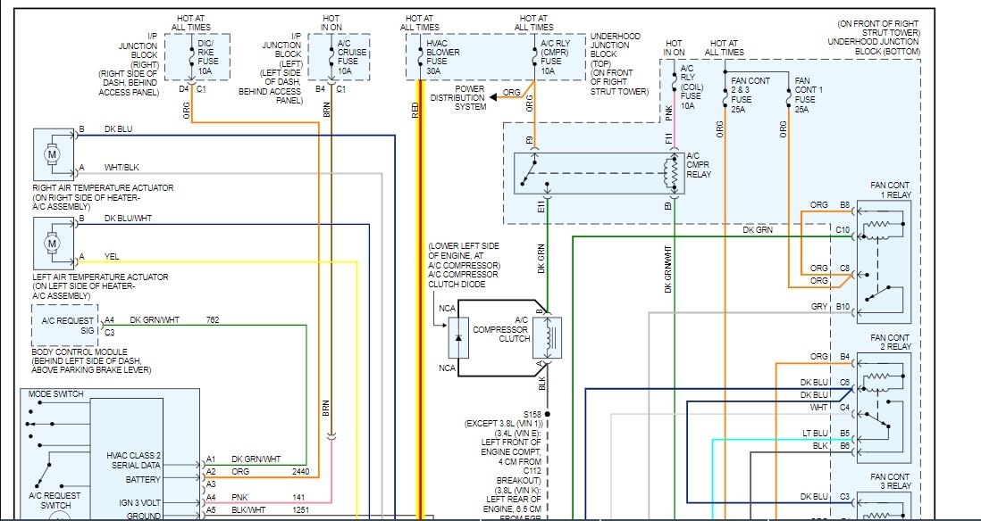

  • 52,797 POSTS
Check the blower fuse I listed on the diagram for power. That is what feeds the red wire to the resistor.

  • 52,797 POSTS
Did you check for voltage at the fuse? This is not a visual test, it is a voltage test at the fuse.

  • 52,797 POSTS
It should have voltage on both sides with the fuse installed.
If it does, then the wire is open between there and the resistor.

  • 52,797 POSTS
It is not a ground. It is a power wire.
Somewhere in the harness, there is an open. Where is a good question?
As far as running another wire, you could do that. You could run a wire from that fuse to the resistor and see if it powers up the motor.

  • 52,797 POSTS
No, it needs to go the red wire at the resistor. That is the wire with the issue.
