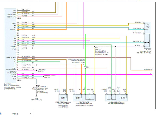

I checked fuses in the truck they are good. is there a fuses box under the hood for the blower? I hooked the battery straight up to blower motor and it works. Any answers?
Mar 19, 2021 at 6:09 PM
  • CAR REPAIR CONTRIBUTOR
  • 110,190 POSTS

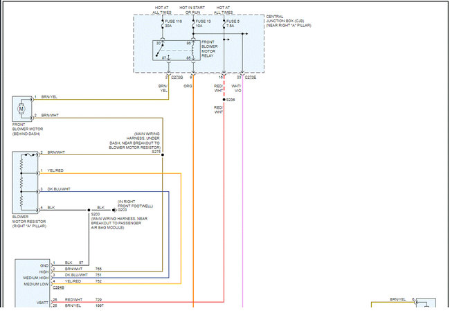

First, we need to determine if power is getting to the blower motor. If you look at the first pics below, I included the entire wiring schematic for the HVAC system.

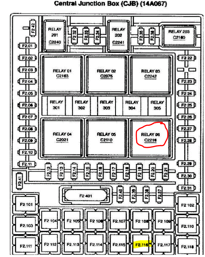

In pic 1, you will see the blower motor fuse and relay. Here are two links you may find helpful in checking both. Make sure when checking the fuse, there is power both to it and from it.
In pic 5, I highlighted the fuse and the relay to help you locate them.
If both check good, then you need to see if there is power via the brown wire with a white tracer at the blower motor resistor. Here is a link to help:
