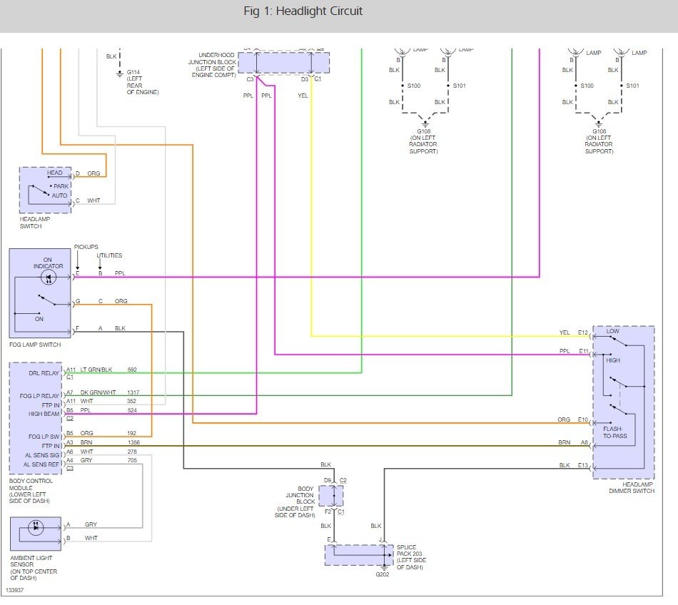

Will not work on high beam.

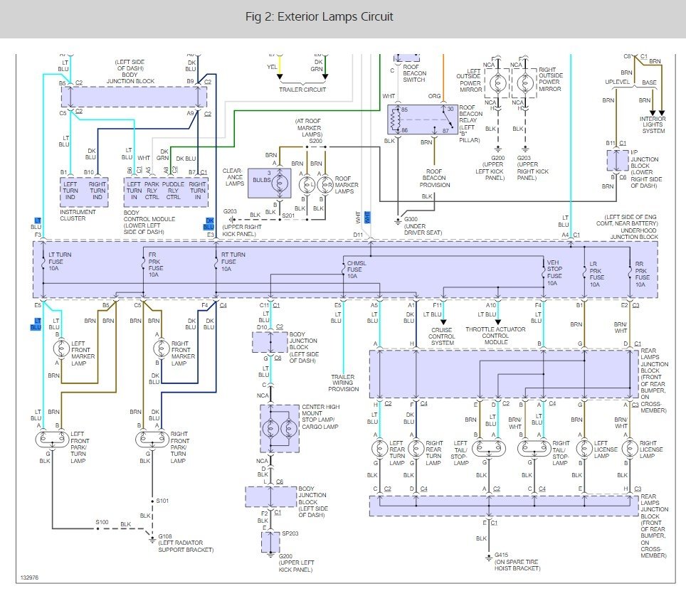

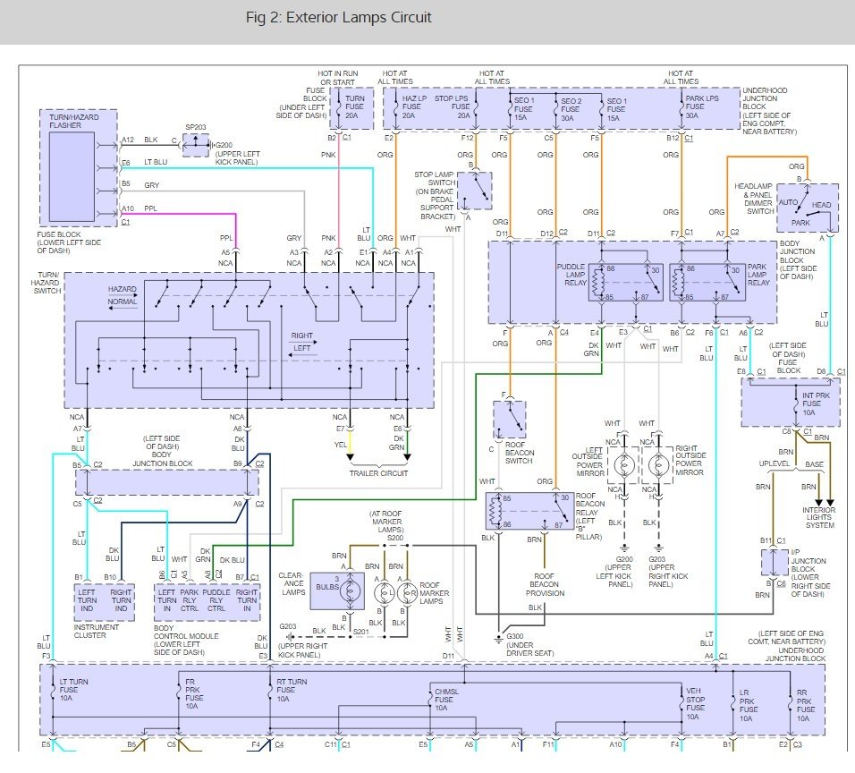

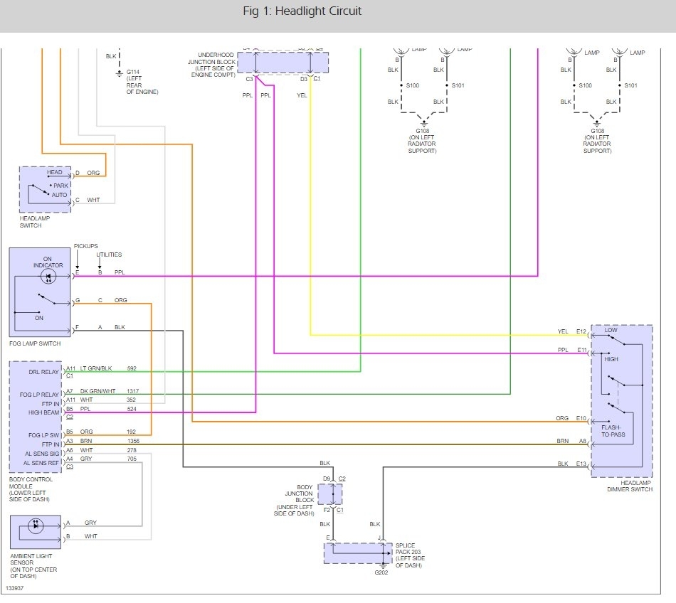

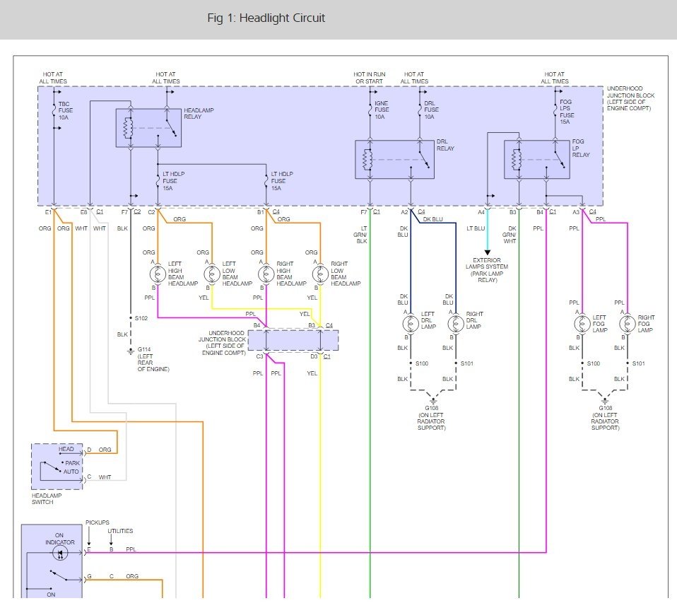

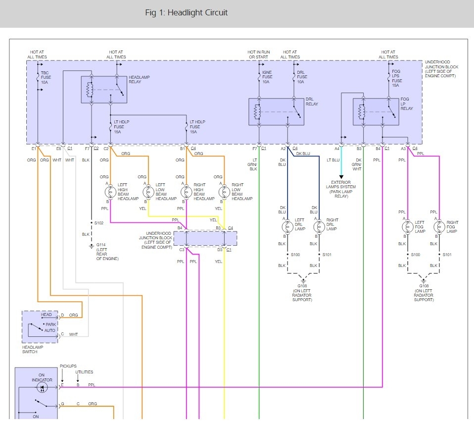

It sounds like you have a headlight relay or a dimer switch that is not working. Here is a head light wiring diagram and a guide to help you test the system and get the problem fixed.
and
Please run some tests and get back to us so we can continue helping you.
