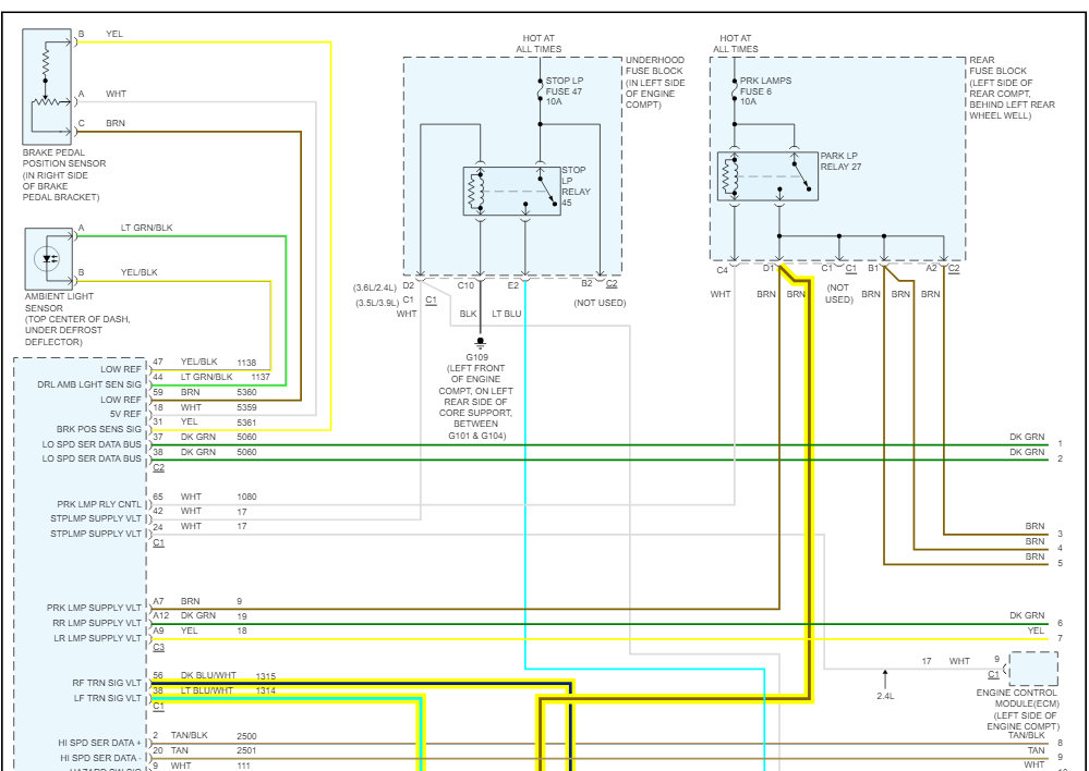

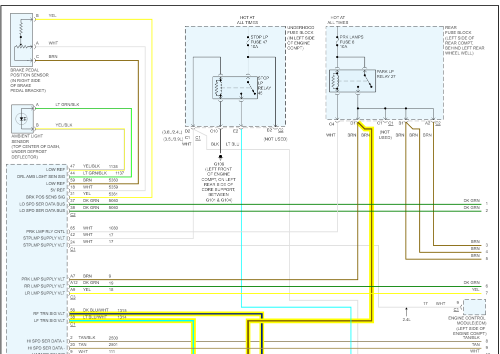

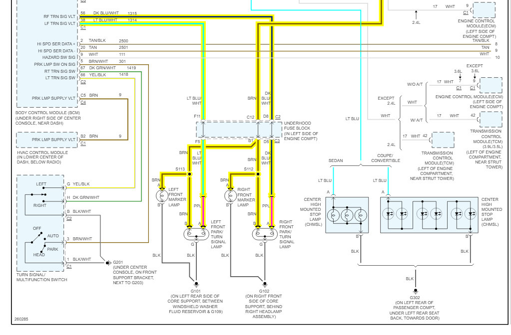

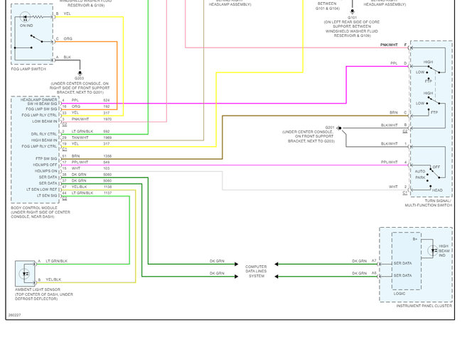

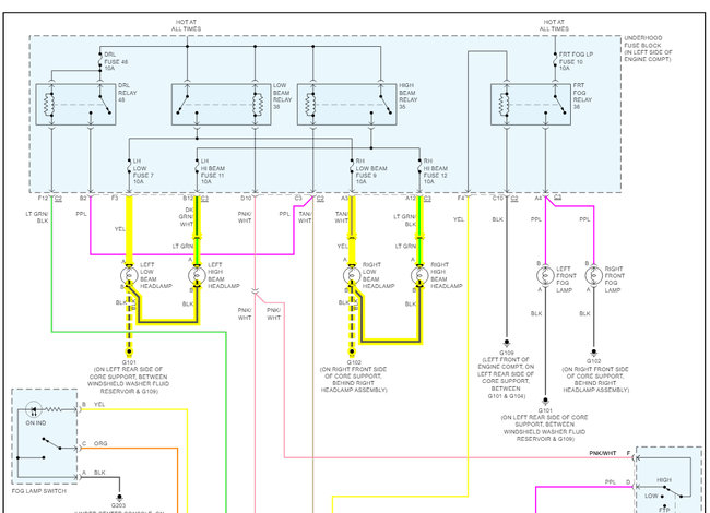

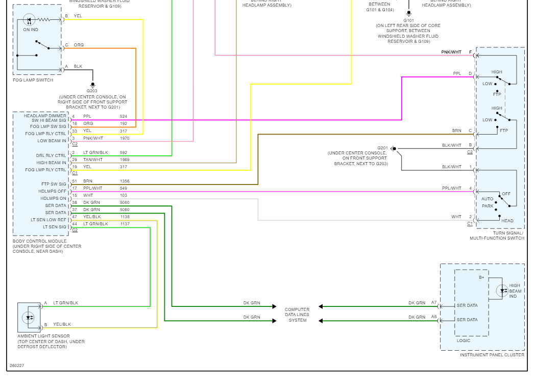

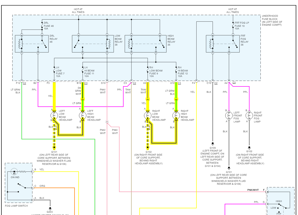

I just need a wiring diagram for the headlights and turn signal lights.
Sunday, May 29th, 2022 AT 7:32 PM
SQM
MECHANIC
6,383 POSTS
See attached for the wiring schematics.
Let me know of any questions.
