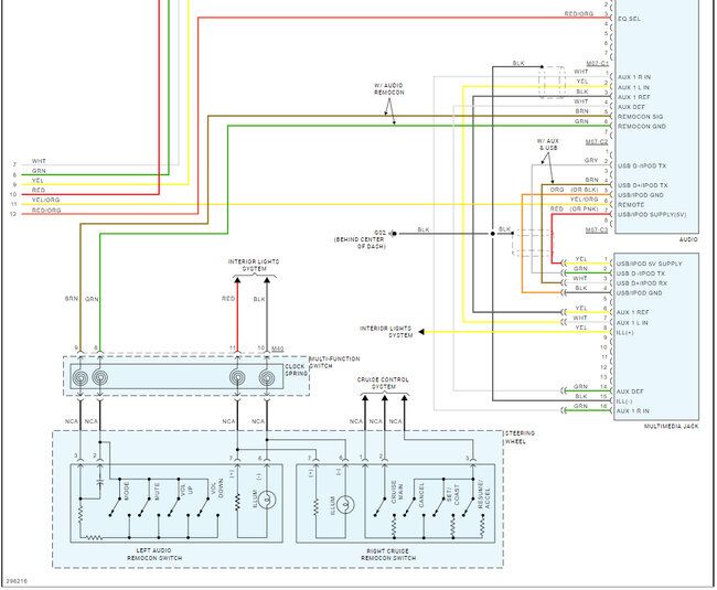

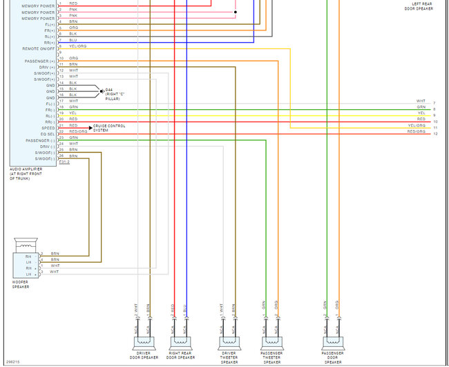

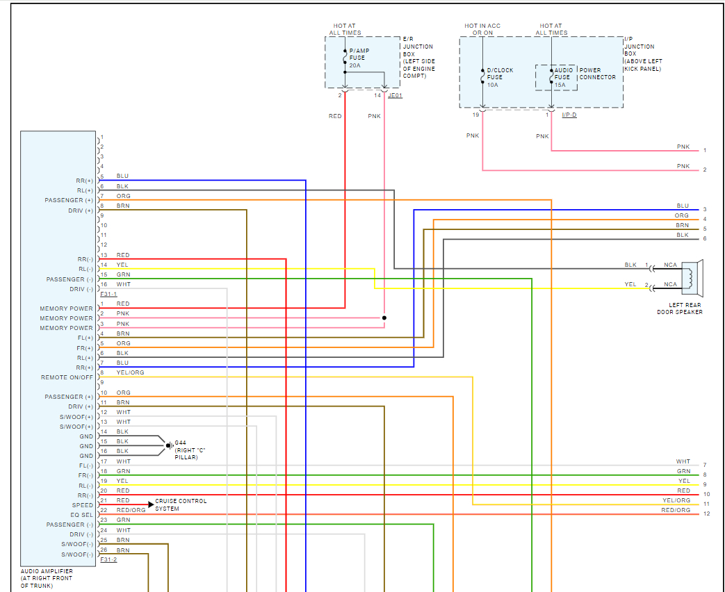

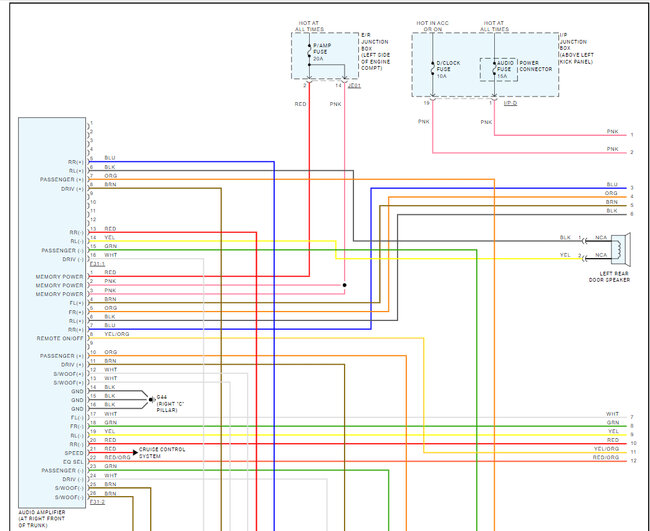

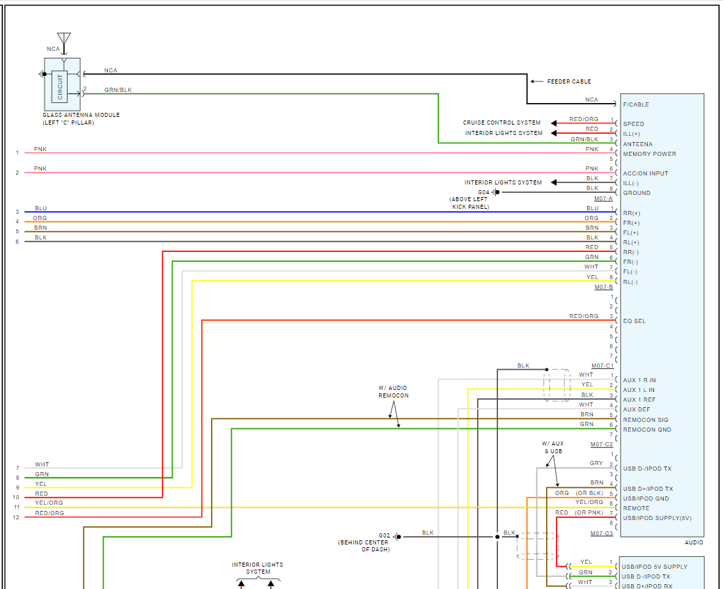

I need exact wiring diagram to install a after market double din radio head unit.

Sure, here are the wiring diagrams for the radio w/cruise and an amplifier. Check out the images (below). Let us know if you need anything else.
