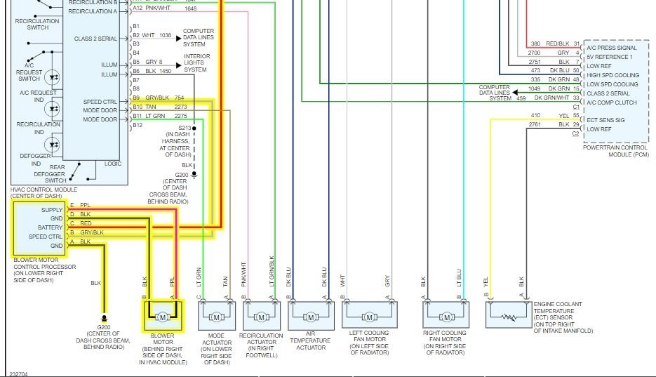

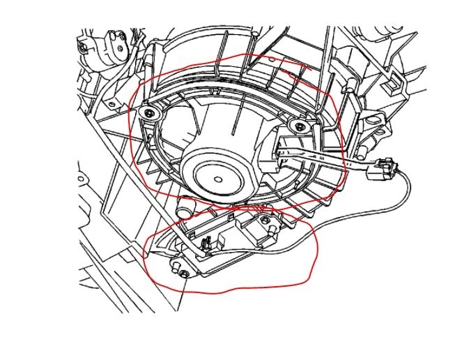

Blower motor not working. Correct power to resistor, new resistor, fan, control module.
plug in blower nothing.
Monday, October 19th, 2020 AT 4:28 PM
MECHANIC
52,796 POSTS
Good evening,

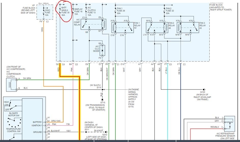

I attached a wiring diagram of the system for you.
https://www.2carpros.com/articles/low-or-no-air-flow-from-vents
Can you check and see if you have power to the purple wire at the blower with the blower commanded on?
Also, check the red wire to the blower control as well to be sure the fuse I circled is sending power to the module.
