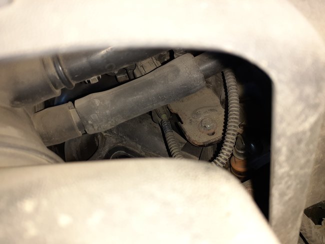

Okay, I have updates. First I went and got some MAF sensor cleaner and cleaned the MAF sensor, no difference. Then I went to have the battery and starter tested, battery tested bad, so with the warranty I was able to swap it out for a brand new one, starting issue improved but too soon to tell yet. I also had the codes ran, turns out there are now 3 codes, P0171, P1451, P0174. I looked around on the motor for a second and found a vacuum hose with some deterioration on it, it actually looks like a coupler, it's in the picture below. I'll replace that next chance I can. Not sure if my starting issue has improved, so far it has but the real test will be the first start up in the morning and after work.

The 2 codes p0171 and p0174 are both lean codes for bank 1 and 2. A vacuum leak can def cause these codes. Do a fuel pressure test under driving conditions to make sure you're not losing fuel pressure/volume under a load. Another easy test for a vacuum leak (especially around the intake manifold) is to spray some water around the base of the intake manifold. You will hear the water being sucked in while the engine is running. Much safer test than spraying any flammable liquids around a hot engine. As for the p1451 (evap canister vent solenoid circuit malfunction) means the vent solenoid has either lost power, lost control of the solenoid from the ECM, the solenoid has gone bad or there is a wiring problem. But I would start with the lean condition. A stuck rich oxygen sensor can cause a lean condition too. Do you have a scan tool at your disposal?

Hey Al, I sprayed some water around some vacuum hoses and around the intake manifold gasket area and I didn't hear it getting sucked in and the idle didn't change either so I'm going to be looking at the fuel pressure test next. The starting has actually gotten better but there's still a good amount of crank time on cold starting. When I do the fuel pressure test would it be best to do it while cold?
