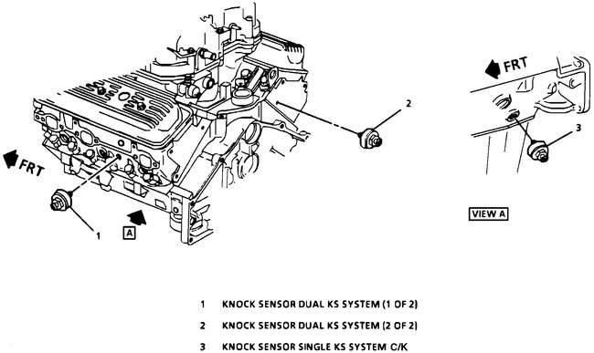

Would any of these codes cause a hard shift from first to second? It only shifts hard from first to second. All others are smooth like it should be.
May 14, 2021 at 11:26 AM
  • 110,193 POSTS
Hi again.

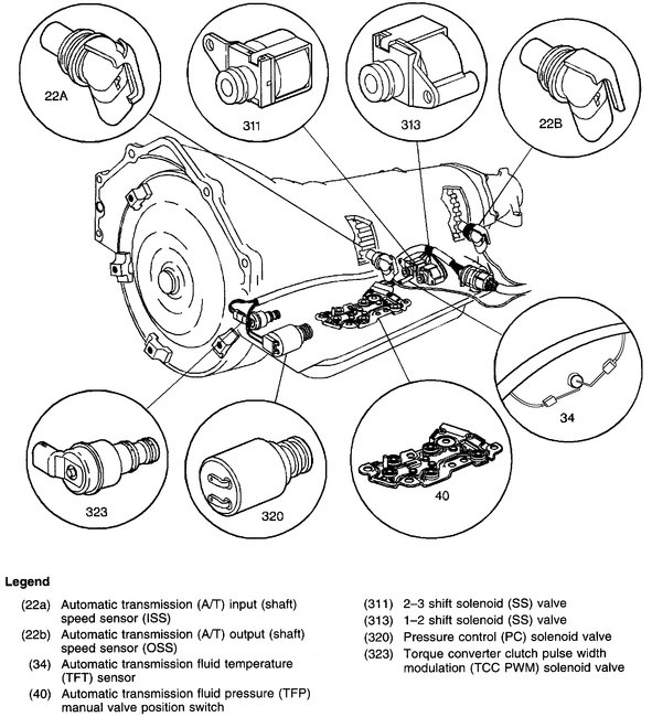

The knock sensor is mounted on one of three locations. It will be on the engine block. I attached a picture of the three locations. Now, the knock sensor is designed to recognize engine detonation. Basically, if there is valve ping, it changes the ignition timing to prevent the ping. Honestly, I do not feel that has anything to do with the transmission. The same with the o2 sensor.

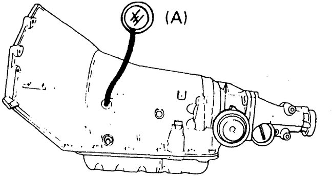

Since the fluid is clean and full, I have a feeling it either has to do with line pressure or the 1-2 shift solenoid is bad. Picture 2 indicates where it is located on a 4L60E Automatic trans.
_______________________
Here are the directions for checking line pressure on a 4L60E transmission, which I think you have.
Pictures 3 and 4 correlate with this test.
LINE PRESSURE CHECK
1. Prior to beginning line pressure check, check the following:
a. Transmission fluid level.
b. TV cable adjustment.
c. Outside manual linkage.
d. Engine tune.
2. Connect a tachometer to engine and install oil pressure gauge as shown.
3. When checking minimum TV line pressure, apply brakes, then take line pressure readings in gear range and engine RPM indicated in chart.
4. When checking full TV line pressure, tie or hold TV cable to its full extent of travel and apply brakes. Take line pressure readings in gear range and engine RPM indicated in chart.

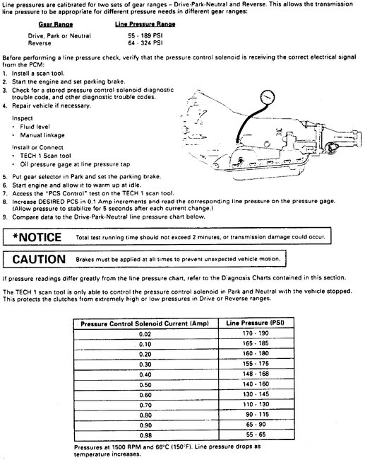

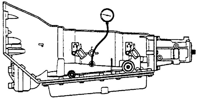

If you have the 4L80E trans, here are the directions for testing line pressure. Please note the time limitation for the actual test listed in the directions. It requires a scanner and these ones for the OBD1 systems are getting harder to find. Picture 5 correlates with these directions.
LINE PRESSURE CHECK
WARNING:Brakes must be applied at all times during this test to prevent any unexpected vehicle motion. Total test running time should not exceed two minutes, or transmission damage could occur.
1. Connect Tech 1 scan tool or equivalent to vehicle ALDL connector.
2. Connect suitable oil pressure gauge to line pressure tap.
3. Start engine and ensure transmission is at normal operating temperature and fluid level is full.
4. Check for trouble codes and repair if necessary.
5. With gear selector in Park, access "Override Force Motor" test on the scan tool, then increase force motor current in 0.1 amp increments (allowing five seconds for pressure to stabilize) and note pressure reading. Compare results with pressure chart. Line pressure will pulse either high or low every 10 seconds to keep force motor plunger free. This is normal and will not harm transmission.
6. If pressure readings differ greatly from pressure chart or if pressure is not within 35 - 177 psi in drive, park or neutral ranges and 67 - 324 psi in reverse range, refer to "Troubleshooting."

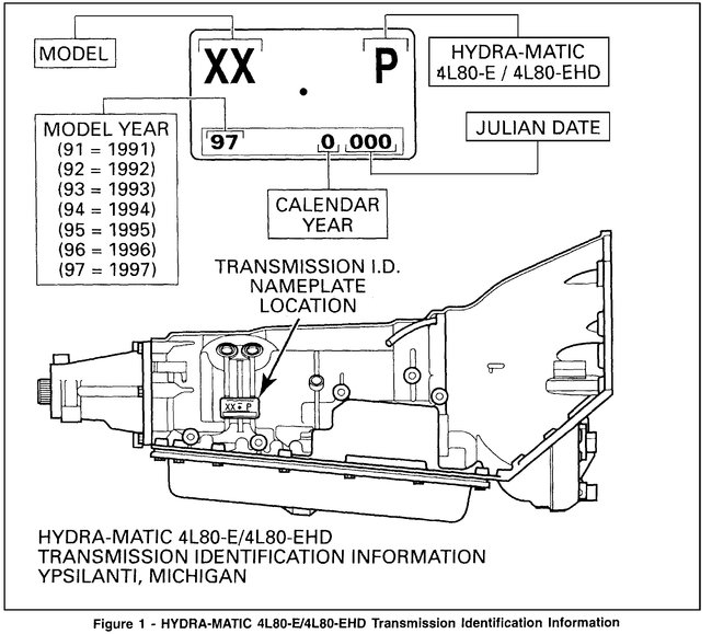

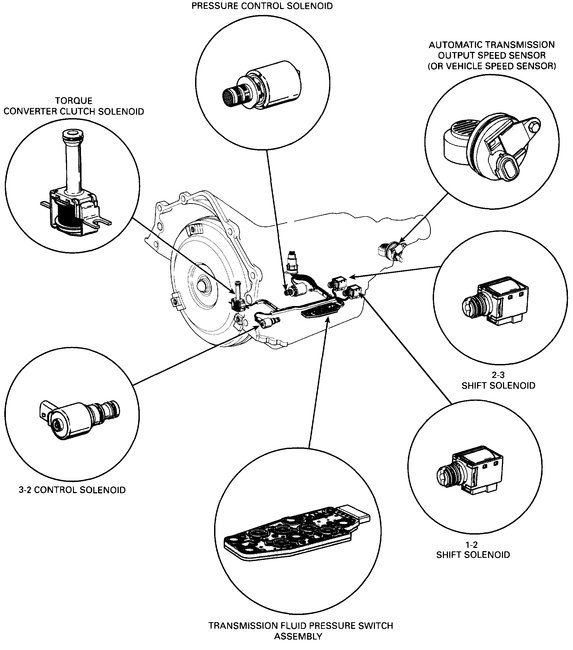

The last picture I attached is the location of the 1-2 shift solenoid for the 4L80E transmission.
______________________________________________
Because your truck is a 1/2 ton V6, I feel it has the smaller trans. However, I added info on both. There is one other thing I would like to add. Way back in the day, (1996) there was a technical service bulletin (TSB) that was related to replacement of the shift solenoids. If I recall, it dealt with a rough shift. However, I don't think it was only related to the 1-2 shift. I did a lot of digging and found the TSB. I thought I would add it in case you wanted to read through it. It was related to the 4L80E transmission, which I question you have. The last picture I attached correlates with this TSB.

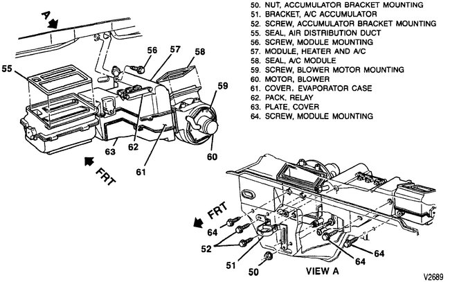

That sounds like an issue with the HVAC blend air door or mode door actuator. Look through this link and see if it correlates with what you are experiencing.

The A/C was blowing cool air. I know the A/C needs to be charged. The blower motor was blowing on my way home from work today. After parking the truck I started it up and turned on A/C. The blower motor stopped working all together but I can hear a knocking sound coming from around where the blower motor is under the dash on passenger side. It knocks for a few minutes then stops. It even does this when I shut the engine off and at start. It does it for a short time then stops.

That sounds like a blend air or mode door actuator making noise. It could be, however, related to the blower motor. It may be bad.

If you unplug the actuators, you will loose temperature control or air flow direction control. However, if it is the blend or mode door actuator, it should stop.

I unplugged the fuse for the A/C unit all together. The blower motor stopped working so I just unplugged the fuse. It stopped the knocking sound under the dash.
  • 110,193 POSTS
Then it sounds like there is an issue with the blower motor. The fan could be hitting something or the motor itself may be bad. Here are the directions for removal and replacement. Just in case you want to dig into it. The attached picture correlates with these directions.

I unplugged the fuse for the entire A/C system since the blower motor stopped working. It stopped the noise.
  • 110,193 POSTS
Chances are it is one of the actuators then.

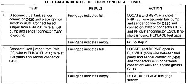

I changed the fuel pump and filter the other day. Now the fuel gauge is constantly reading full. I pulled it back out to test it. It seems to be working fine but the gauge is not working. Before I changed the pump the gauge read half tank of gas but I actually ran out of gas leaving me stranded.
  • 110,193 POSTS
Welcome back.
Either there is a problem with the sender or the wiring. I attached a diagnostic chart for you to follow. It will indicate if the problem is the sender or in the wiring. Take a look through it and let me know what you find.

Yes I found the problem with the fuel gauge.

I checked the connections. One has constant power. Others have none. After I checked wire connections, the fuse blew two different times. I have fuses for it. I do not want to keep putting in fuses if they are going to just blow. I know there has to be a short somewhere. A hot wire is grounding to blow fuse. How do I find out where it is?

If you need to find a short, you have to start tracing wires. Since you just replaced the heater core, my guess is that you have pinched a power wire under the dash which is causing the fuses to blow. Start by retracing your steps when the core was replaced. Check all around the heater core box under the dash to see if anything is pinched. Also, remove connectors to make sure none of the pins got bent and are crossed.
