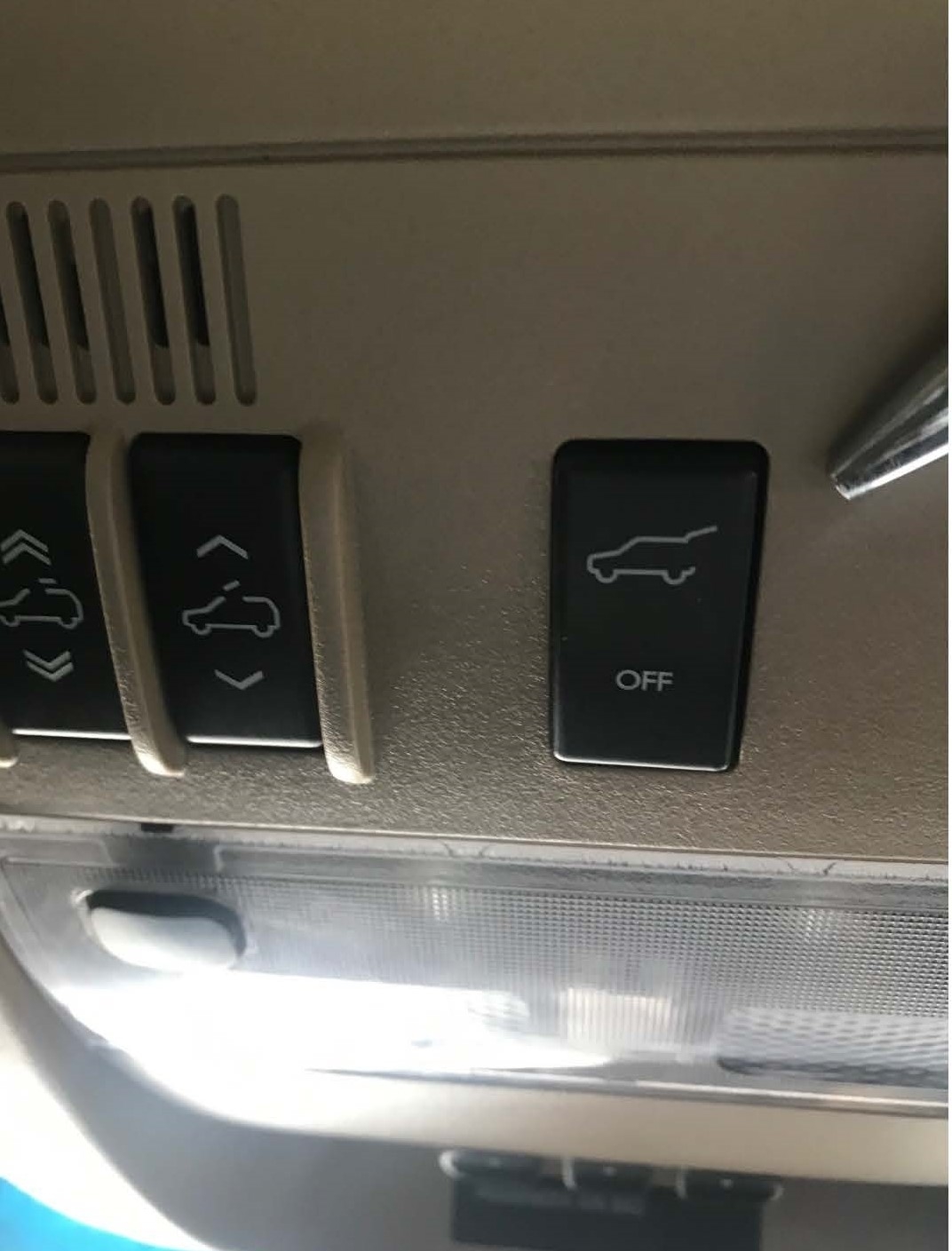

JDH55
I have a 2007 Yukon I was having the same trouble. I found that the switch above the rear view mirror was turned off. I turned the switch back on and everything started working fine. Hope this helps you out. Jdh55

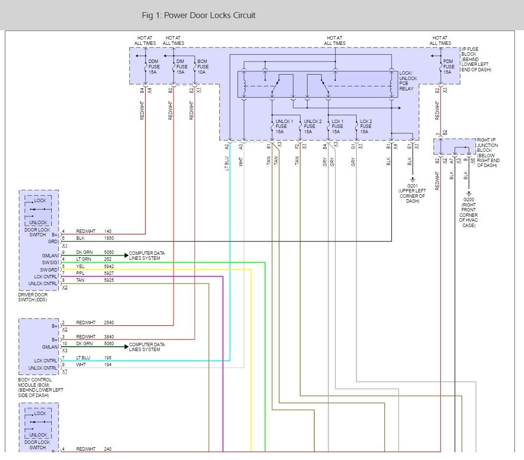

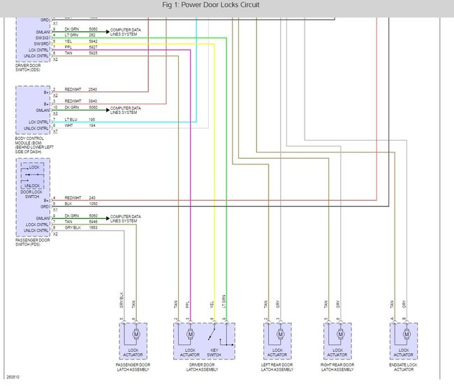

The rear hatch keeps unlocking by itself at no particular time. Door works fine but won't operate remotely or when auto-close button is pushed because the hatch keeps unlocking
-1
Saturday, December 8th, 2018 AT 6:35 PM (Merged)
KEN L
  • MASTER CERTIFIED MECHANIC
  • 55,488 POSTS
There is a center door lock relay that can be shorting out, here is a guide and diagram that should help you get the problem fixed.
If it all checks out I would have to say the BCM is shorting out which will need to be replaced.
Please run some tests and get back to us so we can continue helping you.
Best, Ken

MIKE MCCANN
Check the Open/Off Switch
This happened on 10-26-2019. Wedding Dance. Someone else designated driving my 2013 Suburban to the hotel at midnight. Passenger needed a dome light and accidentily turned off the switch on the upper console for the liftgate. Unknown to me, I thought the gate was broke. Turns out a few folks on here said to check the switch (I forgot it even existed). Go check your switch first. Mike McCann cost: I ain't telling my wife.

LOWRY89
You can also check the hatch window! I have a 2007 Yukon and if you’ve accidentally pushed the button on the key fob and it’s opened the hatch won’t unlock.
