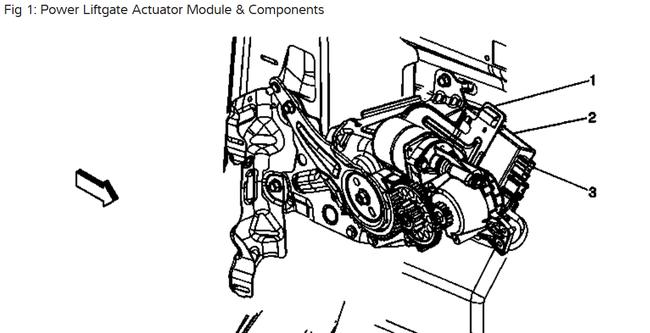

V8 front wheel drive automatic 49,000 miles. Lift-gate will not open or close electrically. There is a sound when initiated but gate quits not lifting or closing. Liftgate will open manually. Can I check the motor, it does not seem to run? Possibly a relay or control module?
Nov 8, 2010 at 7:56 PM
BLUELIGHTNIN6
  • 16,542 POSTS

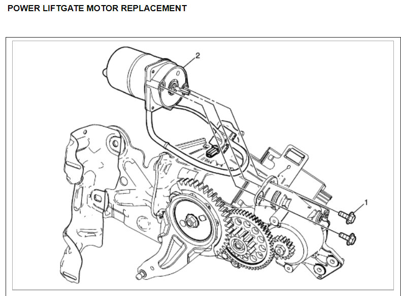

You will have to use the lift-gate trim panel plug to open it and then remove the lift-gate trim panel to inspect the latching mechanism. Try lubricating the latch with WD40 and see if that helps the issue.

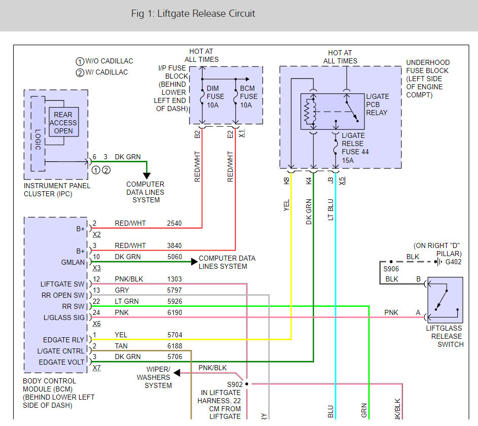

Since the gate is opening manually you can easily remove the trim panel to access the motor. Before doing this though, you can check the fuse labeled LCK2 (15 amp) , OBS DET (10 amp) and UNLCK2 (15 amp) all in the instrument panel fuse block located at the left side of the instrument panel behind the access panel.
If these fuses are good then the lift-gate release relay may be bad, unfortunately this is a printed circuit board (PCB) relay which means it is built into the fuse block, so if it is bad the entire block must be replaced. You said you hear a noise when pushing the button though, so I would assume that is the relay clicking. You can test the motor by supplying twelve volts direct power to it from a twelve volts source (i.e. spare car battery). With twelve volts direct power and a ground, the motor should run without using a switch. If it does not run this way the motor is bad, if it does run then power is not getting to it.
If the lift-gate is not opening manually you will have to locate the dimple on the trim panel. Use a 1 1/16" drill bit to drill a hole through the trim panel in the dimple area. Use a flat blade tool (i.e. screwdriver) to push down on the black bell-crank lever through the plug hole to unlock the lift-gate. Push open the lift-gate from the inside.

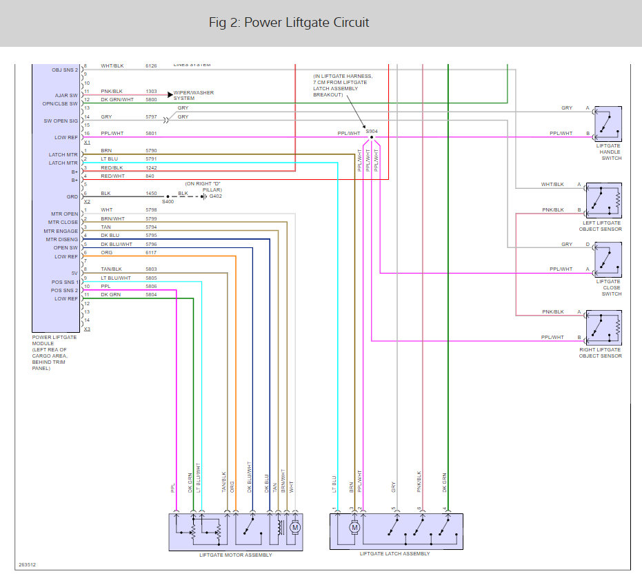

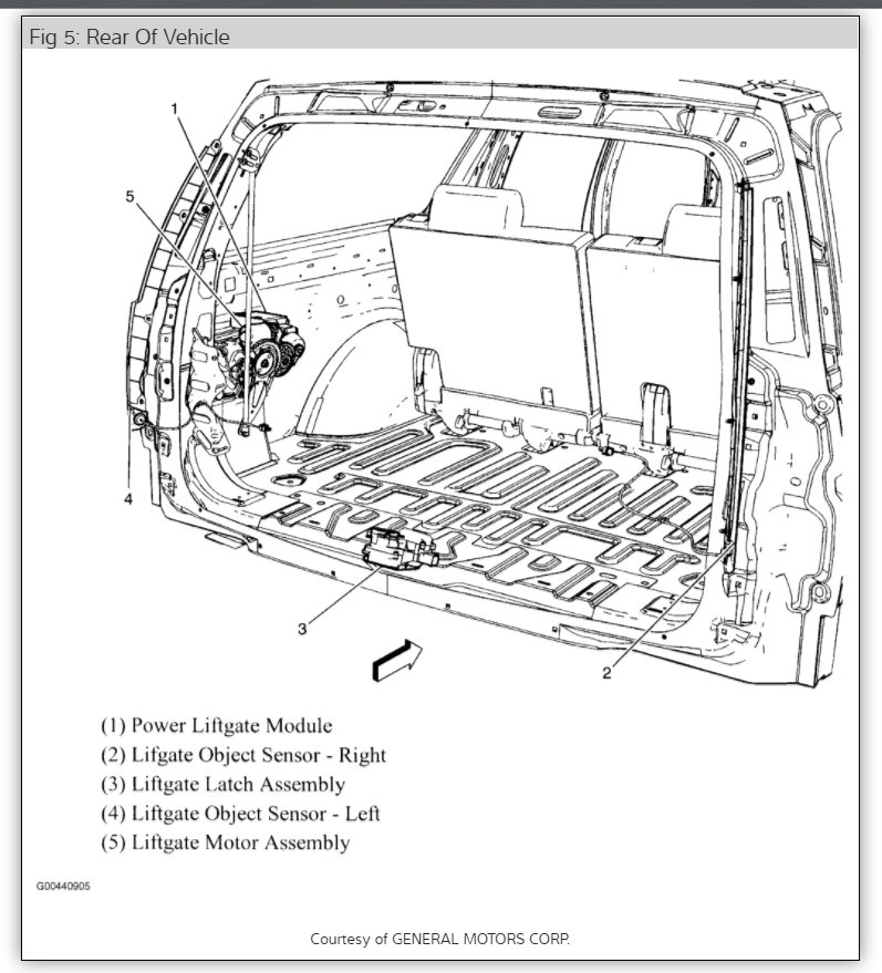

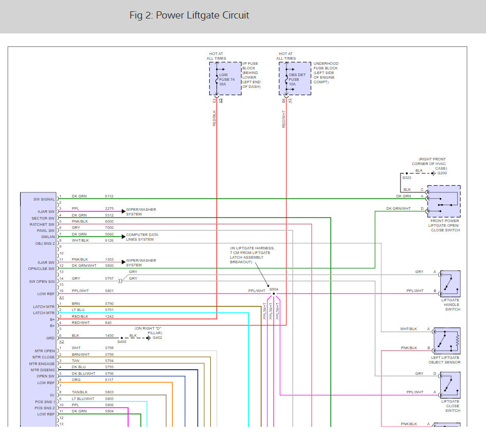

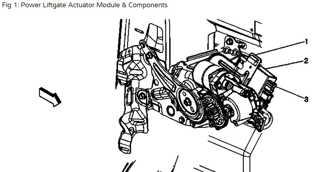

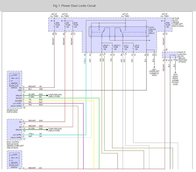

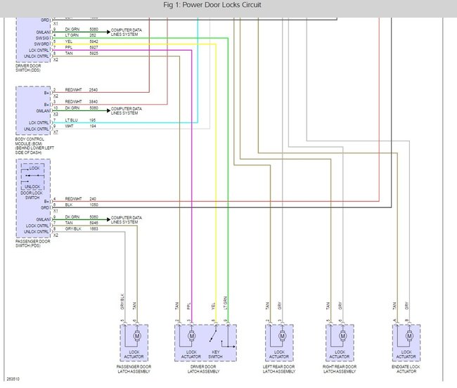

What happens in these cars is the liftgate motor starts to go bad causing the amperage to be higher than the electronics are designed for so it burns them up there is also a control module that works the system as well.
Here are the wiring diagrams and repair manual diagrams to help you see how the system works. It sounds like the liftgate module is bad. Check out the diagrams (Below) Please let us know what happens. Cheers, Ken

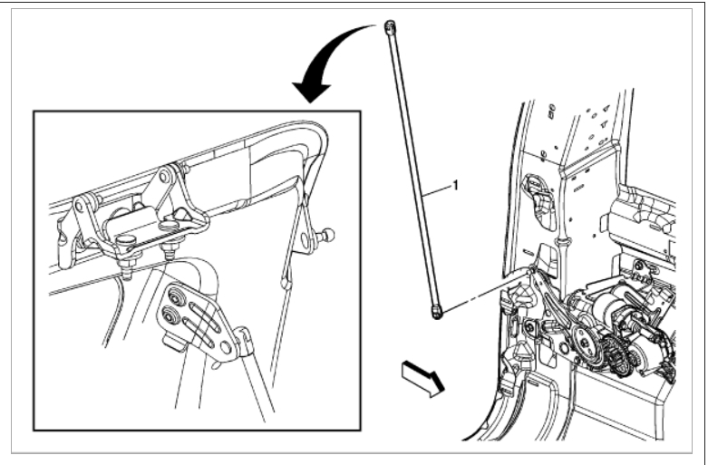

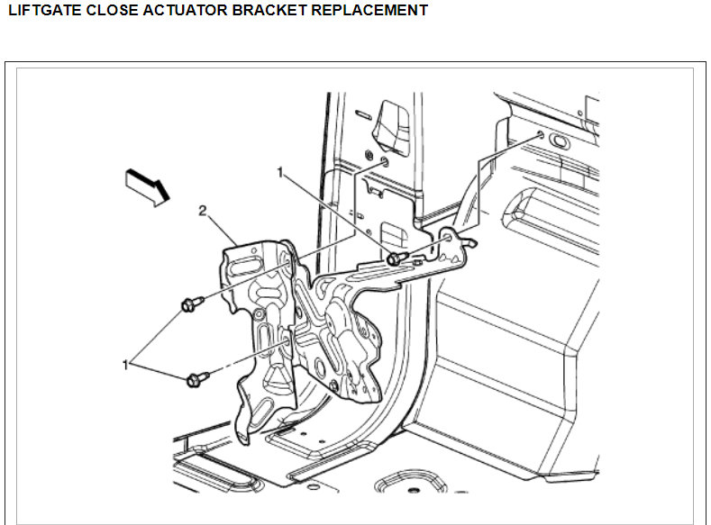

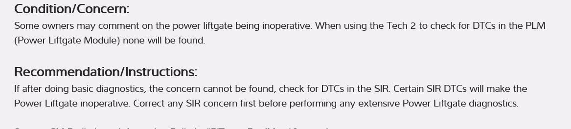

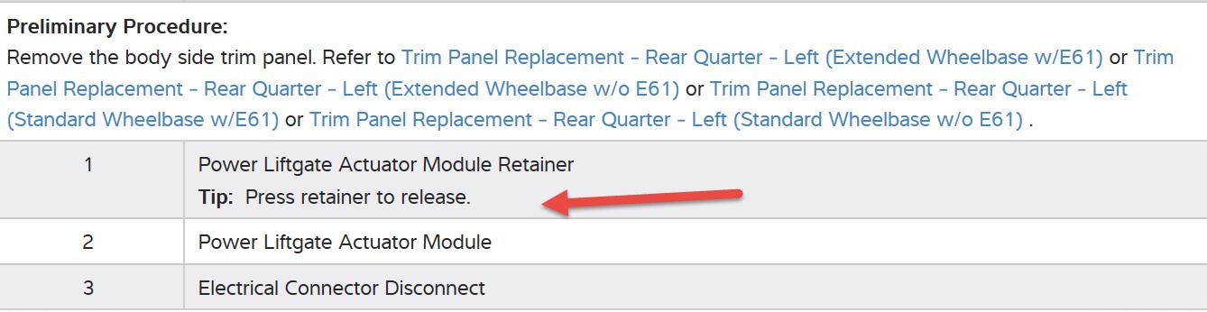

if it was recently repaired then it needs to be calibrated. it may need to be scanned by a pro to see if a sensor is bad however. see pics.

They probably did not calibrate the lift-gate, there is a tsb on this, its number is 06008a if it was done at a dealer I would take it back and have them fix it or call GMC they will see that is gets fixed. There is an updated version for calibration as well.

One last question. Along with your original answer to my concern you mentioned a TSB and included an image that talks about testing the components for power. My question now is, is that image you included the TSB or is it in addition to the TSB? I want to be sure before I discuss this with my mechanic.
Thanks much for your reply and invaluable info.
Gary T
Dec 8, 2018 at 6:34 PM (Merged)
HMAC300
  • 48,601 POSTS
the picture is a posting of a tip other mechanics have run into so it's in addition to the tsb. The local mechanic may not be able to do either of these so you'll have to talk it over this may have to be done at a dealer.

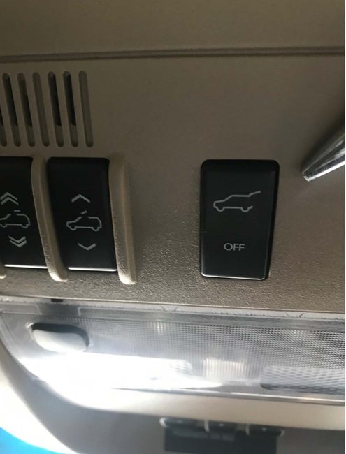

I have a 2007 Yukon I was having the same trouble. I found that the switch above the rear view mirror was turned off. I turned the switch back on and everything started working fine. Hope this helps you out. jdh55

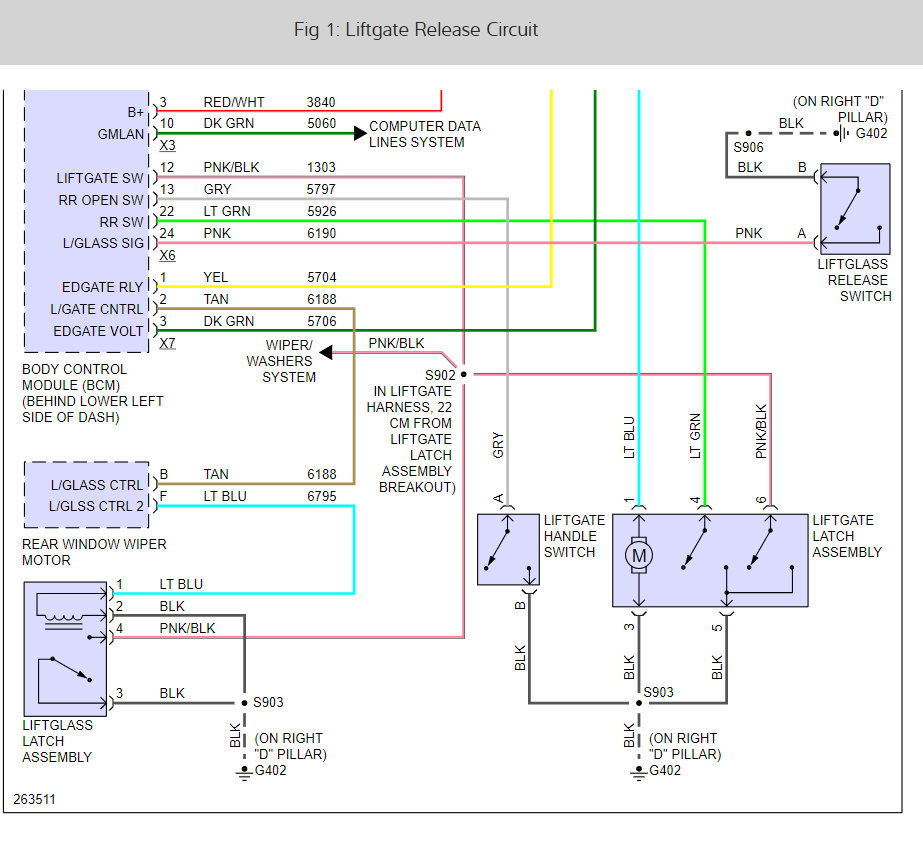

There is a center door lock relay that can be shorting out, here is a guide and diagram that should help you get the problem fixed.
If it all checks out I would have to say the BCM is shorting out which will need to be replaced.

Check the Open/Off Switch
This happened on 10-26-2019. Wedding Dance. Someone else designated driving my 2013 Suburban to the hotel at midnight. Passenger needed a dome light and accidentily turned off the switch on the upper console for the liftgate. Unknown to me, I thought the gate was broke. Turns out a few folks on here said to check the switch (I forgot it even existed). Go check your switch first. Mike McCann cost: I ain't telling my wife....
