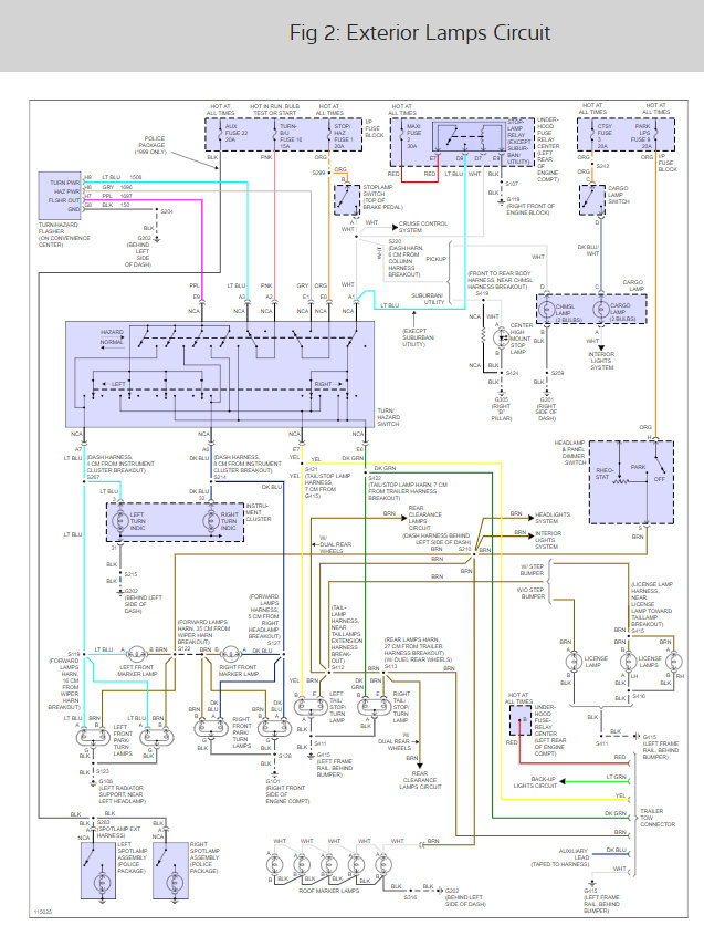

The tail lights, turn signal and brake lights do not seem to be working correctly. When I turn the lights on the tail lights lite up. When I step on the brake the driver's side brake light goes out. If I turn the left turn signal on it blinks, but once you step on the brake it does not. We have changed bulbs, fuses and tried to check the wiring but not knowing the wiring schematics makes it difficult.

It sounds like you have a fuse out or the hazard/turn signal switch that is not working right. Here is a guide to help you see where you are loosing power:
Here are the wiring diagrams for the rear lights, please let me know if you need a larger version.

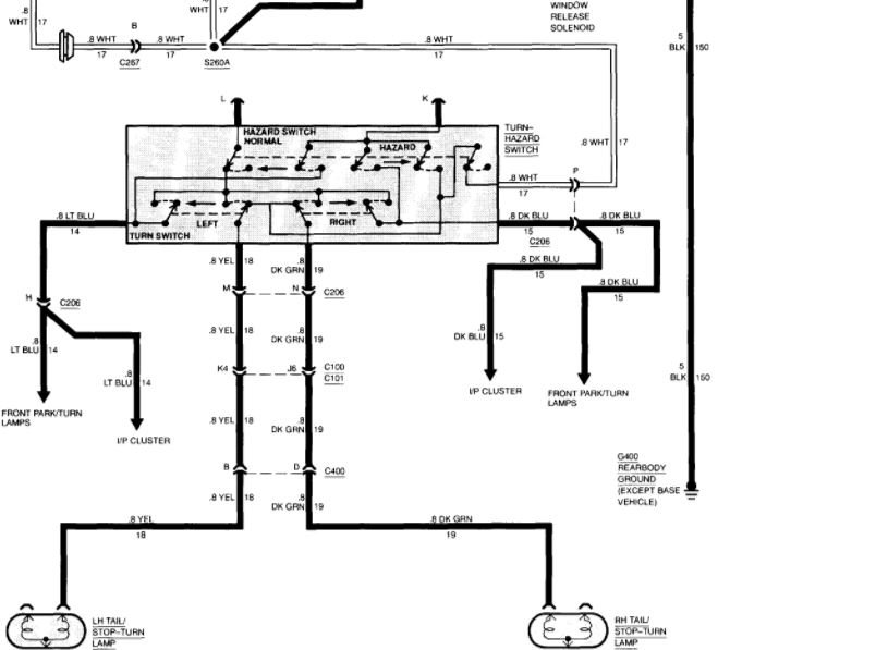

The right hand blinker and right hand brake light does not work I have changed the bulbs and the part that the bulbs fit into.
Monday, July 27th, 2020 AT 10:31 AM (Merged)
Good morning.
The power comes from the turn signal switch for the right rear brake and turn.
The first thing I would do is to check for power to the connector. Use a test light or voltmeter to verify.
If you have no power then you need to go to the turn signal switch. Check the dark green wire from the switch.
