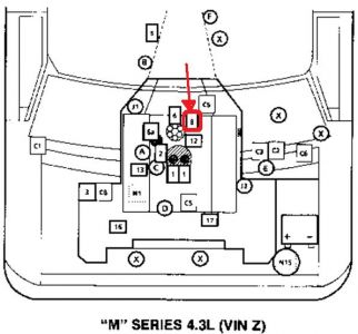

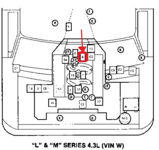

Thank you. He is going out now to see if he can find the switch. Would there happen to be a diagram or somthing he could look at if he cannot find it? Thank you again for helping we really appreciate it a lot!
Tuesday, May 18th, 2010 AT 11:14 PM
BLUELIGHTNIN6
  • 16,542 POSTS
Sure, there are two different versions so just match up your safari's 8th digit in the VIN to one of the diagrams below. the first diagram is for 8th digit VIN "W" while the second is for 8th digit VIN "Z"..
https://www.2carpros.com/forum/automotive_pictures/261618_Noname_2191.jpg
https://www.2carpros.com/forum/automotive_pictures/261618_Noname2_711.jpg
Tuesday, May 18th, 2010 AT 11:23 PM

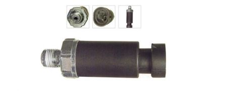

He is out there looking for it and he says he cant find it. I dont know if he is over looking it or what. I dont think he is sure what it looks like, but we see nothing that could be any type of switch.
Tuesday, May 18th, 2010 AT 11:35 PM
BLUELIGHTNIN6
  • 16,542 POSTS
Will be mounted into engine block and look similar to pic below.. it is called oil pressure switch but the fuel pump runs through the circuit as well
https://www.2carpros.com/forum/automotive_pictures/261618_Noname_2193.jpg
Tuesday, May 18th, 2010 AT 11:40 PM

Thank you so much for your help we really appreciate it. We are going to go buy one tomorrow and hopefully that will fix it. Thanks! But would you now why the brain reader didnt read that is was not working?
Tuesday, May 18th, 2010 AT 11:58 PM
BLUELIGHTNIN6
  • 16,542 POSTS
Computer can not recognize a failed oil pressure switch if the oil pressure is still reading good. The oil pressure switch itself may be good, but the internal wiring that is part of the fuel pump circuit may have failed which means no juice to fuel pump, but a fully function oil pressure gauge or warning lamp.
