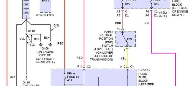

Turn the key to crank clicks one time and there's no start. I have cleaned all the top side connections. I can crank it by jumping the solenoid with a screwdriver.
Friday, March 6th, 2020 AT 5:28 PM
24 Replies
  • 108,334 POSTS
If you can jump the solenoid and it starts, then there is a connection issue. Is the smaller wire on the starter clean and tight?
I need you to check something. Have a helper turn the key to the start position while you check for 12v at the smaller wire on the starter. Here is a link that explains how it is done:
I noted that you cleaned all connections on top. Have you done anything at the starter itself? Also, have you tried to see if it starts if it is in neutral?

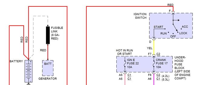

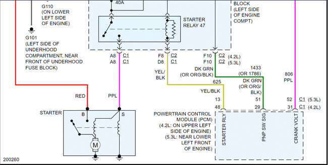

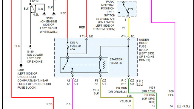

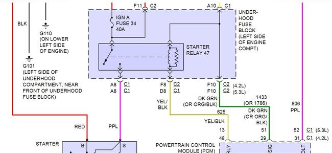

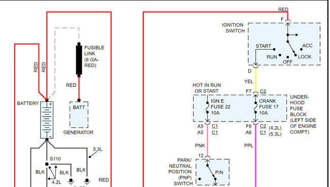

I attached three pics below that are the entire starting system schematic. I overlapped them so you can follow them. Make sure to check the fuses indicated in the pics as well as the relay.
Here are a few links to help when checking:
and
and
