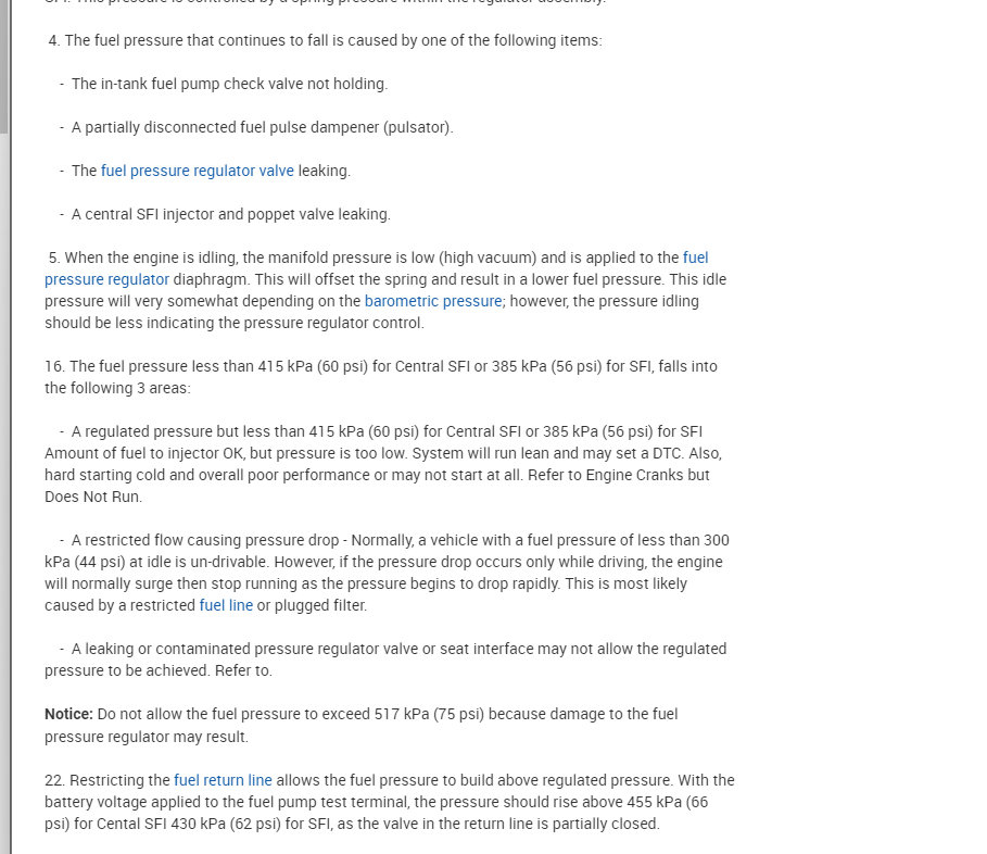

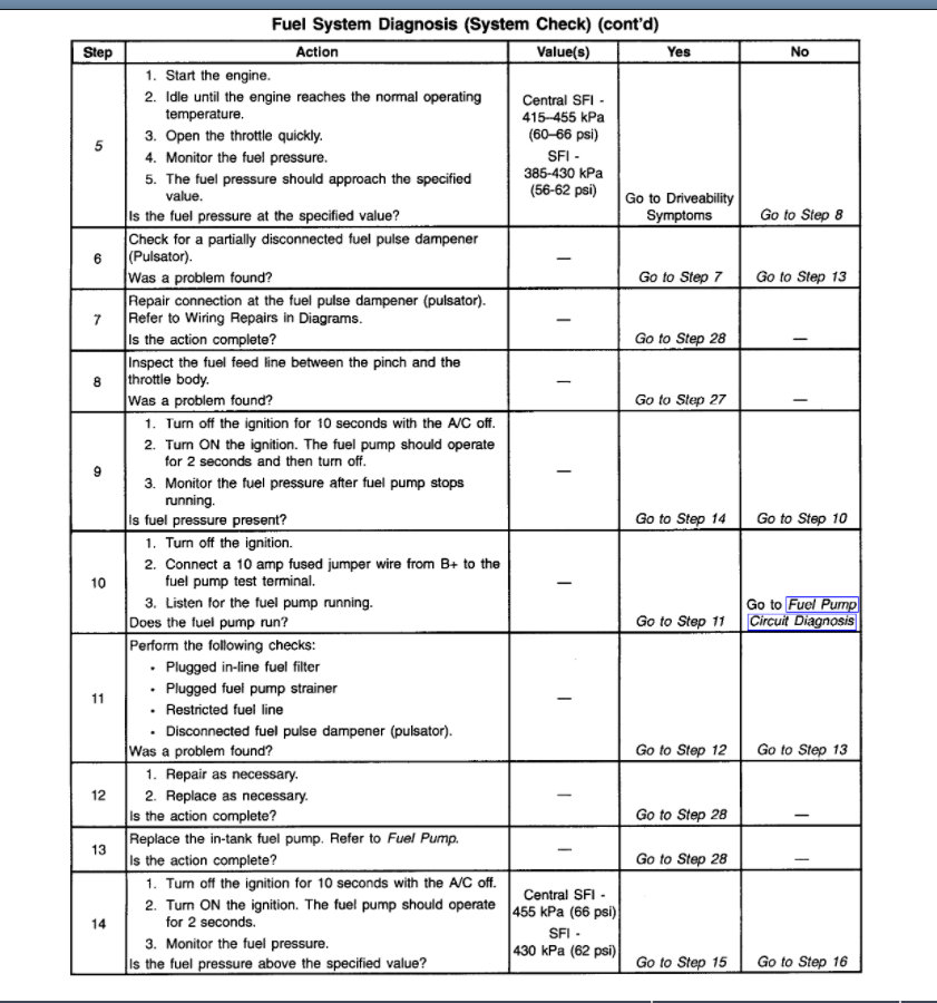

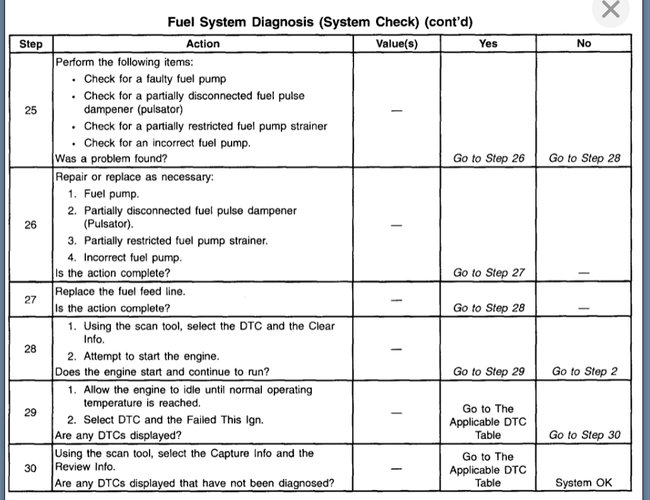

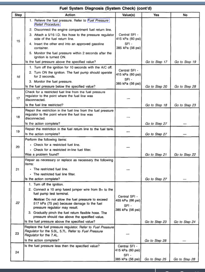

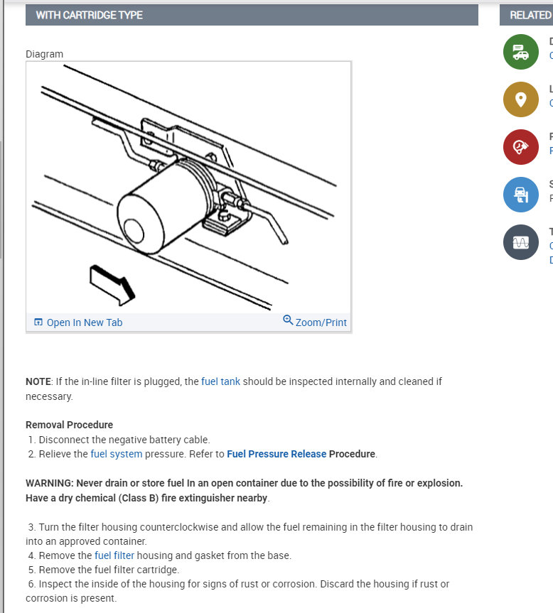

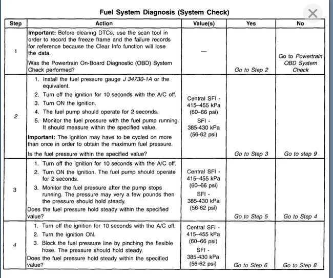

can I put an inline fuel pump in the truck instead of re doin the in tank one it is not working and would like to just use a regular inline hi pressure one if possible and what psi should I use

No, you can not
