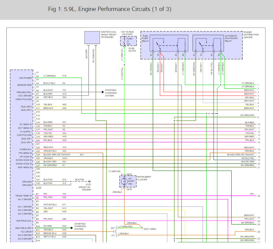

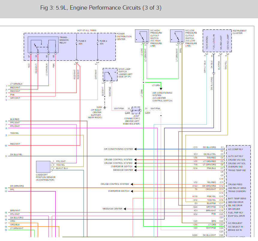

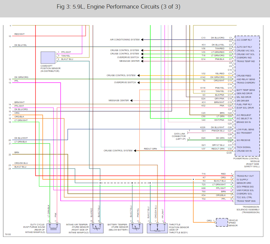

I have a fuel pump shutoff and electrical problem, I have replaced five fuel pumps to no avail. Fuel pressure at rail is 49 PSI, yet when key is turned on fuel pump runs and does not shut off at prescribed pressure of 49-50 PSI. If I cycle the key say 25 to 50 times giving a six second delay between cycles eventually the fuel pump will stop after the key is energized and the truck will start and run fine. But, after it is shut off and cools the cycle starts all over. Another symptom is that while the truck is in a no start condition I get a Data Link Error on the code reader (Autel). But as soon as the problem clears, Data Link is restored and no codes. I have replaced five pumps, purge valve, vapor canister which was bad, all eight injectors and fuses.

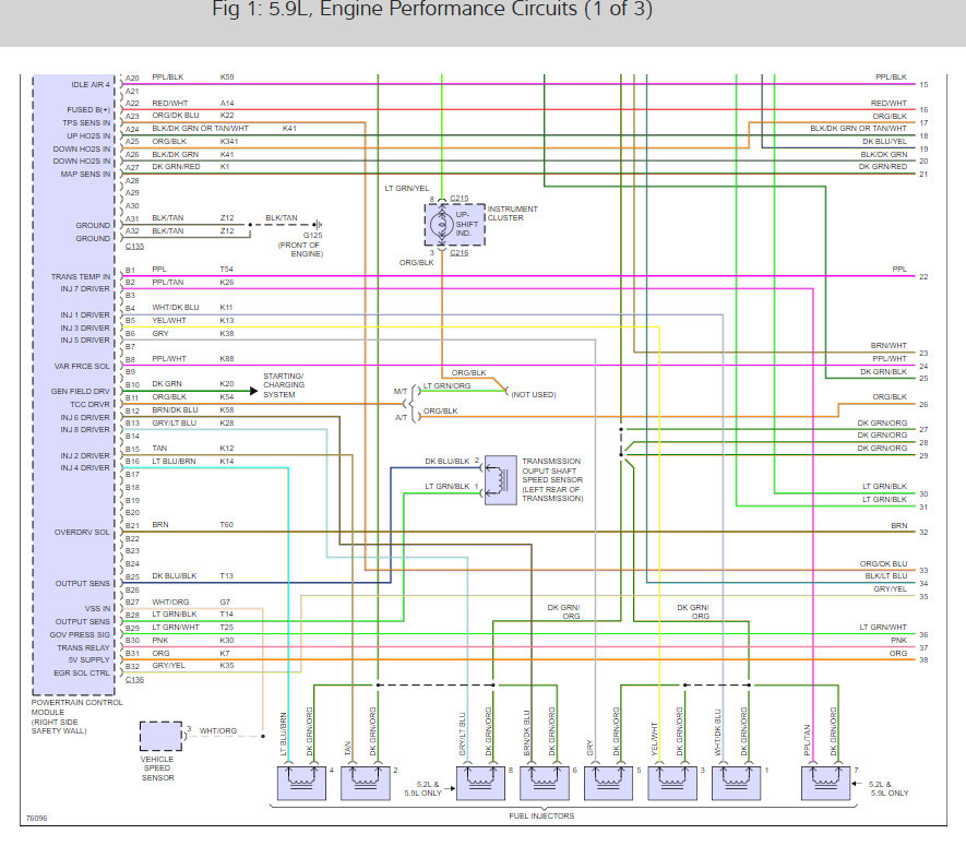

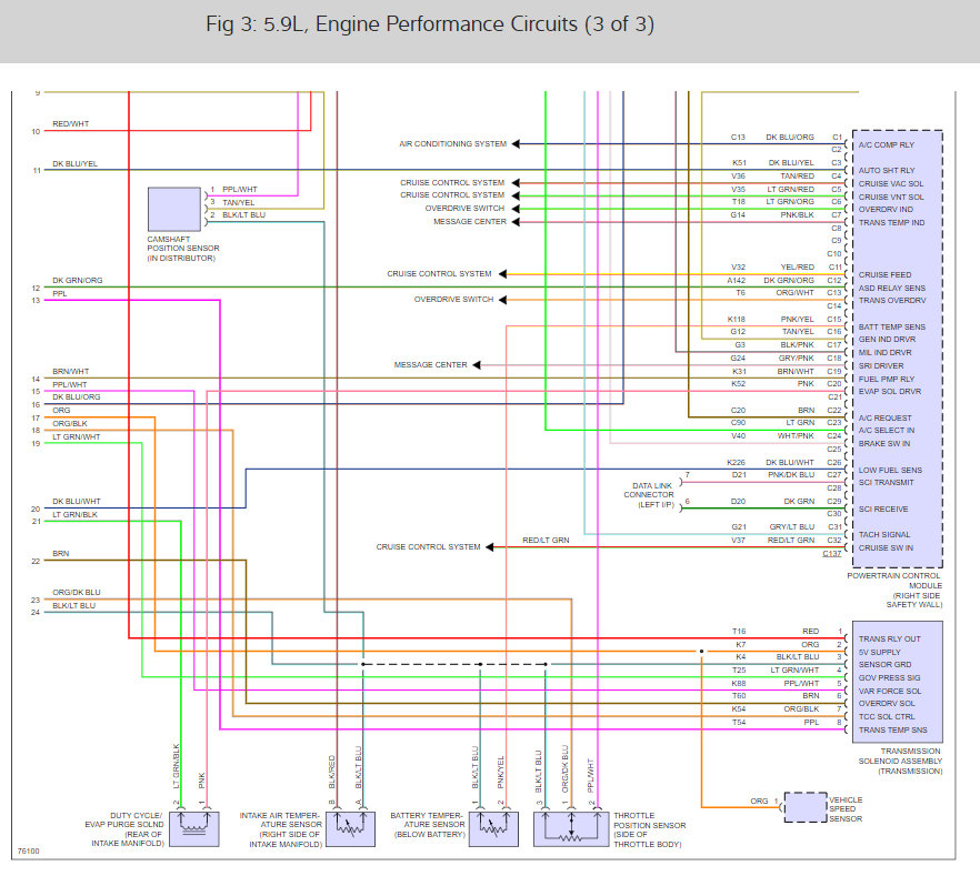

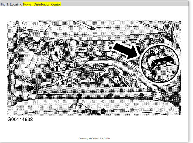

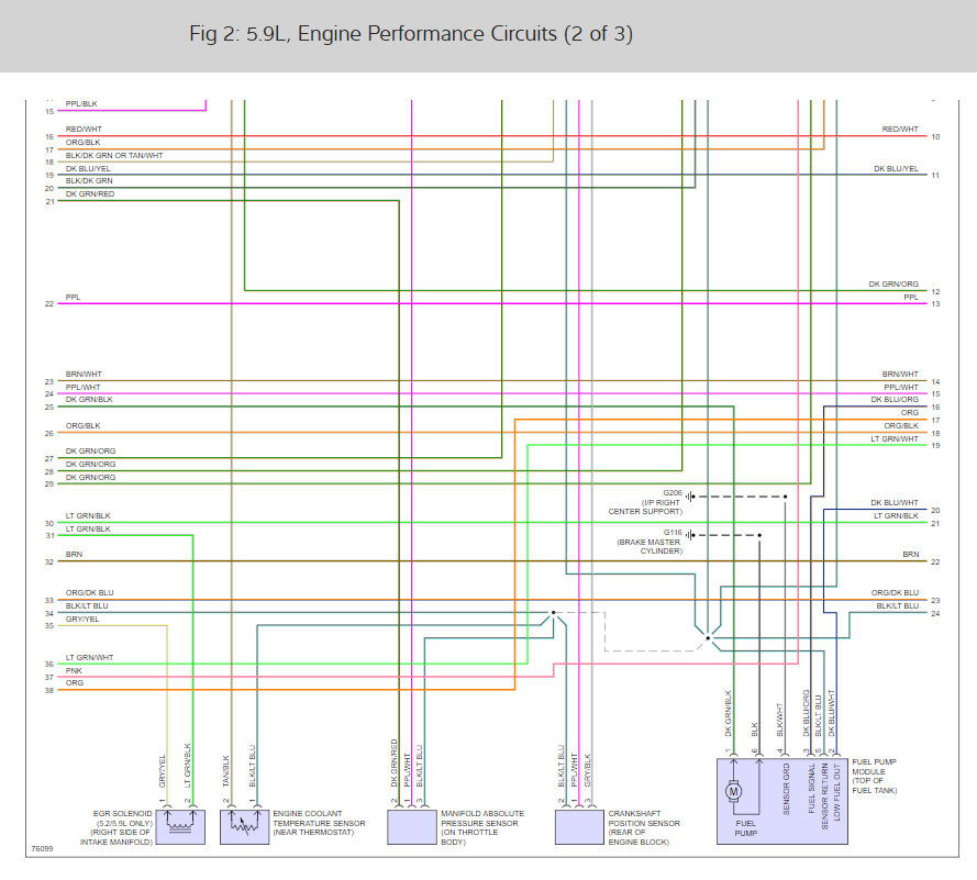

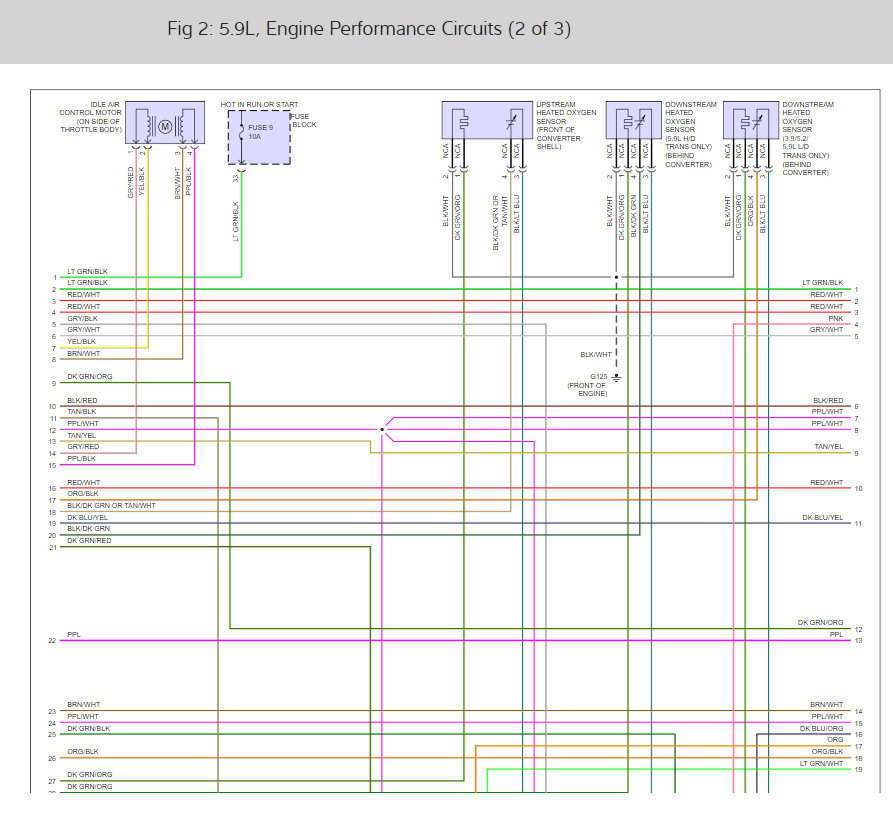

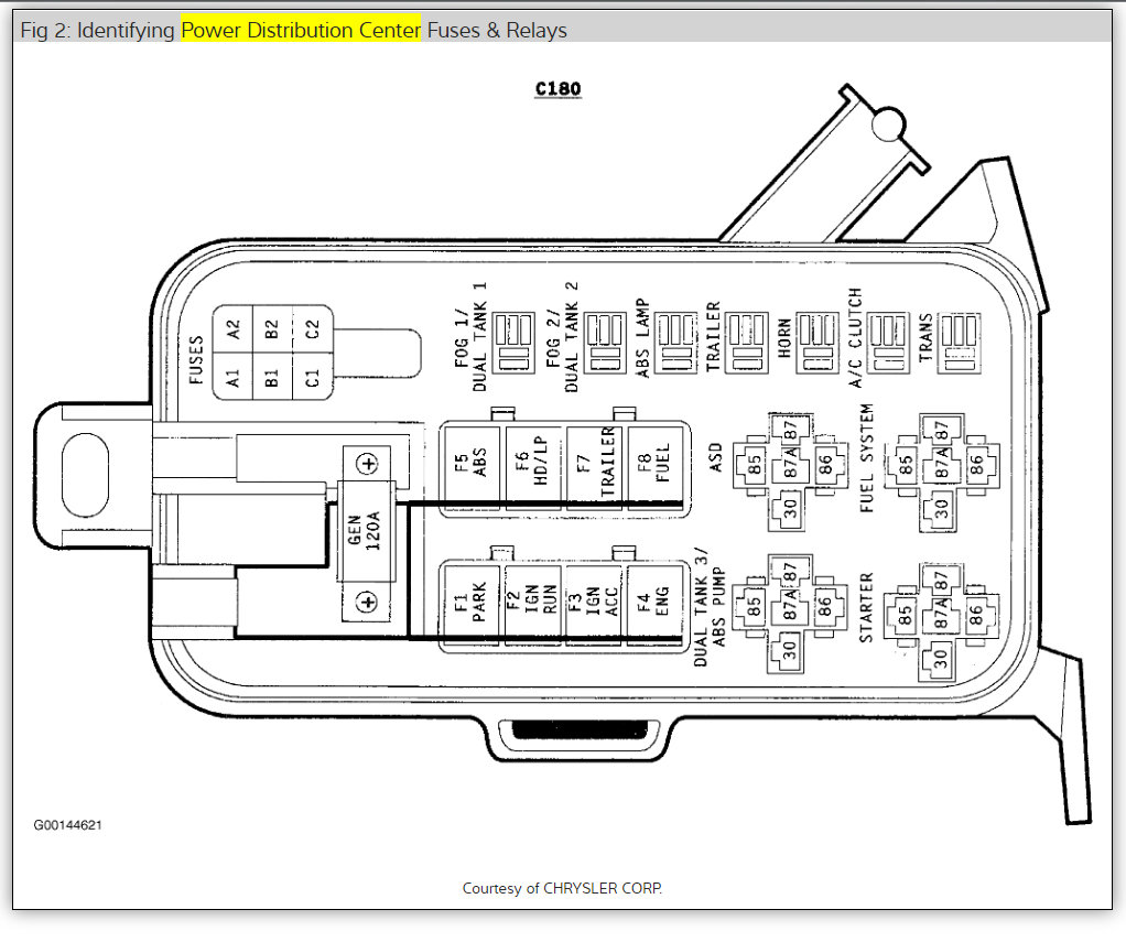

Two things come to mind which are the fuel pump relay and auto shutdown relay. I would remove them to check for heat damage. Also here is a guide that can help you test them and the location of the relays also I have included the engine wiring diagrams so you can see how the system works:

Both relays? If so please bypass the fuel pump relay (hot wire) to see if the truck starts and runs okay. Connect terminals 30 and 87.

Bypassed the fuel relay 87 to 30 and it just turns the pump on as if the relay was there and the key was on. Still not turning on coil and injectors.

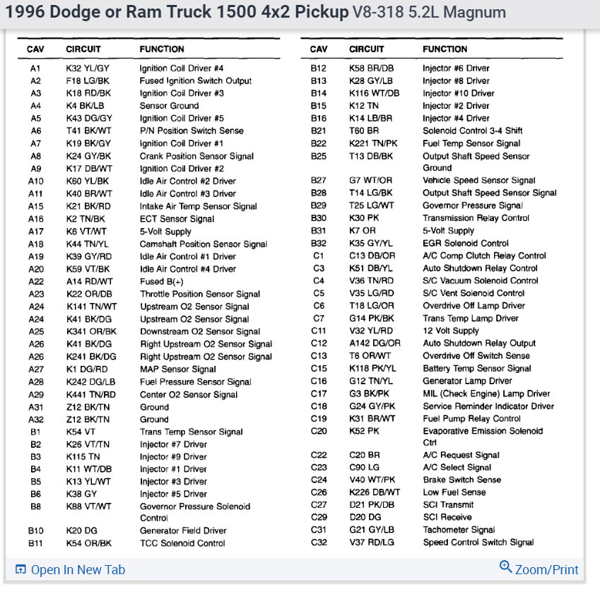

Can you do the same with the ASD relay? It sounds like the PCM maybe bad. Lets use this guide and the wiring diagrams from above to check the wiring.

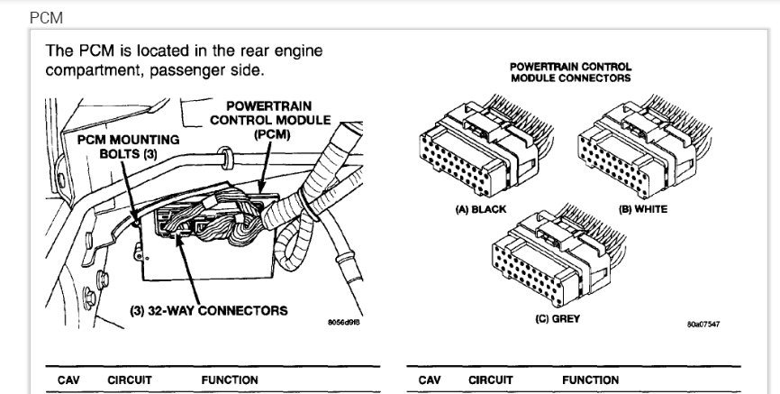

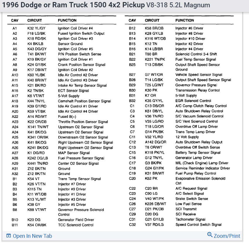

If everything checks out I would get a used PCM and replace it. Here is the location and pin out for the computer

The data error code is making me think the PCM is bad. If you bypass the fuel pump relay does the fuel pressure stay good and not fall off?

Yep the link error is telling us the computer is having a problem if you have check the wiring I would say the PCM has gone out. I would try a used one and plug it in to see what happens.

Ken, you were correct. The Re man ECM arrived pre-programmed today. I spent an entire five minutes installing it. Said a prayer and turned the key to the on position. The fuel pump primed and shut off as it should so I turned the key to start and it started immediately. It would not idle at first but after keeping it running for one minute with the accelerator until all the fuel components could properly charge and get rid of the air, and also the ECM could make adjustments, All is well. Runs like a champ! Thanks again my friend!
