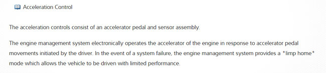

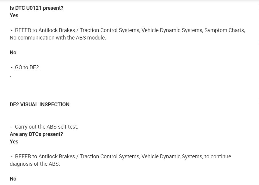

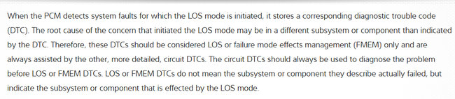

This sounds to me like your vehicle is in "limp mode".Do you have any Direct Trouble Code(s) present? These are set when there is a problem with a vehicle system. If one is set the Malfunction Indicator Lamp (MIL) or "check engine" light will be on. Please go to these links down below:
https://www.2carpros.com/articles/reduced-power-limp-mode
https://www.2carpros.com/articles/engine-has-low-power-output
Please go through these guides. I have also included in the diagrams down below a description of "limp mode" and how it operates on your vehicle. Get back to us with what you are able to find out, please.

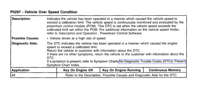

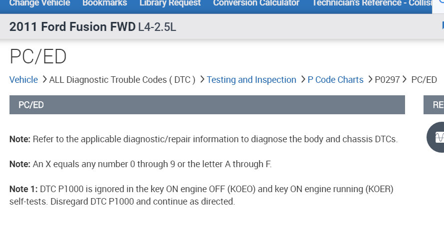

I had the vehicle checked for codes since the check engine light was on and it gave me two codes. One was P0420 and the other was P0297.
Dec 2, 2020 at 8:26 AM (Merged)
SCGRANTURISMO
  • 4,897 POSTS

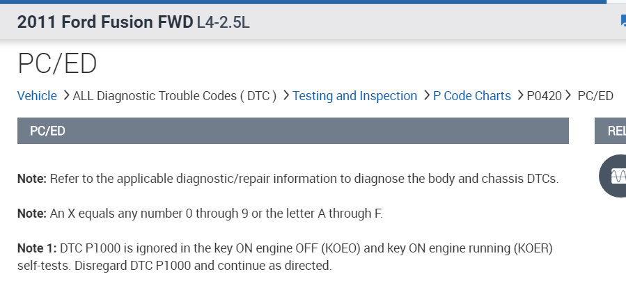

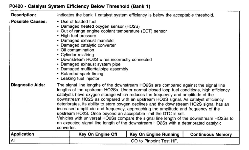

DTC P0297 is for vehicle over speed. DTC P0420 is for catalytic converter below useful threshold. This DTC sets when your catalytic converter, through normal wear and tear, wears out and needs to be replaced. I have included a link below for you to go to.
https://www.2carpros.com/articles/catalytic-converter-replacement
I have also included in the diagrams down below an explanation and diagnostic troubleshooting for both DTC's. Please go through these guides and get back to us with what you are able to find out.

P0297. Is that the powertrain control module?
SCGRANTURISMO
  • 4,897 POSTS
Hello again,

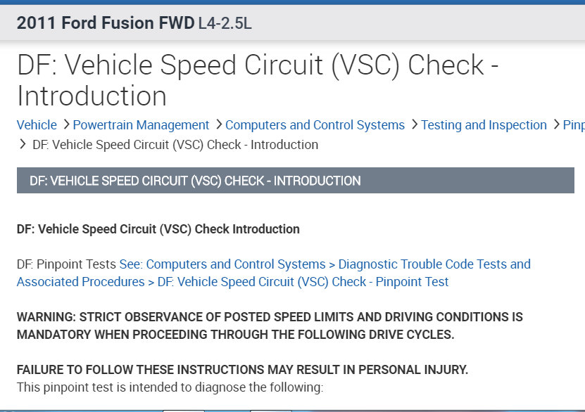

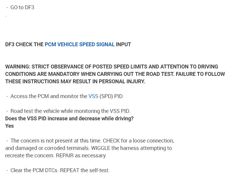

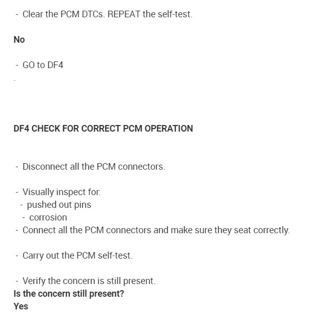

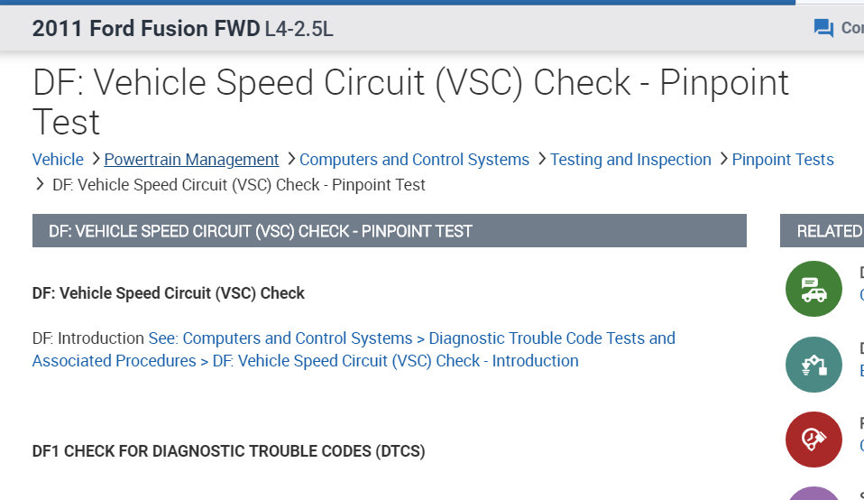

Yes. It has detected that the vehicle has gone faster than the set governed speed programmed in the PCM. This could be from the vehicle that the PCM came out of. I have included in the diagrams down below a pinpoint test for your vehicle's Vehicle Speed Sensor (VSS) just to be sure. Please go through these guides and get back to us with what you find out, please.

Can the P0420 cause or be related to P0297
SCGRANTURISMO
  • 4,897 POSTS
Hello again,
No. These are two separate issues. P0420 is a common DTC that is seen quite often and just happens with age to catalytic converters. P0297 is a DTC that is rarely seen and only happens when someone is hot rodding or in a chase or something along those lines, but they are not at all related to one another.

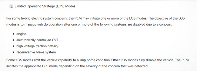

JOE BABBEL
On my Hybrid the check engine light will turn on randomly and all of the sudden the car loses power and will not accelerate. We have tried resetting the battery and then it will drive. But the check engine light seems to come back when it wants and then I experience the same issue. Any advice?
STEVE W.
  • 15,145 POSTS
Hybrids are in a realm all their own. The CEL (check engine light) could be related to either the mechanical engine systems or the electrical system. Really need it to be put on a scan tool to see what the code(s) are related to. Then form a plan from that.
From the description it sounds like the issue is causing it to enter limp mode.
