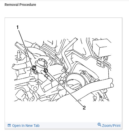

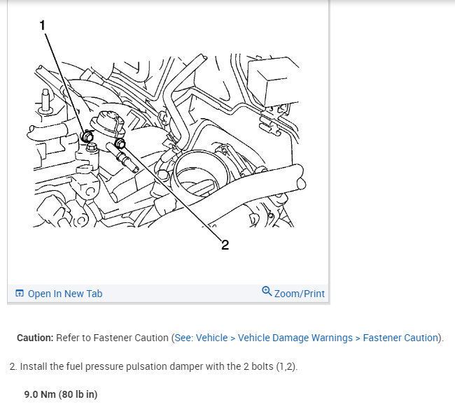

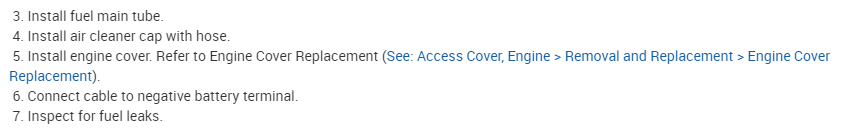

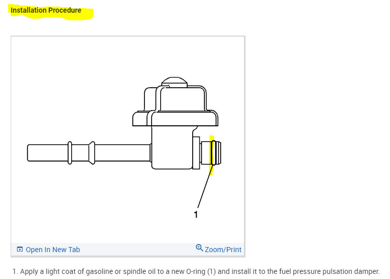

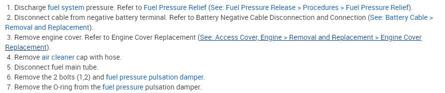

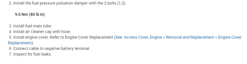

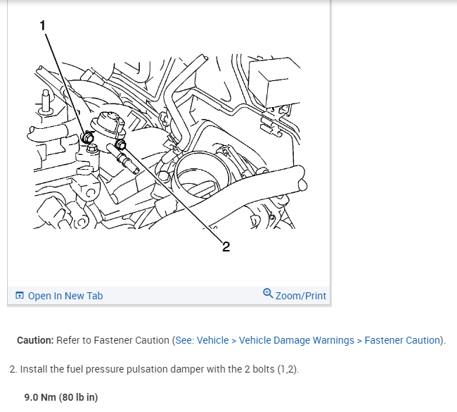

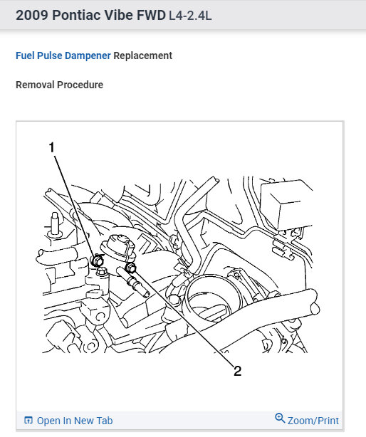

The fuel pressure pulsation damper is mounted to the fuel rail. I attached the directions below for removal and replacement which include pics.

I was able to find an exact match fuel rail for my car. Does the damper pull out or twist out from the rail? I took off the 2 bolts but it's still really tight in there and I don't want to damage the fuel rail.
Wednesday, March 15th, 2023 AT 10:13 PM
  • 110,194 POSTS

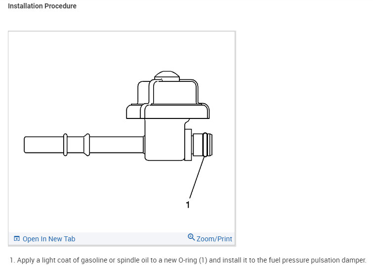

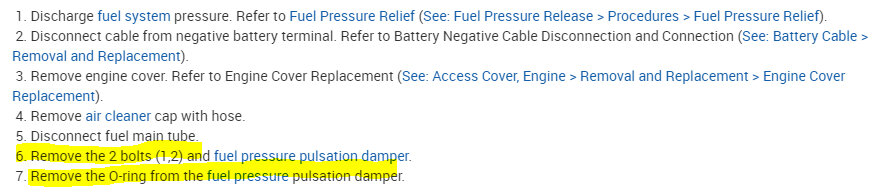

There are only the two bolts. Once they are removed, you will gently twist the damper while pulling it out. There is an O-ring that will need replaced. Make sure to lubricate it before you install it per the directions I attached below.
If the damper is extremely tight, you may want to spray a good penetrating fluid where it is attached. Corrosion can build up and cause this to happen.
Let me know how you make out. Also, I attached the directions below.

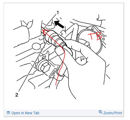

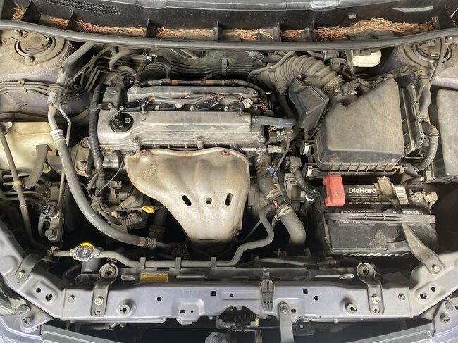

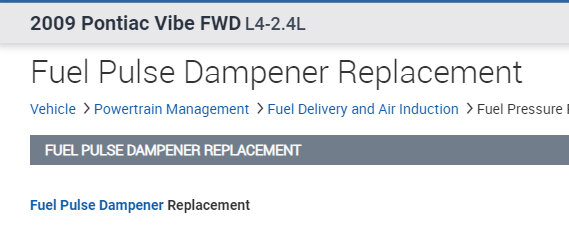

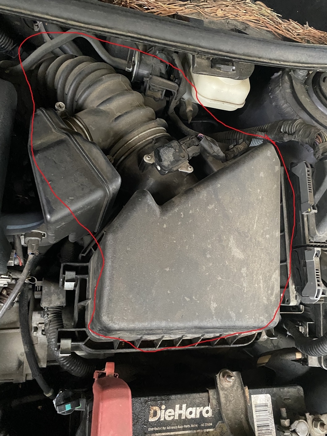

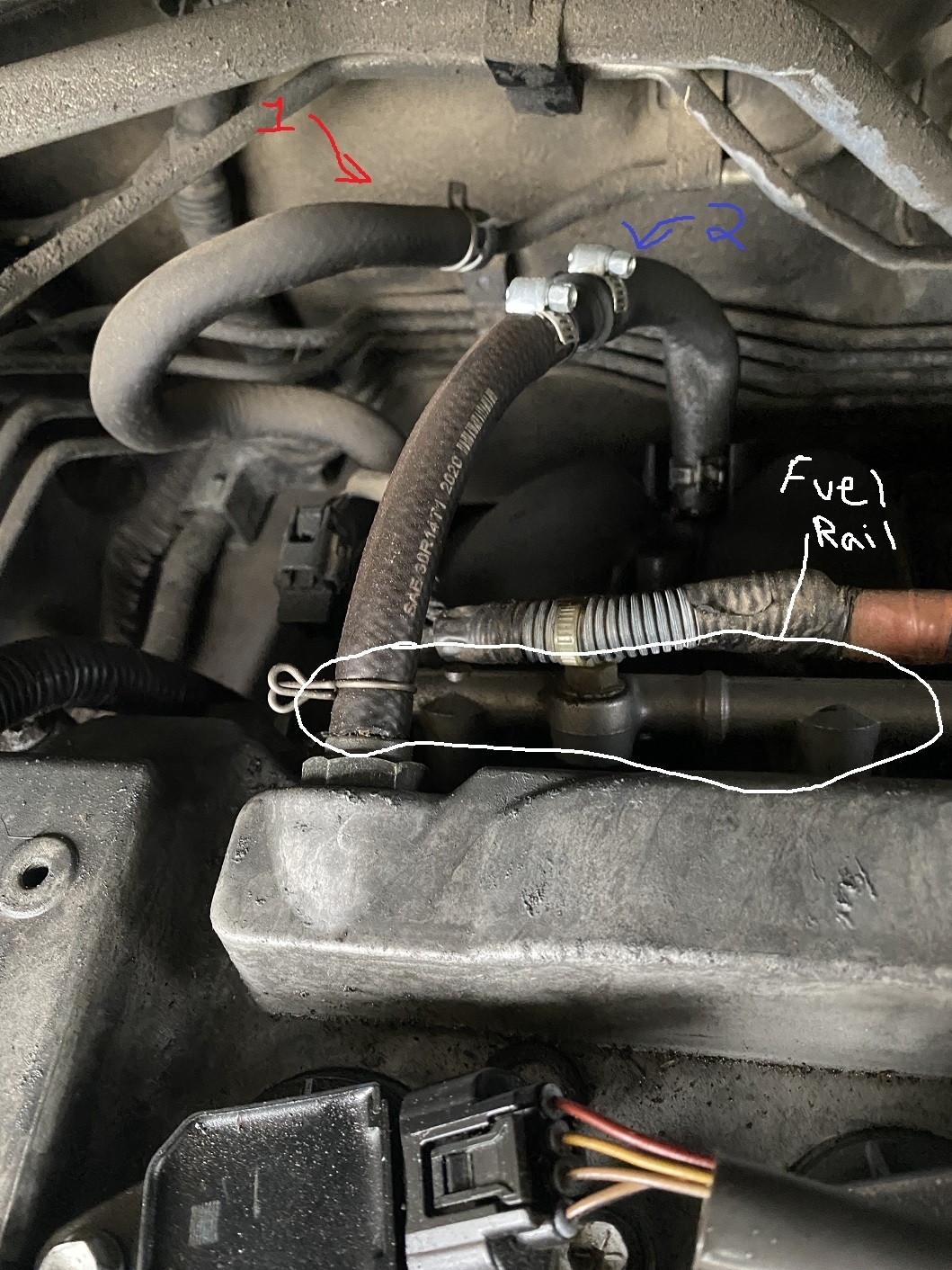

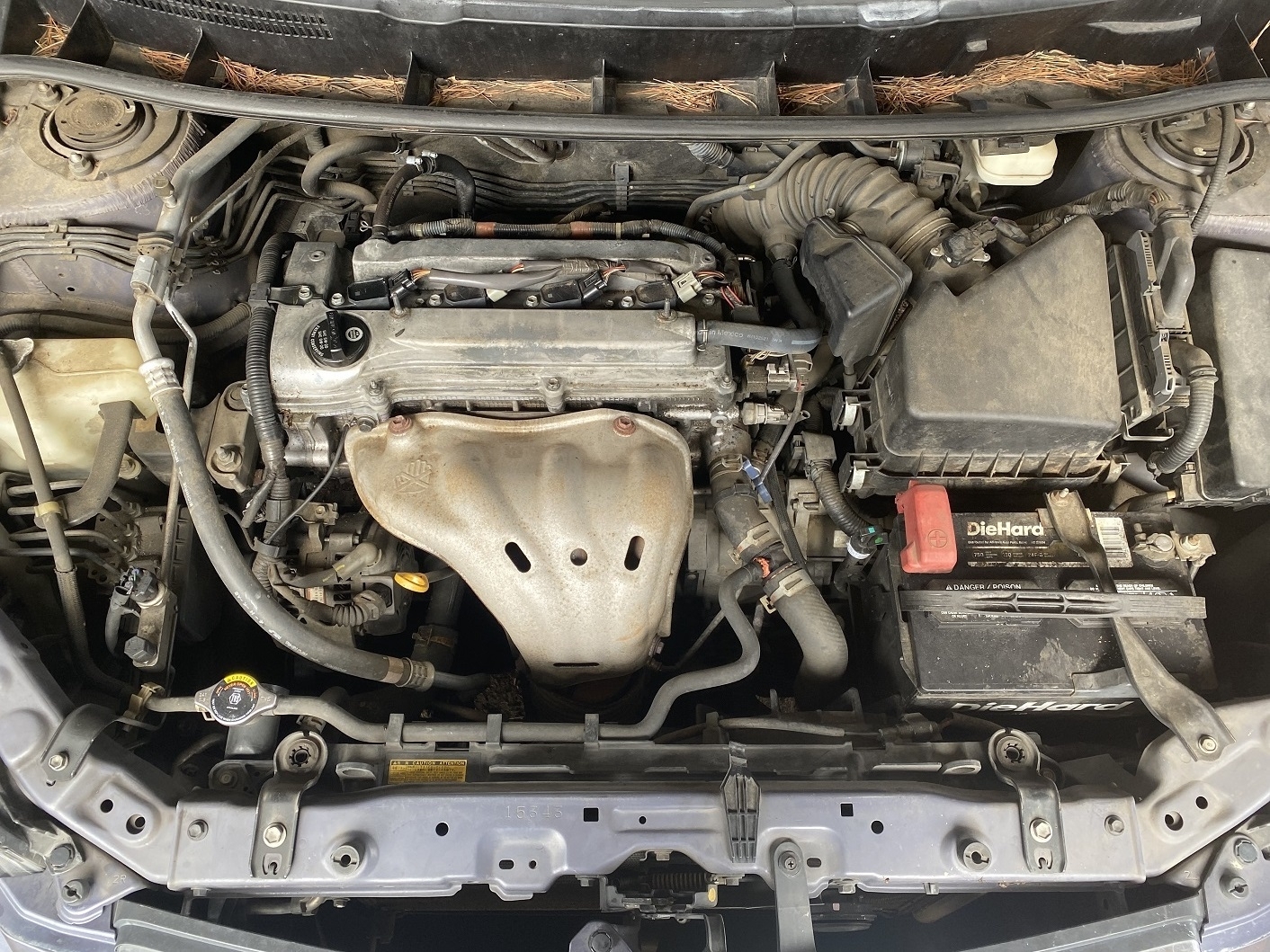

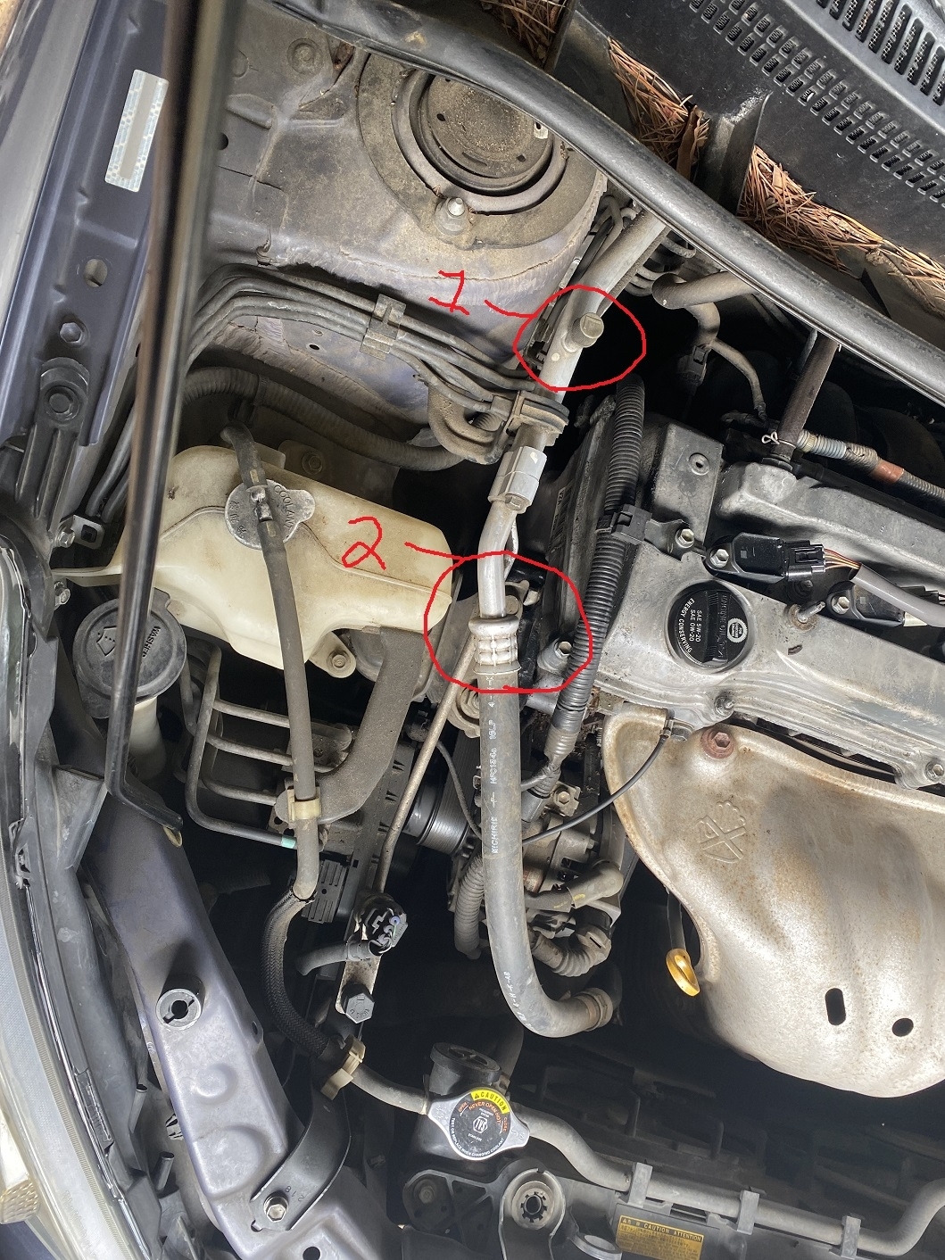

It says to disconnect fuel main tube and remove air cleaner cap with hose. I uploaded some pics. Which one is the fuel main tube in picture 1. And is that the air cleaner cap with hose in picture 2?
Friday, March 17th, 2023 AT 8:10 PM
  • 110,194 POSTS
Yes, to pic 2. As far as pic 1, I am having a hard time acclimating myself as far as positioning. There should be two, a supply and a return. What is causing me trouble is the positioning. Also, it appears someone has changed the connectors.
In the pic, number 2 appears to be a vent tube (PCV) for the engine. Is that attached to the valve cover? If so, that isn't what we are looking for.
I found a very generic pic of the supply line and attached it below. Note the quick connector and not the location of the throttle body (I put TB on it).
Do you see anything in that area that looks like the picture?
See pic below.
Friday, March 17th, 2023 AT 9:14 PM
VIBINGJAY
  • 7 POSTS

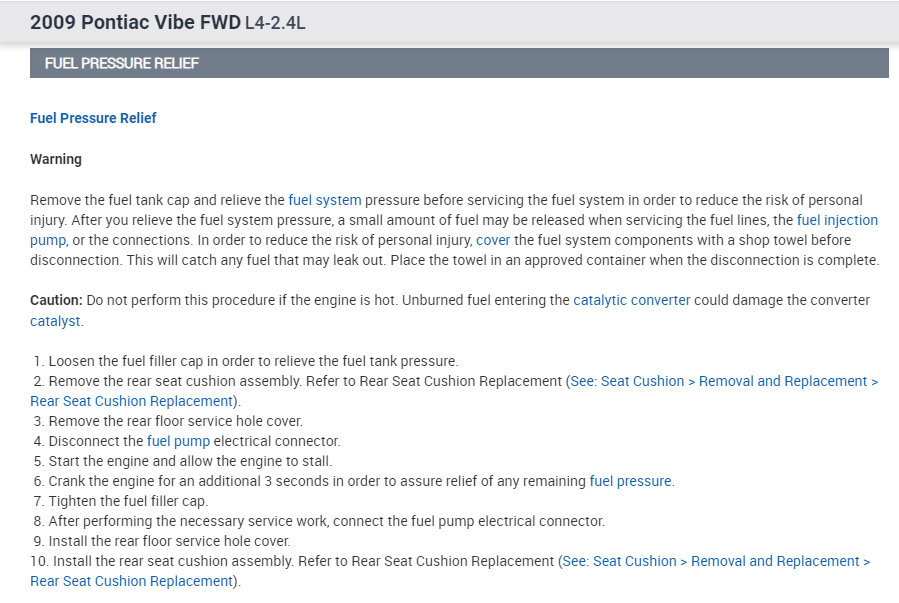

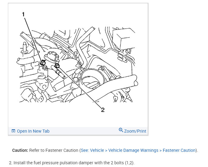

Okay, I think I see it now. I updated the pictures. So, do I discharge the fuel pressure where I circled #1? And then disconnect the fuel line where I circled #2?
Saturday, March 18th, 2023 AT 7:36 AM
  • 110,194 POSTS
That is the air conditioning pressure line. Don't discharge or remove it.

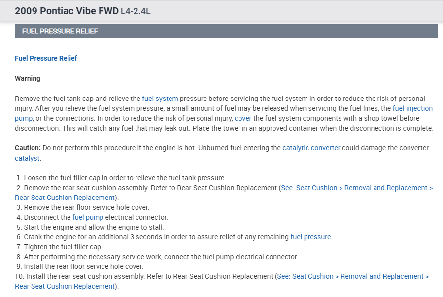

As far as releasing the pressure, the manual indicates to access the fuel pump through a port in the floor under the rear seat. The pump is disconnected from power and then you start the engine and allow it to run until the fuel runs out. See pic below.
The concern is the fuel pressure. It will spray fuel if not done this way. You could wrap the damper with a towel and slowly remove it. The towel should catch the fuel. Just protect your eyes.
Saturday, March 18th, 2023 AT 2:54 PM

Can I remove the 'fuel pump relay' fuse under the driver’s side fuse block and then start the engine? Would that work as an alternative?
Saturday, March 18th, 2023 AT 5:32 PM
  • 110,194 POSTS
It absolutely should. LOL Why didn't I think of that? I suspect I'm just getting old. LOL
