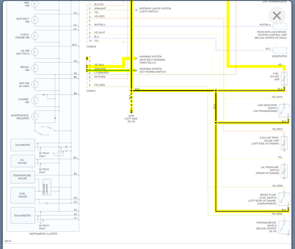

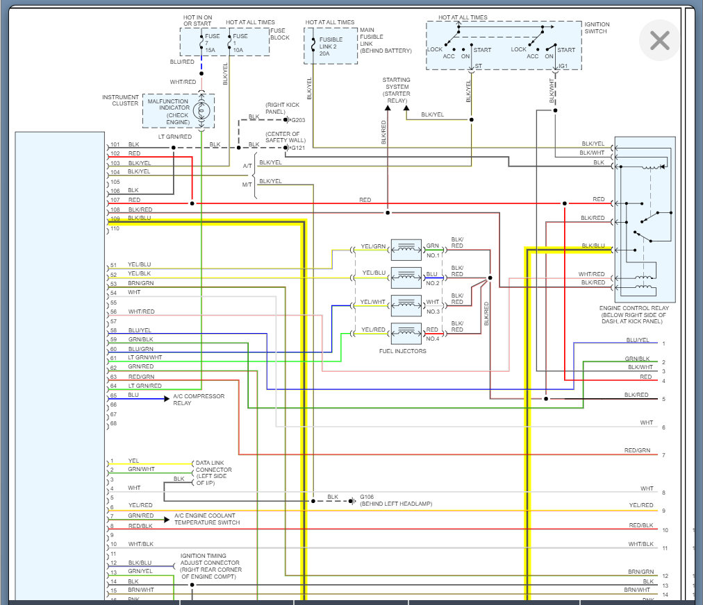

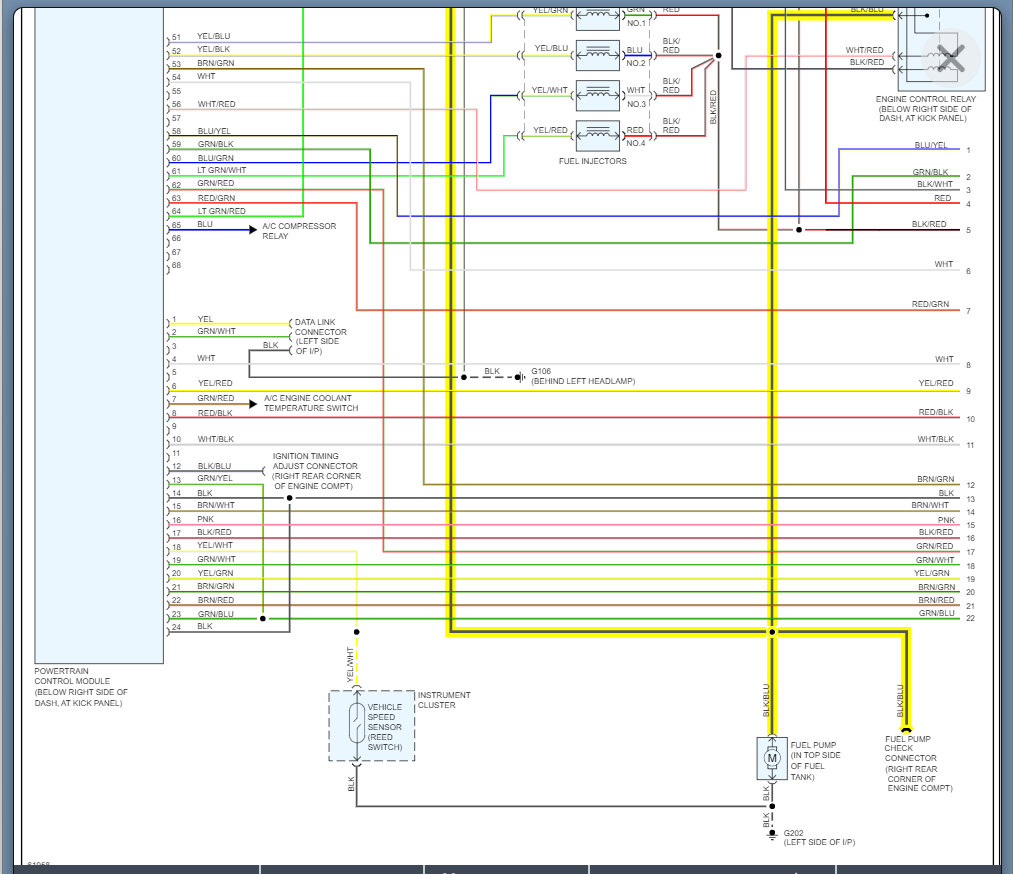

Need the wiring diagram colors for the fuel pump and the fuel sending unit from the tank.

I will attach the wiring info below. However, here are a couple of guides that will help with this info:
https://www.2carpros.com/articles/how-to-replace-an-electric-fuel-pump
Please see the info attached and let me know if you have questions.

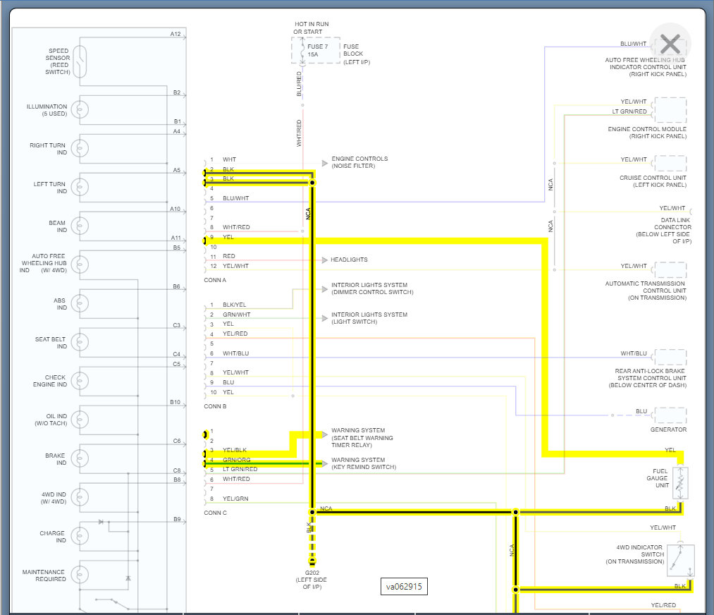

Kenny, now I need the wiring for the fuel sending unit. What colors are they?

Sorry. I didn't include that as they have it separate in the cluster section on this vehicle.
Here is the fuel gauge unit diagram.
