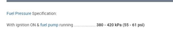

Can you hear the pump run when you turn the key to the on position?
You need to check the actual pressure. You can rent a tester at a parts store and the fitting is right by the distributor.
https://www.2carpros.com/articles/how-to-replace-an-electric-fuel-pump
Image (Click to make bigger)
