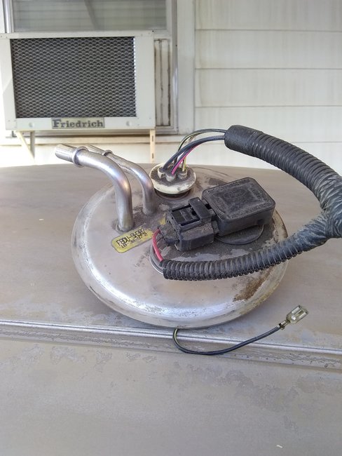

The is a picture of the old pump I still have to drop the tank but the only one does not have the prongs it just has a plastic push connection and the electrical connectors is the same on both even same middle number.

I pulled a fuel pump, assembly and all, from a 1998 Ford Taurus and installed it in a 9198 Ford Taurus. I noticed that the top of the fuel pump itself has a different connection one has two prongs the other has a single plastic push in one. But the rest of the assembly is identical and all hoses and lines and electric connectors connect fine. I tested the pump and heard it working before I installed it but now that it is in I get nothing. I just want to know if I have a non-compatible pump in or if it could be something else before dropping this tank for the fourth time.

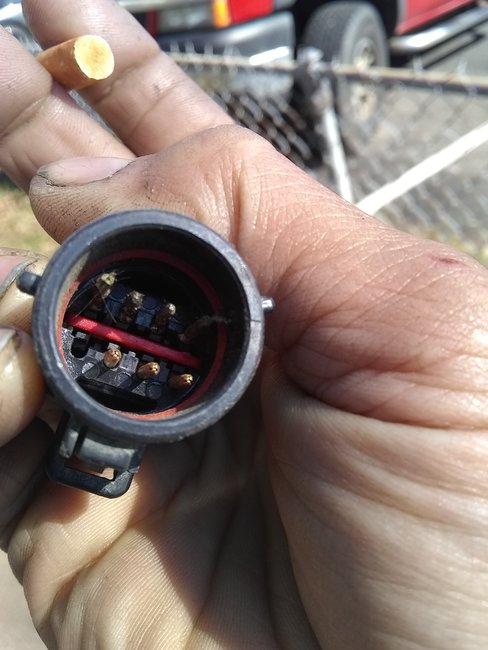

By prongs I mean the electrical connectors on the fuel pump. And I tested it by putting wires on my car battery then carefully touching them to the ground and hot points in the electrical connector in this picture.
Tuesday, March 20th, 2018 AT 2:26 PM
Okay, what does the car harness connector look like?
Tuesday, March 20th, 2018 AT 2:42 PM

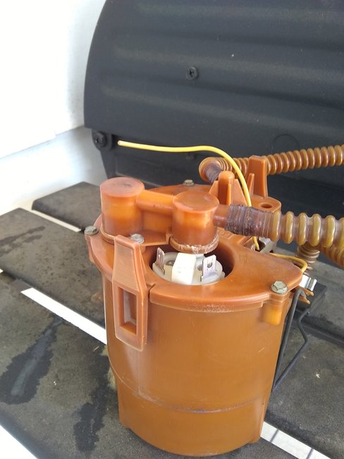

It is this.
Tuesday, March 20th, 2018 AT 2:50 PM
That is which pump?
I need a picture of what the fuel pumps plug to.
