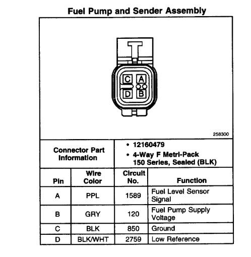

The car listed above has a Northstar motor. When trying to replace the fuel pump the wires on the plug for the modulator sending unit became unplugged.

I attached a picture of the connector which includes pin identification, wire color, and what each wire is for. Let me know if this is what you needed.

Helps somewhat. Can I get a diagram of a fuel pump for 2001 Cadillac Seville Northstar fuel pump replacement? Need to rebuild one so need the break down of components.

The ECM or level sensor has separated from the main fuel suction motor and not sure what wires go where on the 4 pin plug fof level sensor on replacement.
