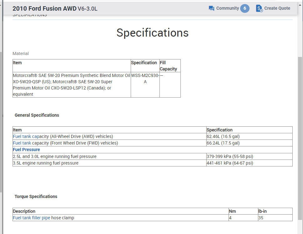

Speck fuel pressure for the car listed above SE.

I attached the spec below for your review.
Also, here is a guide as well that will give step by step instruction on how to check the fuel pressure in case you need this:
Please review this data below and let me know if you have other questions. Thanks
