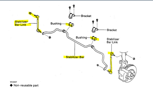

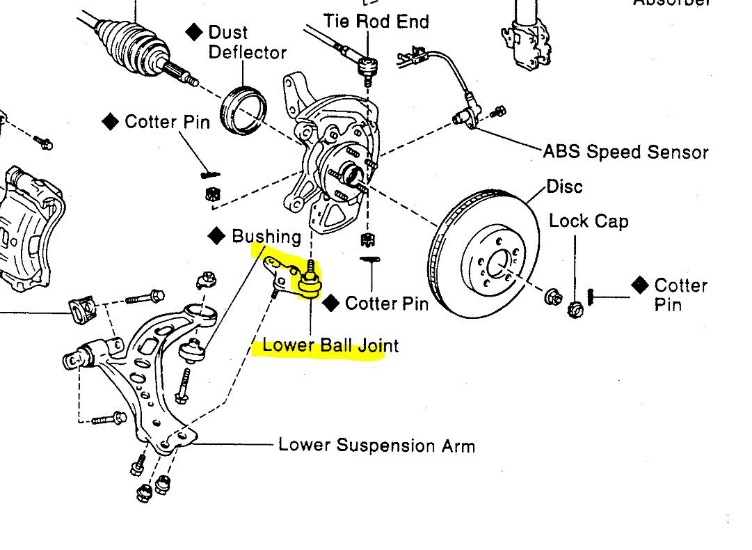

Have you checked the ball joints? Also, am I correct is understanding it happens on a smooth surface and doesn't require bumps to cause it? Is it loud enough that you could record it and upload it for me to hear?
I attached two pics below. The first one shows ball joint location. Simply lift one front wheel at a time and place your hands at 6 and 12 o'clock and see if there is play in the joint.
The second pic shows the stabilizer bar in the front. Make sure the stabilizer pins are not loose / worn. Also, take a pry bar and check for excessive play in the bushings on the bar as well. When checking the pins, the vehicle should be on the ground.
Let me know what you find.

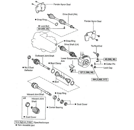

I've replaced the front wheel bearing, ball joint (lower), and outer tie rod, but when driving I can hear and feel a popping or clunking noise from the passenger side front wheel. I took the wheel off and used a pet bar to test for play in the lower control arm, sway bar and link, tie rod and found everything seems right. I can slightly turn the CV axle and it will move in and out slightly, but I'm at a loss as to what it could be. The noise only occurs when the vehicle is in motion (around 15 mph and above).
Sunday, August 2nd, 2020 AT 5:52 PM (Merged)
Good evening,
This sounds like a CV joint in the axle since it happens when you are moving. The joint may be worn out and the bearing could have play and is scored.
https://www.2carpros.com/articles/popping-noise
I would suspect the CV shaft would have to be replaced.
https://www.2carpros.com/articles/symptoms-of-a-bad-cv-axle-joint
https://www.2carpros.com/articles/how-a-cv-joint-works
https://www.2carpros.com/articles/replace-cv-axle
