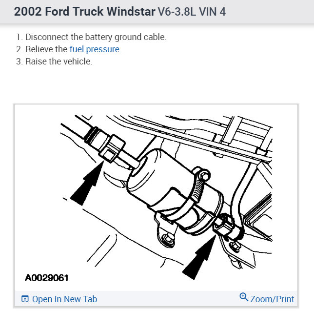

Hi:
This fuel filter is under the car in front of the fuel tank. Here is a guide to help you step by step with instructions in the diagrams below to show you how on your car.
https://www.2carpros.com/articles/how-to-change-a-fuel-filter

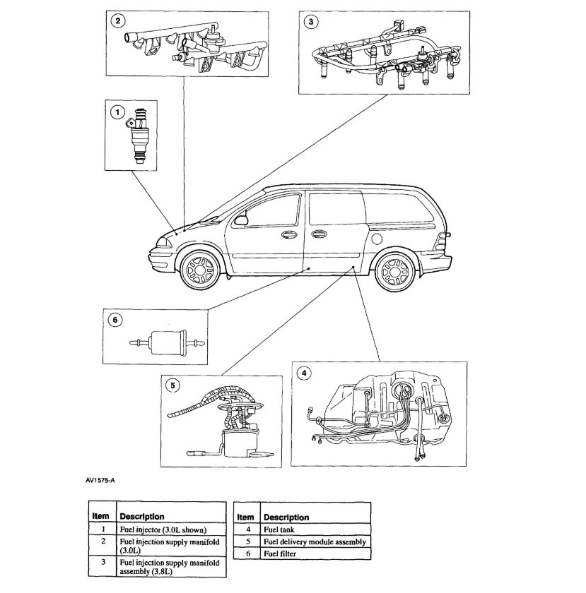

Where is the fuel filter on a1999 ford windstar
+1
Thursday, November 12th, 2020 AT 4:17 PM (Merged)
JDL
  • 16,098 POSTS
My info says it is under the vehicle along frame-rail, ahead of fuel tank. Make sure there is no pressure on the fuel system before taking any lines loose.

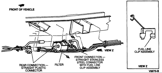

Where is the fuel filter located on my 1999 Ford Windstar Van with 3.0 motor? Is it a DIY replacement or must I take it to a shop?
Thursday, November 12th, 2020 AT 4:18 PM (Merged)
SERVICE WRITER
  • 9,123 POSTS
IF you have patience and time, you might be okay. There is a clip at both ends that needs to be removed to let the line come off. Then there is a bracket thaqt holds the filter there that needs to be removed.
The filter is along the left rear frame rail area.

  • 75,992 POSTS
https://www.2carpros.com/forum/automotive_pictures/12900_windstar_1.jpg
REMOVAL
Shut engine OFF. Depressurize fuel system, refer to Service and Repair / Fuel Pressure Relief Procedure .
Raise vehicle on hoist.
Remove fuel tube clip from stainless steel connector at forward (outlet) end of fuel filter. Remove steel push-connect fitting with fuel line disconnect tool.
Remove plastic push-connect fitting at rear (inlet) end of fuel filter.
Remove fuel filter from fuel filter bracket by either (a) pulling fuel filter toward the center of the vehicle, or (b) expand the fuel filter bracket slightly and slide the fuel filter forward and out of the bracket.
INSTALLATION
Install fuel filter in fuel filter bracket, ensuring proper direction of flow as noted by arrow (toward engine). Align seam in filter with corresponding groove in fuel filter bracket.
NOTE: The "flow" arrow direction should be positioned as installed in bracket to make sure of proper flow of fuel through the replacement filter.
Lubricate O-rings in connectors with engine automotive oil. Install push-connect fittings at both ends of filter. Install new retainer clip in plastic push-connect fitting. Pull back on connectors to ensure the connector latch is fully engaged.
Reinstall existing fuel tube clip to stainless steel push-connect fitting at forward (outlet) end of fuel filter bracket.
Lower vehicle.
START engine and check for leaks. Repair as necessary.

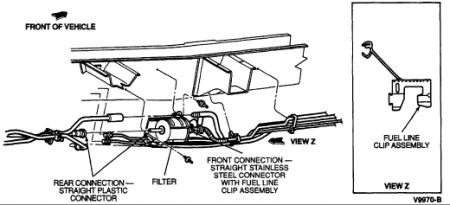

I have a 1998 ford windstar van. I think that I need to change the fuel filter, as the van is sputtering each time that we start it. I was wondering where the fuel filter is located, and if this is in fact the problem with my van.
Thursday, November 12th, 2020 AT 4:19 PM (Merged)
MFACDGBA33
  • 5 POSTS
The fuel filter is under the right rear of the van but you will need a detachment tool to get it off you maybe able to used one at advanced auto for free as long as you do it in there parking lot. It isnt that hard and you might also have to relieve the pressure on the line before detachment.
