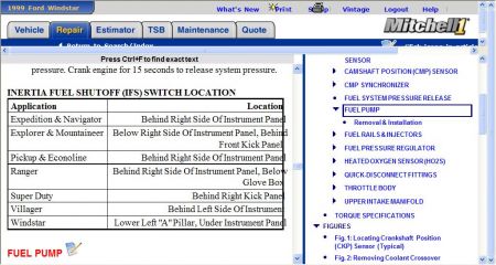

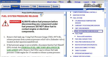

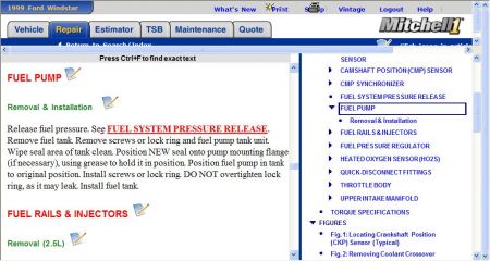

Please give me a step by step fuel pump r & R

See below
