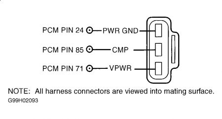

Back from another test drive and the news is not good. Didn't get 2 blocks before it died at the stop sign. Then it ran ok through 3 more stops. Then at about 40 mph it started "bucking" Then it died as I turned a corner. And again when I pulled into a parking lot.
On the way back it started bucking again at around 40 mph, and gave two codes P0340 Camshaft Position Sensor Circuit Malfunction and P0401 EGR Flow Insufficient Detected.
Now that could be caused by the hoses connecting to the DPFE hoses being reversed, but I did not get a P1403 DPFE Sensor Hoses Reversed.
So looks like the next thing to replace is the DFPE. But before I do that, I'll remove the vacuum to the EGR valve and plug it and do another test drive tomorrow.

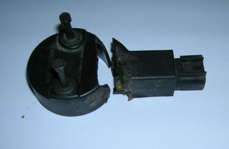

I wouldn't replace the DPFEGR sensor. It wouldn't resolve the issue as you describe. The DPFEGR monitors the EGR sensor's job. You already took the EGR out of commission by disconnecting the vacuum line. If it continued stumbling at idle with the EGR vacuum disconnected, then the EGR is not at fault; neither is the DPFEGR.
Since you received the P0340 CMP sensor malfunction code, I'd investigate that next. You might not have received this code earlier because Ford OBDII systems go through a series of component tests with each test drive. I cannot pinpoint at which priority level the CMP sensor falls into this heirachy. If a certain component fails the OBDII test (which the vehicle does on its own during test drives), certain subsequent tests abort until the failure is resolved. Since you have a scanner now, you should see a P1000 OBDII Test Not Completed. This will remain until all monitors pass their onboard tests. Having the constant engine stumbling and malfunction(s) may have caused the OBDII system to abort all subsequent tests. Perhaps the P0340 CMP sensor test was far down in the heirachy level and never had a chance to set. Now it finally did, so you may have a better lead to go on.
The Motorcraft website (again) has an excellent technical library. If you're up for some reading, go to the technical link and download the *. Pdf article for OBDII Theory and Operation. It is organized by vehicle year. Download the year 1999 section and see if there is anything relevant to your situation. If it all seems overwhelming and technical, don't fret. I've been studying this stuff for a few years now and am still catching on to how all this stuff operates.
The CMP sensor synchronizes fuel delivery for each cylinder. It's possible that it is failing intermittently, causing your engine stumbling. The CMP sensor has two parts: The plastic "cup" you see from the top, and an aluminum shaft hooking up to the cam gear extending far into the engine block. Take each one off seperate and be certain to note the position of both the aluminum CMP housing and also the half-moon rotating vane in relation to the CMP housing AND ALSO when piston #1 is on TDC. All the tech manuals indicate needing a special tool to synchronize the CMP upon installaion. Nah. Tool not needed. If you need the Shade-Tree Mechanic's instructions (they are easy and really do work) let me know. I'll type them out for you.
