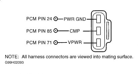

Ok first I am sorry that guy ripped you a new one that was uncalled for. I had you do the other tests to one rule them out and also it let me know that you are getting power to those sensors so it also rules out the PCM for now too. Now with that said lets look at the cam sensor. Use pic below to help with the testing. I am going to give you the test a step at a time if you don't mind. First unplug the sensor and then hook up you volt meter between the VPWR term on the wiring harness and ground. Turn key on engine off and note voltage. If more then 10.5 volts then wire is good it not find break in the wire. Now if you do have 10.5 volt or more then you to check the ground. Turn key off again and hook up you meter between pwr/gnd (pin 24) and ground and now you will measure ohms should be less the 5 ohms. Now if this checks out get back to me and we will go to the next step ok. You are not testing the sensor yet you are testing the wire harness that you unpluged ok. Here is the pic of the plug.
https://www.2carpros.com/forum/automotive_pictures/249564_Graphic_128.jpg
Thursday, September 3rd, 2009 AT 10:45 AM
