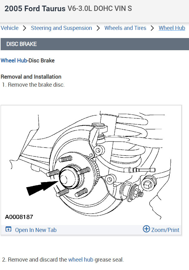

wheel bearing? What is this?. Transmission just change. New on built by a named service provider. And they said to get this checked.
Friday, December 7th, 2007 AT 6:56 PM
2 Replies
MERLIN2021
MECHANIC
17,250 POSTS
I think they may have said "wheel bearing" It's what helps the wheel spin, the axles go thru them and if there bad, the tend to growl a bit.
Friday, December 7th, 2007 AT 6:59 PM
KEN L
MASTER CERTIFIED MECHANIC
55,130 POSTS

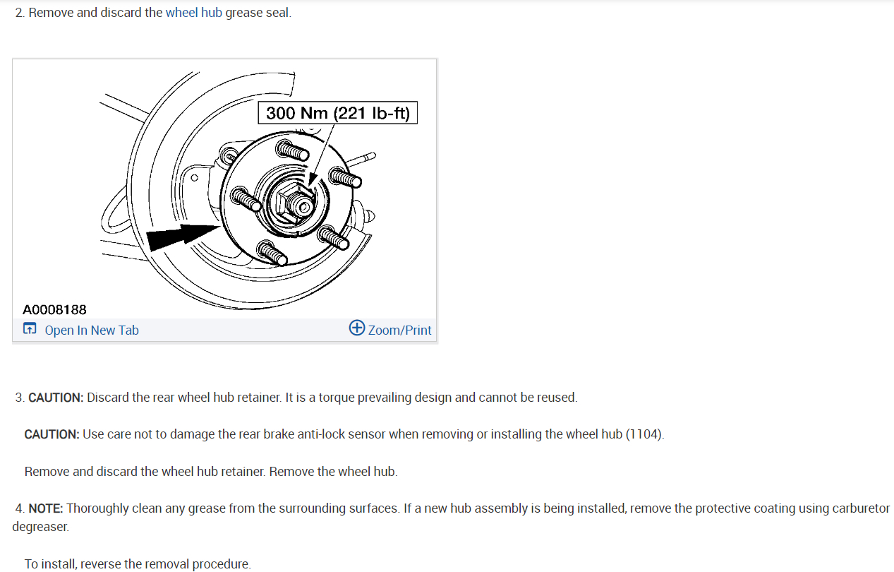

This is actually a bearing hub. Here is how to change them out on both sides. Check out the images (below). Let us know if you need anything else.
