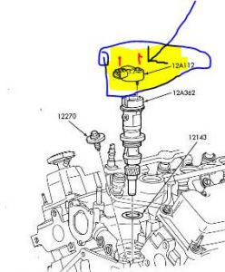

original question was where is cmp located and do I just disconnect the battery before replaceing. If the 8th letter in the VIN # is a S yes if not let me know.
Well the 8th letter is a U so what else is in volved in replaceing the cmp.
Tuesday, February 23rd, 2010 AT 6:54 PM
BMRFIXIT
  • 19,053 POSTS
Hit replay to question and that should take you back to the original question and this way you can keep track of what was said and we do too
CAM sensor takes place the distributor cap
and it sits on the Synchronizer
It's mounted on with two screws
