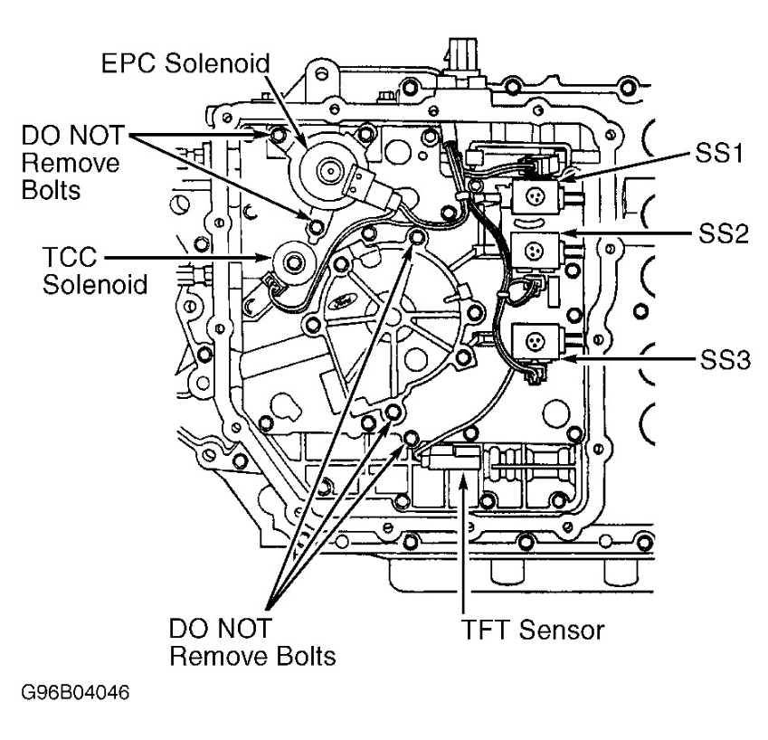

This issue could be due to an issue with the torque converter clutch solenoid. As it just all of a sudden got disengaged but is working again.
It is likely not the fuel pump. If it was the pump, then engine will not rev freely, and it would shut down due to fuel starvation.
Many times, with issues of this nature the check engine light gets illuminated. Is your check engine light on? If so, retrieving the code(s) can help with the diagnostics.

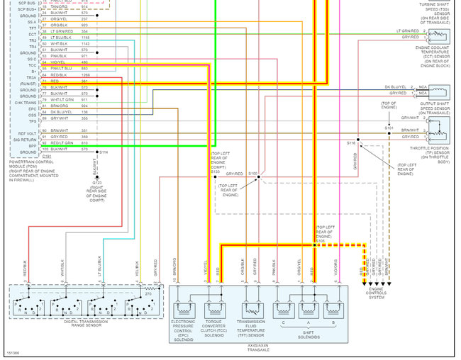

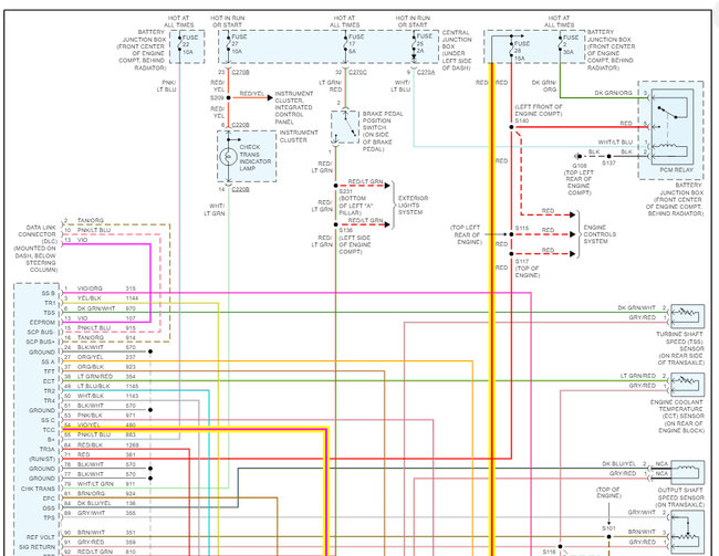

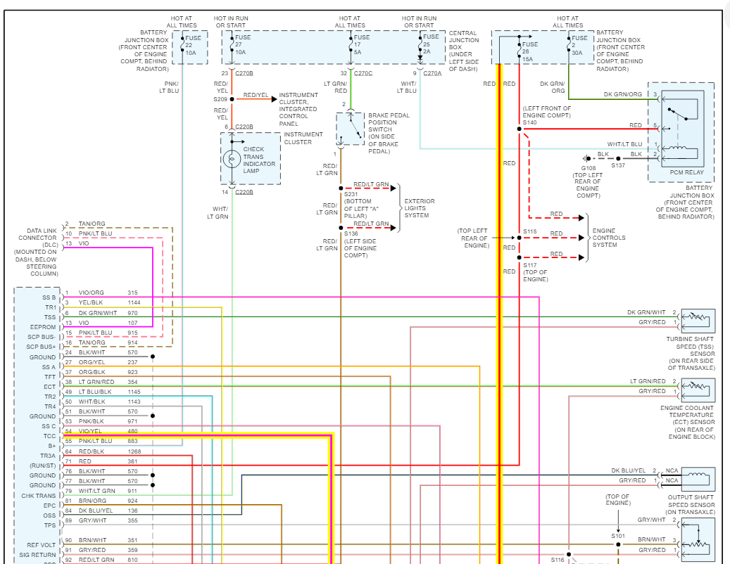

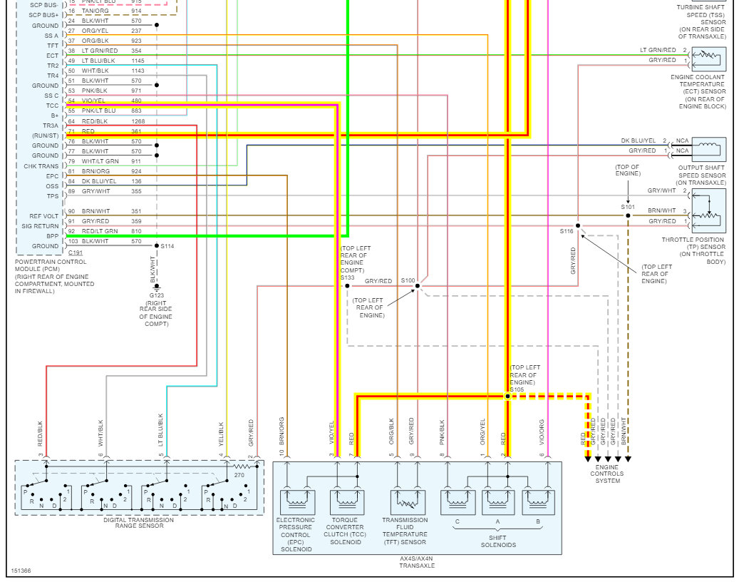

This could also be due to a wiring issue for the transmission control. Like a loose wire or melted connector.
I have included the wiring schematics below.
