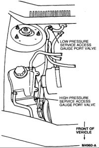

Where is the low pressure valve on a 1998 Ford Taurus?

The low-pressure service access gauge port valve is located on the evaporator to accumulator/drier suction line under the cowl panel near the A/C evaporator core outlet tube.
