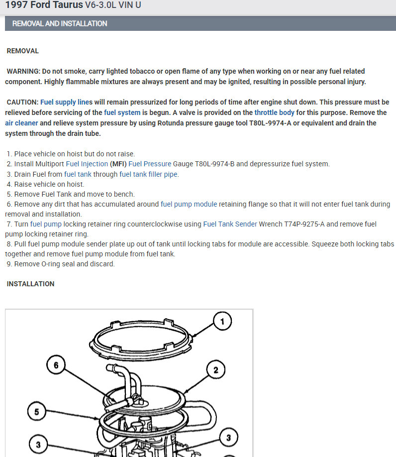

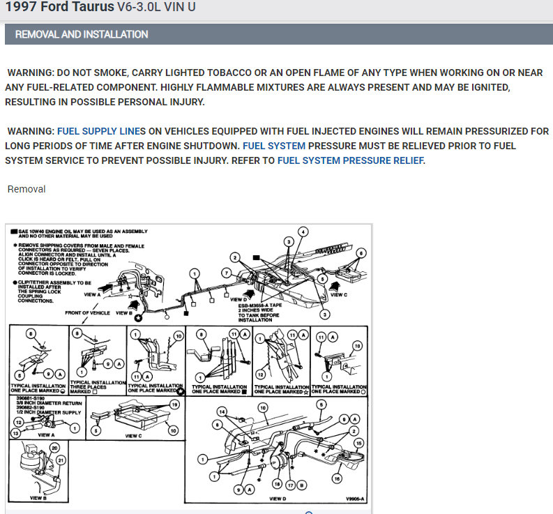

Where would I find fuel pump on this car and is it easy to replace and what average cast for this fuel pump.
Thanks
Monday, June 14th, 2010 AT 10:21 PM
SQM
MECHANIC
6,383 POSTS

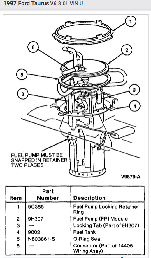

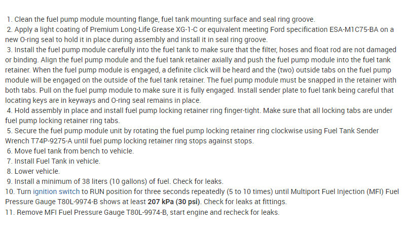

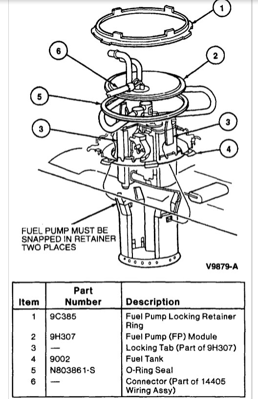

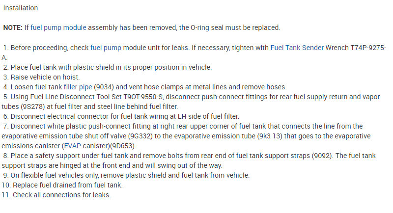

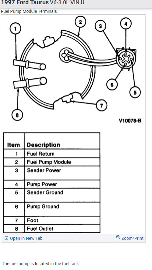

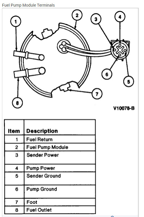

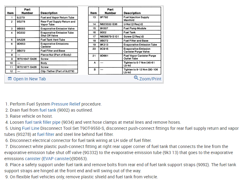

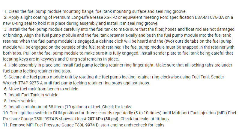

The fuel pump is located in side the fuel tank.
Here is a basic guide to fuel pump testing and replacement:
https://www.2carpros.com/articles/how-to-replace-an-electric-fuel-pump
See attached for the replacement procedure.
