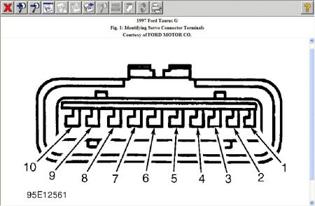

There are 20 procedures to check and I have them here for you. If you are not able to perform the testing, the following should provide your mechanic with sufficient data to diagnose the fault.
SYSTEM INOPERATIVE
1. Check Power To Servo - Unplug harness connector from servo. Turn ignition on. Using DVOM, measure voltage between pins No. 7 and 10 of servo connector. See Fig. 1 . If battery voltage exists, go to step 4). If battery voltage does not exist, go to next step.
https://www.2carpros.com/forum/automotive_pictures/192750_Cruise97Taurus01_1.jpg

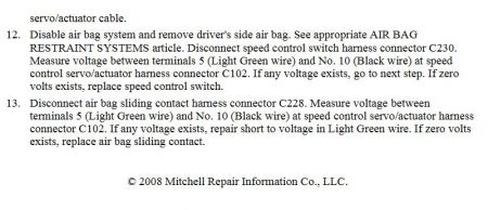

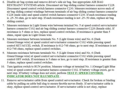

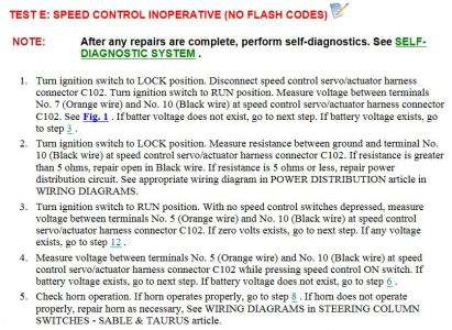

There seem to be some difference with the testing procedures for 99 models.
https://www.2carpros.com/forum/automotive_pictures/192750_CruiseTestE99Taurus01_1.jpg
https://www.2carpros.com/forum/automotive_pictures/192750_CruiseTestE99Taurus02_1.jpg
https://www.2carpros.com/forum/automotive_pictures/192750_CruiseTestE99Taurus03_1.jpg
Saturday, May 9th, 2009 AT 1:27 PM
