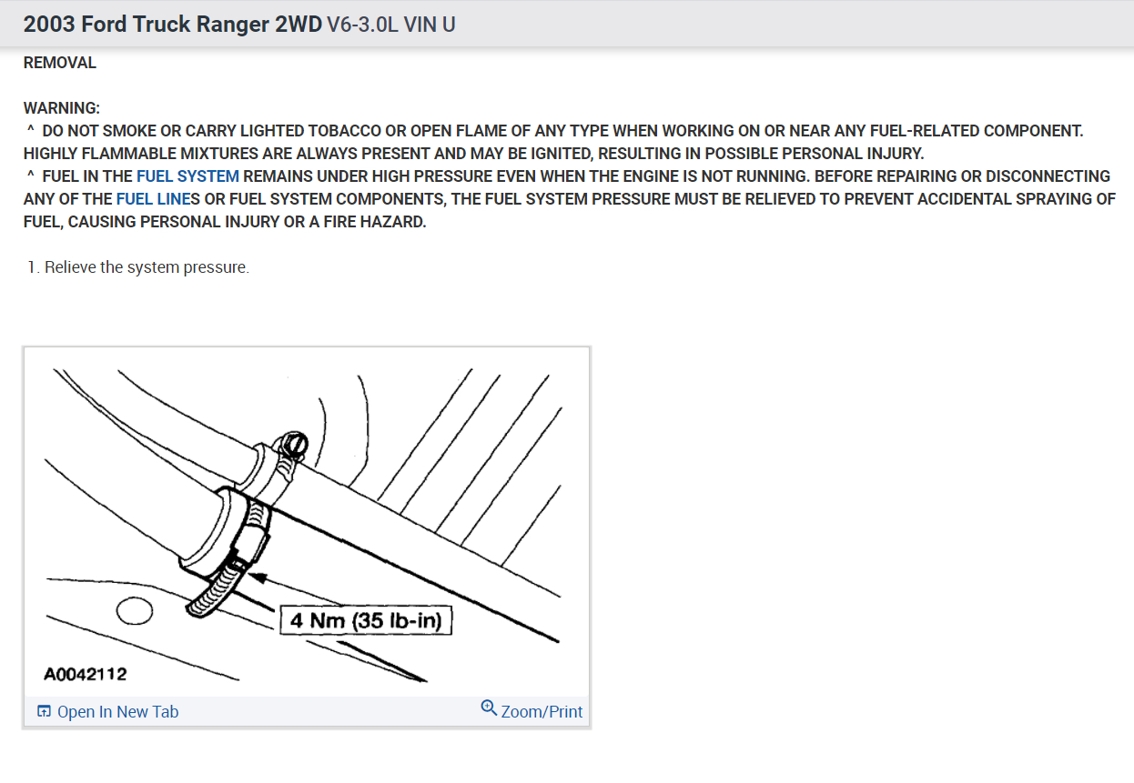

I have a 2003 2.3L Ford Ranger with only 50k miles and I am having (i believe to be a fuel delivery problem). I was driving fine around 65 to 70 mph on the highway..i then stopped, shut off engine, then about 5-10 minutes later went for a drive, once i shifted into 4th gear, the engine stopped responding to me, it was running, but the accelerator wouldn't do anything. as i down shifted i got no response.. (it felt like the engine completely bogged out) ( as if really overloaded.) i coasted into a parking lot and let it idle for a second...it seemed to gather itself, so i checked the fuel line connections to the filter (which i just replaced 2 days ago)..everything was connected fine. so i pulled out and headed down the road again...1st gear fine, second fine, 3rd fine, 4th gear...same thing happend, except this time i wasn't so lucky to let it coast and idle itself out. the truck died in the intersection and then wouldn't start. once i pushed it into a parking lot, i started testing the fuel pump.
I opened the gas cap, turned the key, and i heard the whirrling noise, (like the pump was activating properly) So, then i disconnected the gas lines into the fuel filter, and had a friend turn the key to see if the pump was indeed 'pumping' gas.
I got no response! the pump didn't spit out any gas!!

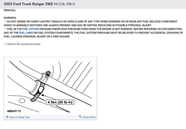

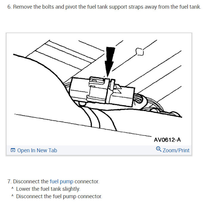

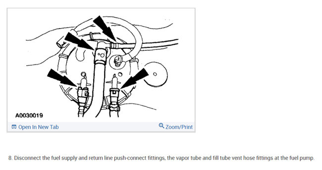

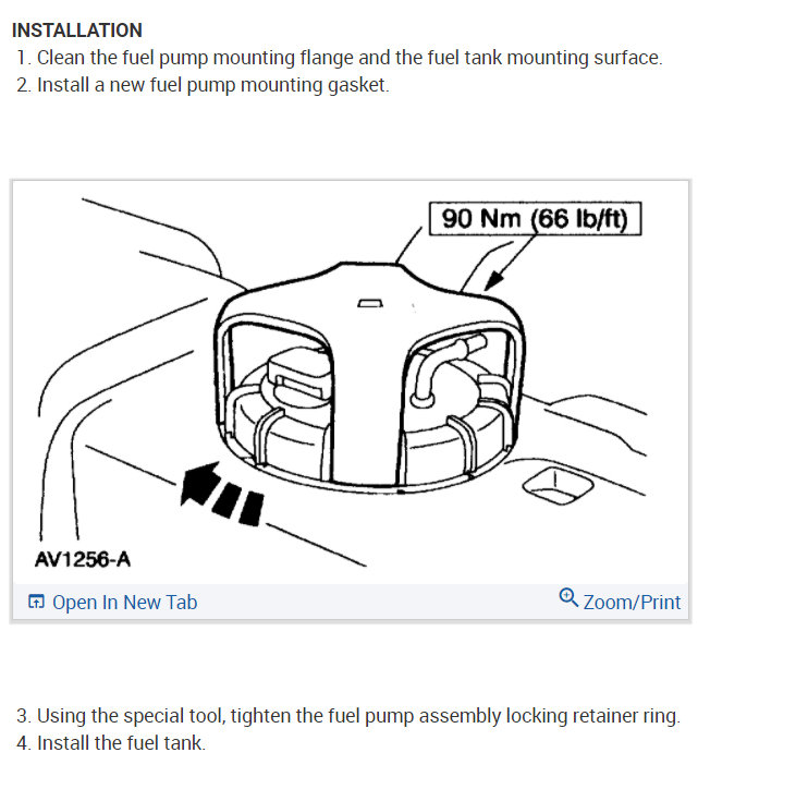

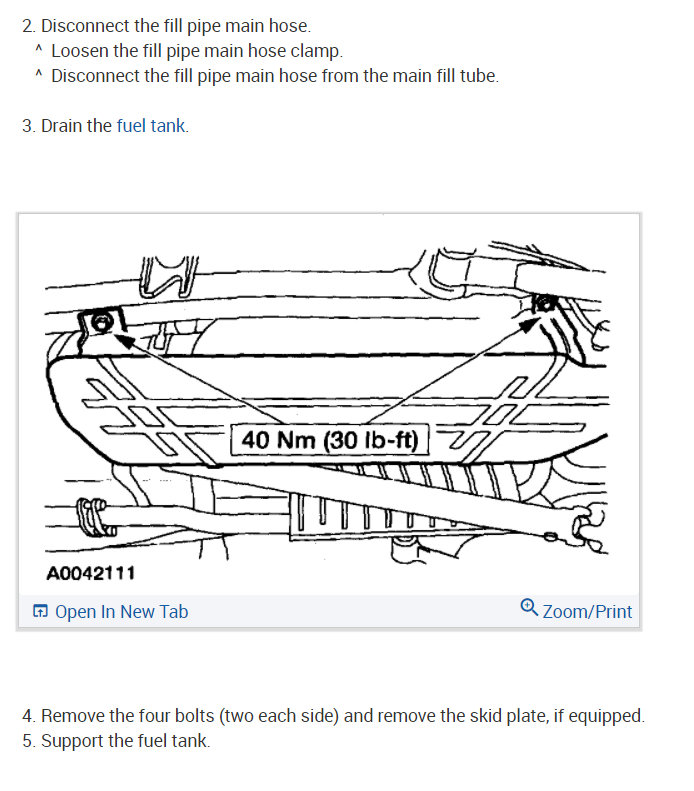

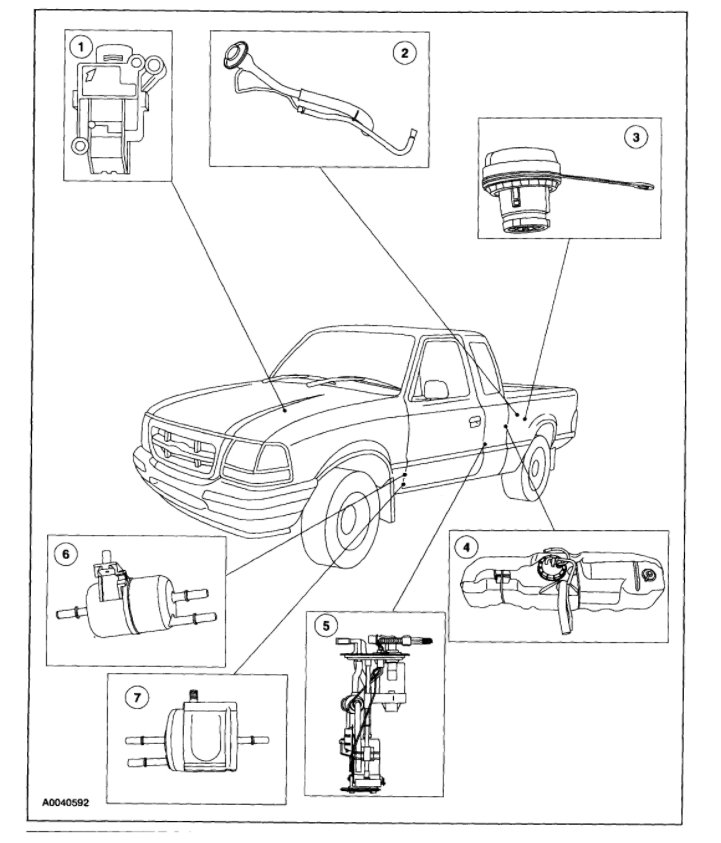

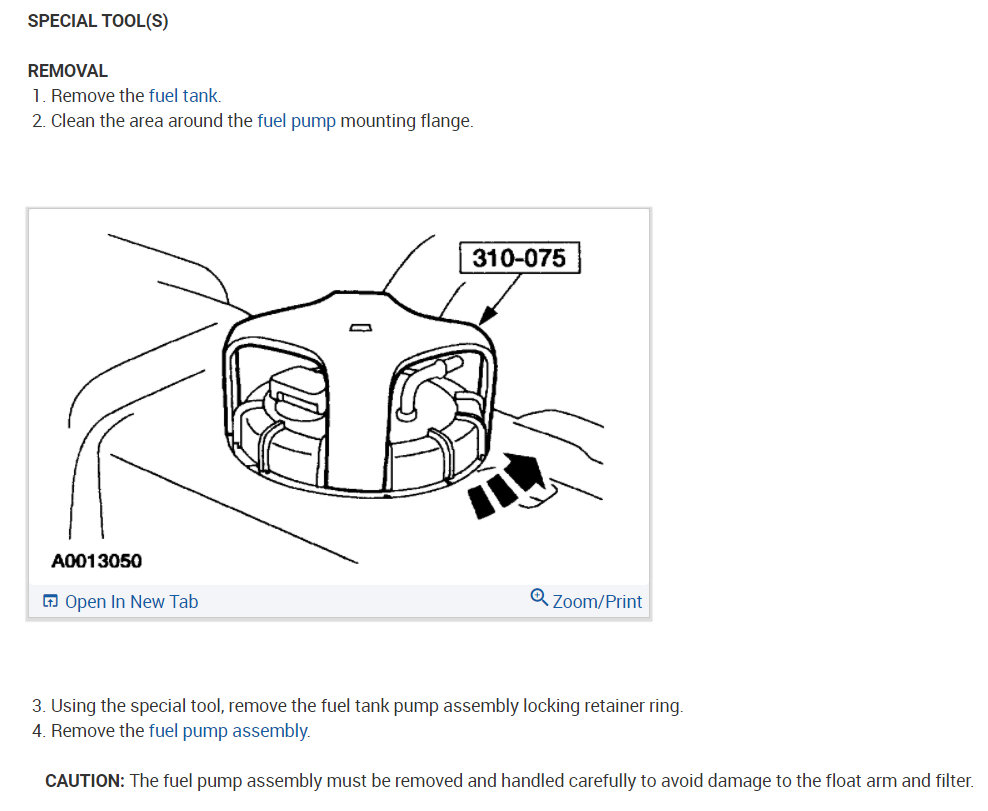

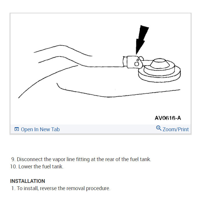

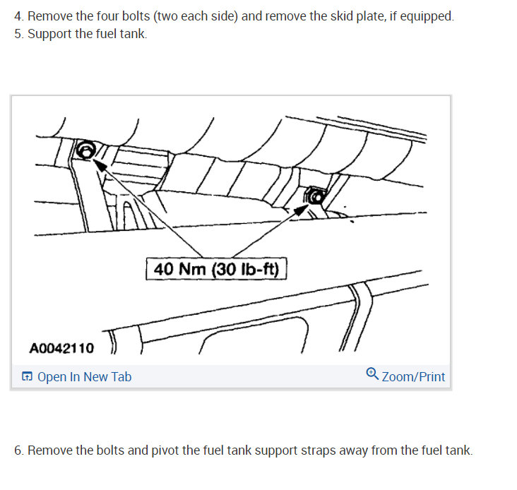

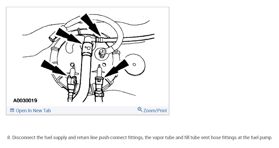

well if the filter was changed only a few days prior to all the trouble, Check to see if it is installed right, will only flow properly one way! This guide will show how to install the pump correctly.
https://www.2carpros.com/articles/how-to-replace-an-electric-fuel-pump

ok i found the problem, i have a late model 02 ranger, meaning made in nov. 02 but they call it an 03, Advance auto gave me a filter for a late model 03-04 model ranger. switched it out...runs like a dream

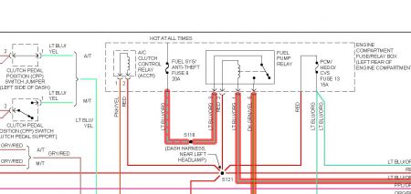

Check fuse no.9 20amp in the engine compartment fuse/relay box if okay I want you to identify the wiring color on the fuel pump relay socket if able to jumper the lite blue and orange wire to the dark green and yellow and tell me if the fuel pump come on.
https://images.2carpros.com/forum/automotive_pictures/12900_fuel_pump_relay_29.jpg
Nov 24, 2020 at 8:48 AM (Merged)
RICKBOB40
  • 9 POSTS
Yes ! the pump turns on............thanks
RICKBOB40
  • 9 POSTS
98 ranger. I did the jumper at relay socket 9. * Lt. blue\orange to Dk.green\yellow. w\relay on top of jumper,pump is on constant. *nothing w/out relay jumper only.*fuel pressure shut off non op. *w\ new relay,no jumper? no pump. >what next? Raz. ....Thanks much

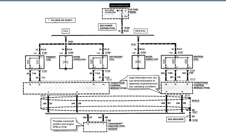

I recently changed the plugs, coil packs and wires to my ignition system and I’m now not getting any spark. I also have no fuel pressure. the fuel filter has been changed. the fuel pump does not prime when the truck is turned on but you can hear it running while it is cranking. I have tried to take the bed off to get a better look at the pump and cannot remove the two bed bolts near the cab. I don’t want to drop the tank do to the fact that I’m not skilled enough to do that. I’m a DYIer and I’m stumped. I just want my truck to run again. please help me figure this out.

Red wire on the fuel pump relay socket check for power turn on the key-should have power if not test the PCM relay-power present test the computer controlled circuit of the relay this is the one that grounds the relay

  • CAR REPAIR CONTRIBUTOR
Good afternoon,
If the fuel pump runs when cranking and not for the two second prime with the key on, that is an ECM fault.
Did you verify power to the coil packs? I will attach a wiring diagram for you to view to do the testing.
When you crank the engine, does the tachometer move up a little? that will tell us if the crank sensor is working.
Yes, you do have a separate computer it is called an engine control module or PCM. It controls the fuel mapping of the fuel system.
The red/light green wire for the coils is powered by the interior fuse box with the fuse listed in the diagram I sent you.
Did you verify power on both sides of the fuse with the key on?
Okay, again, did you test for power to each coil pack with the wire listed in the diagram? you need a voltmeter or test light.
It is the red/light green wire.
Yes, and I told you the wire was fed from the fuse box and check the fuse for power on both sides.
Check the diagram I posted way back.
