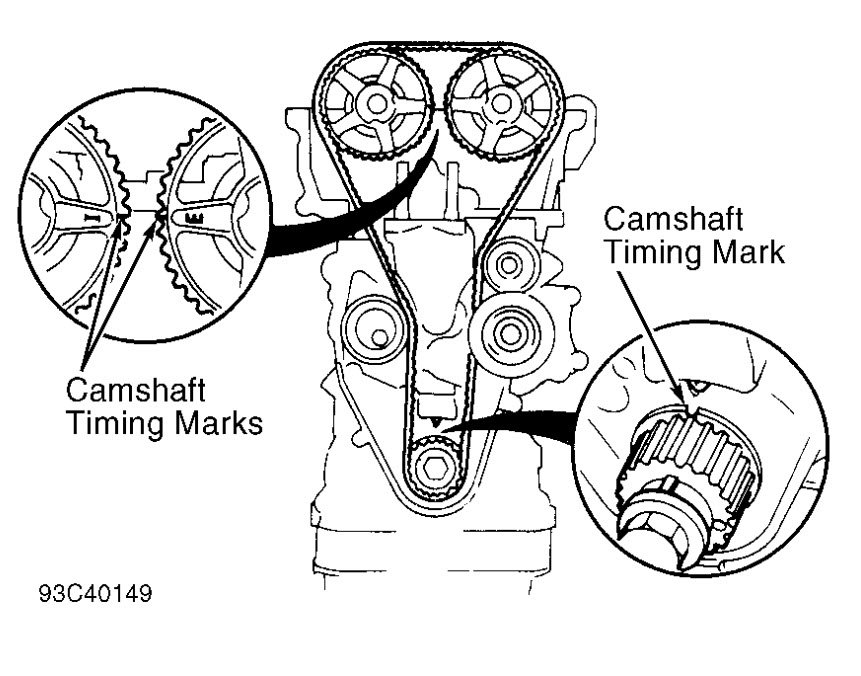

I recently replaced my water pump on my car, the timing belt got taken off and when I put it back on it ran like crap. So I took it off and tried timing it all marks are lined up but it won't fire. What am I doing wrong?

Double check all your alignment marks. Also, check to make sure the plug wires are in the correct order. I have attached pictures of both.

On my distributor cap is marked numbers differently than shown in the picture u gave me. Should I disreguard the numbers on the cap?
Sunday, November 13th, 2011 AT 5:58 PM
  • 108,269 POSTS
Only if you have changed them. The picture I sent is from a Mitchel service manual for the GT 2.5L. It should be correct, but. If the car ran the way it is now, you must be correct. Did the original timing belt break

I did everything you said all marks are alligned plug wires in the order illustrated in the picture still no fire

Okay. If you have spark and fuel, if the timing is correct, it should run unless the compression is low. When cranking, does the engine sound normal, turning too fast?
Sunday, November 13th, 2011 AT 7:12 PM
CHIGHFILL
  • 8 POSTS
It turns normal but sounds as if its out of time still
Sunday, November 13th, 2011 AT 7:14 PM
CHIGHFILL
  • 8 POSTS
I also noticed the rear mark is off roughly 4 teeth would that keep it from starting?
Sunday, November 13th, 2011 AT 7:15 PM
  • 108,269 POSTS
Yes, that will prevent it from starting. That needs aligned.

Replaced timing belt. Not sure which marks to line up on sprockets.

See pictures for align marks and instructions. Make sure to rotate twice and recheck after install. Do not turn engine over after removing belt.
