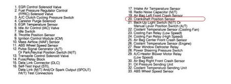

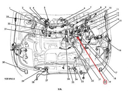

Where can I find the crankshaft pulley sensor and the connector where I can test resistance?

On lower left side of the engine for the 2.0 L
On the right front of engine for the 2.5L
Specify your engine size and I can provide picture of its location.

I have a 2.0 L, a picture would be fantastic, I've searched with no luck.
Monday, July 6th, 2009 AT 11:53 AM
BLUELIGHTNIN6
MECHANIC
16,542 POSTS
See if this helps...
