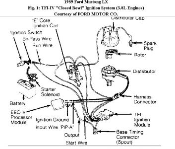

I dont have a scanner to put on it unfortunately but I'm thinking I need to stick a tester on the PIP maybe? I dont know much about a PIP so if you have any insight on that it would be appreciated also. I just know its a Profile Ignition Pickup but im not sure if it is a sensor or just a wire.
Monday, March 19th, 2007 AT 6:18 PM
SERVICE WRITER
  • 9,123 POSTS

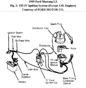

This is what I show for your car, the 3.8 has the pip as I see it.
https://www.2carpros.com/forum/automotive_pictures/30961_stang_1.jpg
https://www.2carpros.com/forum/automotive_pictures/30961_stang2_1.jpg
Monday, March 19th, 2007 AT 6:48 PM
BLACKSTANG
  • 8 POSTS
Yeah the 5.0 has it also. I guess I will buy a scanner tomorrow and run a test on it to see if that brings up any numbers. I am gonna put a voltage meter on the wires tomorrow and check the ones that come out of the ignition module.
