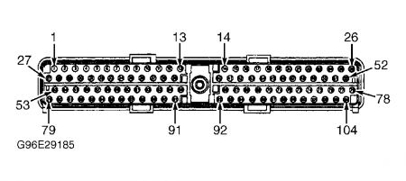

Ok good so far now I need you to do some test on the ignition module on the right front apron. All these tests are with key on engine off, Pin 8 the red wire make sure there is power to it.
I also need you to test the PCM for power too, with you digital volt meter with key on engine off check for power between pin 71 and 97. Let me know what you find and we will take it from there ok. Here is a pic of the PCM connector.
https://www.2carpros.com/forum/automotive_pictures/249564_Graphic_19.jpg
If all this is ok then we need to check the cam sensor under the coil pack this is what initiates firing order and spark.

I am getting 0.12 as the reading on the pcm harness.
I am getting 12 volts on pin 8 of the ignition control module harness

I tested further and it turns out that there is NO voltage at the PCM. What do I do now?
Saturday, December 27th, 2008 AT 6:19 PM
RACEFAN966
  • 5,029 POSTS
I am thinking if the power wire is good then it may be the pcm power relay. This is built into the Constant Control Relay Module. It is mounted on a braket behind the engine coolant reservoir. Check to make sure it didn't get unpluged when you did the heads and check for any damaged wire to it. Let me know how it goes and take it from there.
